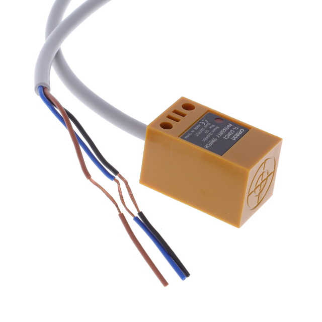

Inspect the Prox Sensors and their connections
Reason: A sensor is defective or disconnected.
  1. From the PathPilot interface, on the Status tab, examine the axes' Limits LEDs.
    1. If one or more of the status lights are illuminated, try Disable the Limit Switches (Stuck on a Limit Switch) first.
    2. If all of the status lights are off, continue to the next step.
  2. Locate the physical switches on the machine and manually trip them with a metal object while watching the LEDs in PathPilot.
