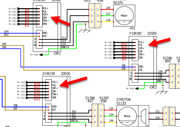

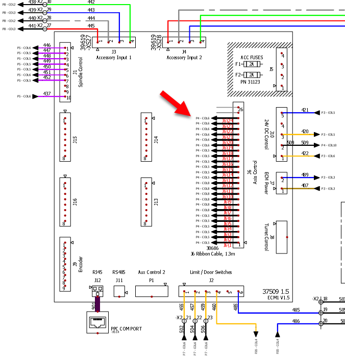

24R Axis Drivers
24R ECM Board
  1. Examine the power and control cables at the DC-Bus and the stepper driver controllers removing, inspecting, and re-connecting them to ensure they are seated.
      1. 203/204 (X-axis)
      2. 205/206 (Y-axis)
      3. 207/208 (Z-axis)
  2. If there is any discoloration, replace the cable and driver.
  3. Continue to the next troubleshooting topic.

Inspect the Motor
Reason: There's a defective motor or motor connection.
  1. Power off the machine.
  2. Disconnect the motor lead quick connect, and examine the motor side wiring for signs of coolant or contamination.
  3. Based off of the chart, measure the resistance of windings at the motor quick connect.

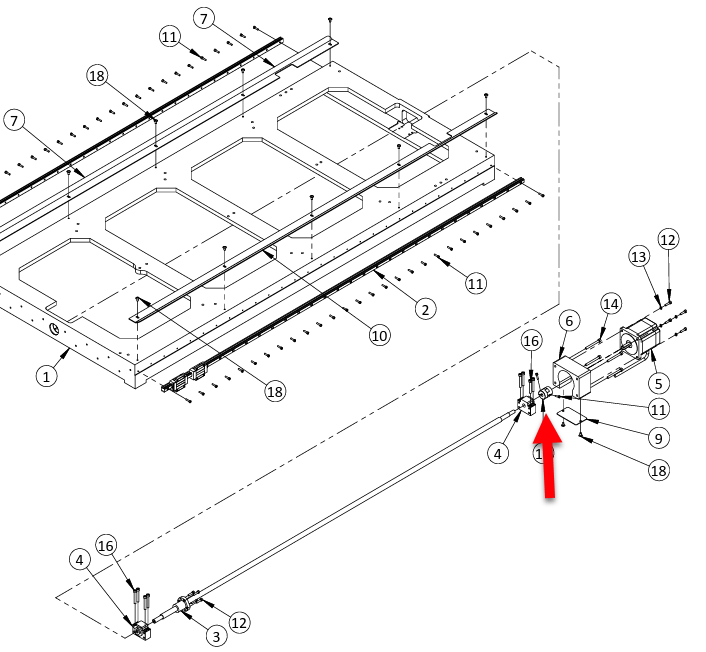

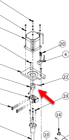

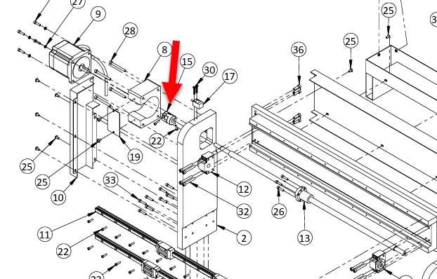

Inspect the Motor Coupling
    1. If the coupling is slipping, locate the hex screws and tighten them down
24R Z Axis Coupler
24R X Axis Coupler
24R Y Axis Coupler
