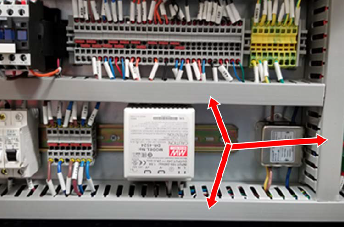

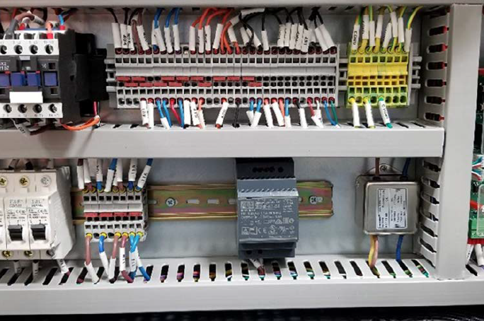

  2. From the electrical cabinet, remove the three wire trough covers shown in the following image. Set the wire trough covers aside.
Figure 1: Wire troughs to remove from the electrical cabinet.

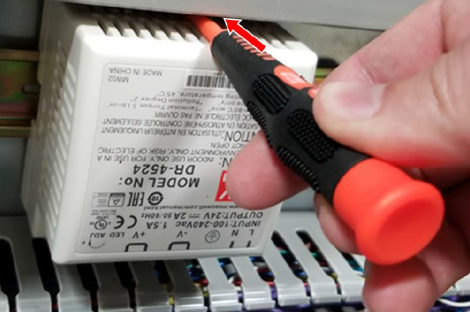

  1. Identify the existing power supply. Depending on which machine you have, the power supply is either white or gray (as shown in the following images). Lift the DIN rail clip on the power supply with a small, flat-blade screwdriver to remove it from the electrical cabinet.
Figure 2: Existing power supply attached to the DIN rail.

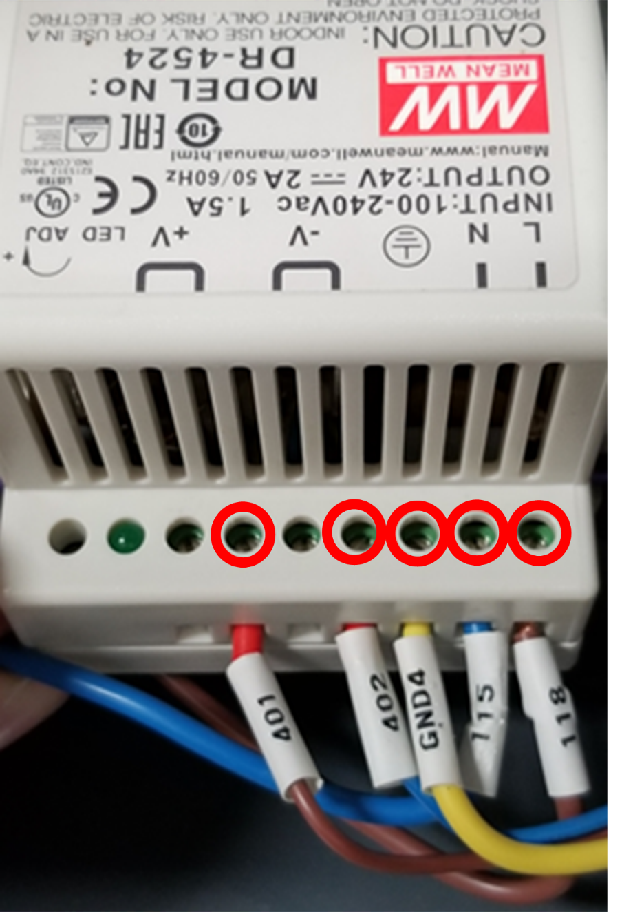

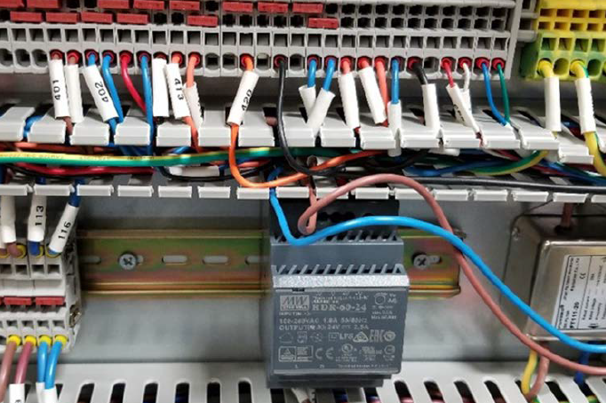

  1. Remove the wires from the existing power supply terminals with a small, flat blade screwdriver.
Figure 3: Wires to remove from the existing power supply.

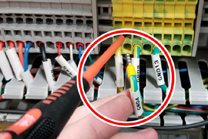

  1. Depending on which power supply you have, do one of the following:
  1. In the electrical cabinet, on the ground terminal strip, identify the GND 4 wire. Then, remove it with a small, flat-blade screwdriver. You can discard the ground wire.
Figure 4: Ground wire in the electrical cabinet.

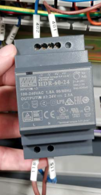

Install the Replacement Power Supply
  1. Make the wire connections on the replacement power supply:
    1. Connect wire 118 (brown) to the L terminal on the new power supply.
    2. Connect wire 115 (blue) to the N terminal on the new power supply.
    3. Connect wire 401 (brown) to one of the V+ terminals on the new power supply.
    4. Connect wire 402 (blue) to one of the V- terminals on the new power supply.
Figure 5: Wire connections made on the replacement power supply.

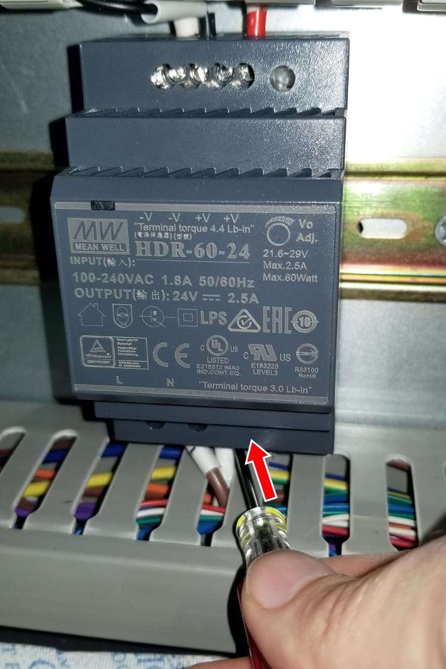

  1. In the electrical cabinet, hold the power supply's DIN rail clip open, and mount the replacement power supply to the DIN rail.
Figure 6: Replacement power supply mounted on the DIN rail.
  1. Tuck the power supply's wires into the wire troughs and re-install the wire trough covers that you set aside earlier.
Figure 7: Wire troughs re-installed.
