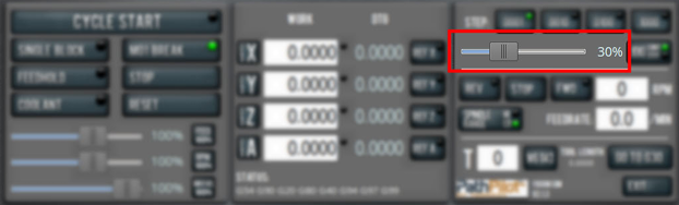

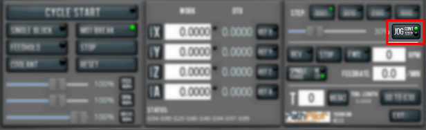

Jog the Machine
Figure 3: Jog button.
Figure 4: Jog Speed slider.
Figure 5: Step buttons (in G20 mode).
About Jogging
Jog the machine using the keyboard, the optional Jog Shuttle or Operator Console Pendant. Whichever device you're jogging with, you can either:
  • A keyboard key is pressed
  • The Operator Console Pendent wheel is turned in the desired direction.
  • Moving the machine a certain distance at a constant speed.
About Step Jogging
While jogging in step mode, the machine moves one step each time you either press a jog key on the keyboard, click the inner wheel of the Jog Shuttle, or rotate the Console Pendant one click. The jog step sizes range depending on the programming mode you are using:
  • Imperial (G20) Mode 0.00025 in. to 0.1000 in.
  • Metric (G21) Mode 0.010 mm to 2.00 mm

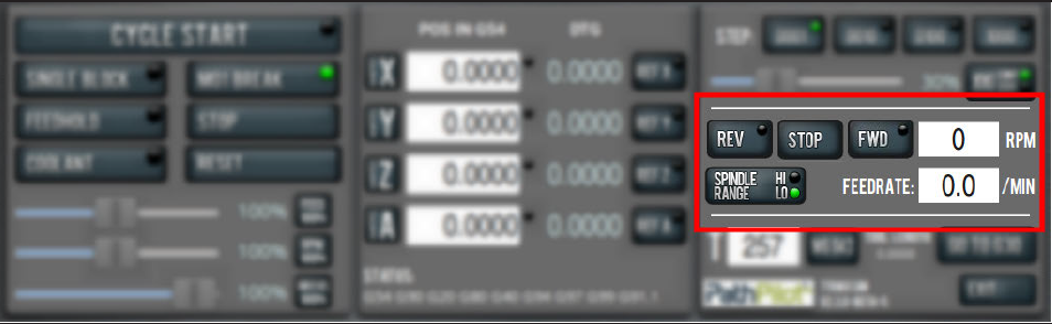

Manually Control the Spindle
  2. From the PathPilot interface, in the Manual Control area, locate the Spindle group.
Figure 6: Spindle group.
  1. In the RPM DRO field, type the desired RPM speed. Then select the Enter key.
  2. Select FWD to start the spindle in the forward direction.
  3. Select Stop to stop the spindle.

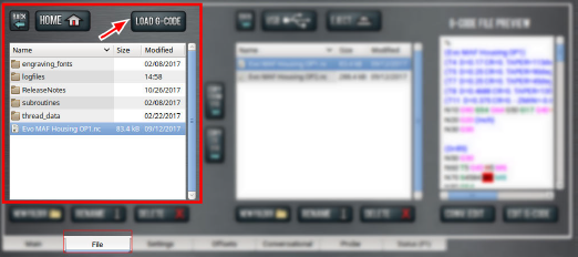

Load G-Code
To run a G-code program on a PathPilot controller, you must first verify that the file is on the controller. For more information on transferring and moving files, see Transfer Files to and From the Controller.
To load G-code:
  2. Select Load G-Code.
Figure 7: Controller Files window on the File tab.

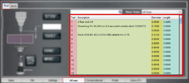

Set Tool Length Offsets
NOTE: You can import a .csv file with tool length offset data. For information, see Import and Export the Tool Table.
To set tool length offsets:
Figure 10: Tool Table window on the Offsets tab.
About Tool Offsets
The tool length offset is the distance from the tip of the tool to the spindle nose. Because the ER20 collet spindle doesn't provide a repeatable tool length, the tool length must be measured every time that you remove a tool from the spindle. To speed up tool changes, we recommend using an Electronic Tool Setter (PN 31875) when measuring tool lengths.

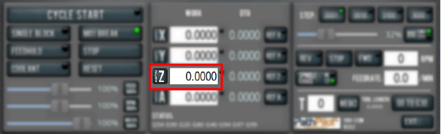

Set a Known Reference Height
  7. While moving the paper back-and-forth across the reference surface, slowly step the Z-axis down (-Z) until you feel a light pull on the piece of paper. This indicates that the paper is contacting the spindle.
Figure 11: Z-axis work offset DRO field.

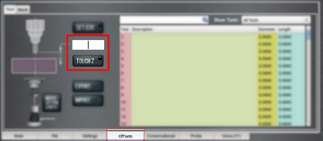

This procedure sets the tool length offset using a known reference height. If you have not yet done so, you must first set the Z zero position; go to Set a Known Reference Height.
Figure 12: Tool DRO field.
Figure 13: Touch Z DRO field and button.
  1. Select Touch Z.
  4. Jog the Z-axis up (+Z).

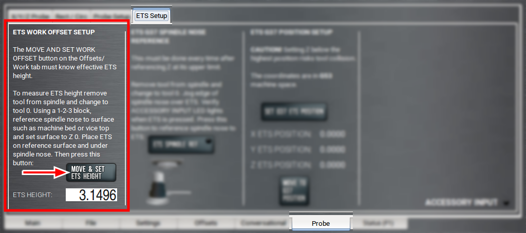

Set up the Electronic Tool Setter (ETS)
Set the ETS Height
To set the ETS height:
    For information, see “Set a Known Reference Height”.
Figure 14: Move & Set ETS Height button on the Probe tab.

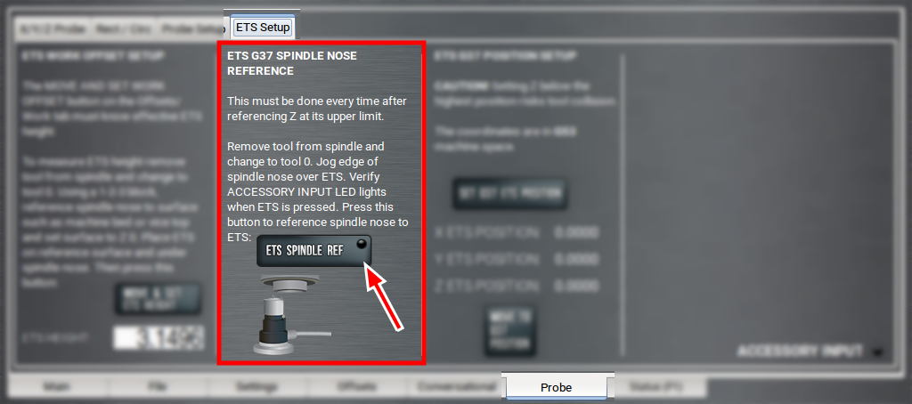

Reference the Spindle Nose
Tip! We recommend putting the ETS toward the Y+ end of travel (where it's outside of the 2 ft × 4 ft standard work envelope, and on the surface of the vacuum table). For information, see ETS Placement Layout.
  1. Remove the collet nut and the tool from the spindle.
  3. Jog the spindle until it's over the ETS. Then, slowly jog the Z-axis down (-Z) toward the contact pad on the ETS.
  4. From the PathPilot interface, on the ETS Setup tab, find the ETS G37 Spindle Nose Reference section, and select ETS Spindle Ref.
Figure 15: ETS Spindle Ref button on the Probe tab.

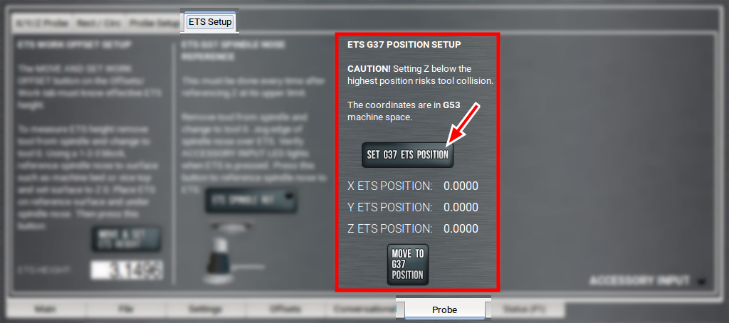

Set the G37 Position
Figure 16: Set G37 ETS Position on the Probe tab.
The G37 position is now set.

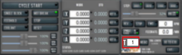

  7. From the PathPilot interface, type the tool number in the Tool DRO field. Then select the Enter key.
Figure 17: Tool DRO field.

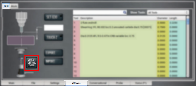

  1. On the Offsets tab, find the Move and Set Tool Length button and the Z only checkbox. Verify that the checkbox is cleared, and then select Move and Set Tool Length.
Figure 18: Tool tab on the Offsets tab.
NOTE: You should only use the Z only checkbox to manually measure tools with a larger diameter. When it's selected, the machine doesn't go to the G37 position — instead, it just moves straight down (Z-) to measure the tool.
The machine moves to the G37 position and measures the tool with the ETS.

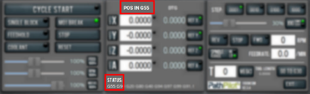

Set Work Offsets
  • Select Zero [Axis].
Figure 19: Work Offset DRO fields.
To change work offsets:
Figure 20: Work offset indicated in the PathPilot interface.

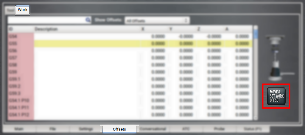

  4. Put the ETS on the surface that you want to set as Z zero.
  5. Jog the spindle until the tool is centered over the ETS.
  6. From the PathPilot interface, on the Offsets tab, on the Work tab, select Move and Set Work Offset.
Figure 21: Work tab on the Offsets tab.
The machine moves down (-Z) until the tool contacts the ETS. The Z-axis offset updates for the current work offset.
