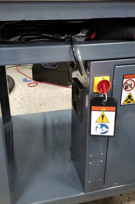

  2. Find the Main Disconnect switch, and then remove the hang tag.
Figure 1: The Main Disconnect switch on the side of the machine's electrical cabinet.

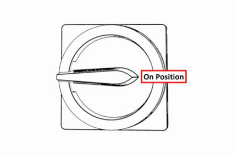

  1. Turn the Main Disconnect switch to ON.
Figure 2: Example of the Main Disconnect switch in the On position.
Mains power is now connected to the machine.

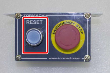

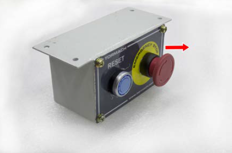

  2. Rotate the Emergency Stop button one-quarter turn clockwise to release it.
Figure 3: Emergency Stop button.
  1. Push the blue Reset button to enable the machine.
Figure 4: Reset button.
The axis drives are now powered on.

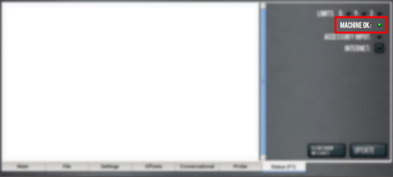

  1. Verify that the blue Reset LED comes on. From the PathPilot interface, on the Status tab, verify that the Machine OK light changes from yellow to green.
    Once both are on, the machine is powered on and ready to operate.
Figure 5: Machine OK light on the Status tab.

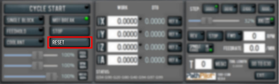

  1. Select Reset.
Figure 6: Reset Button
This initializes the connection between the machine and controller.

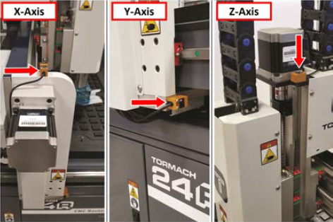

  1. On the machine, identify the X, Y, and Z limit switches.
Figure 8: Machine limit switches.
  1. Hold a piece of steel (like a screwdriver or a wrench) up to each limit switch.
    The red light on each limit switch is on until the steel is within sensing range, at which point the red light dims or turns off.
    From the PathPilot interface, on the Status tab, the corresponding X Limit, Y Limit, and Z Limit lights come on.

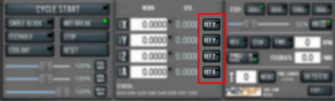

  3. Reference the axes: from the PathPilot interface, select Ref Z, Ref X and Ref Y.
Figure 9: Ref Z, Ref X, and Ref Y buttons.
The machine moves to the reference position.

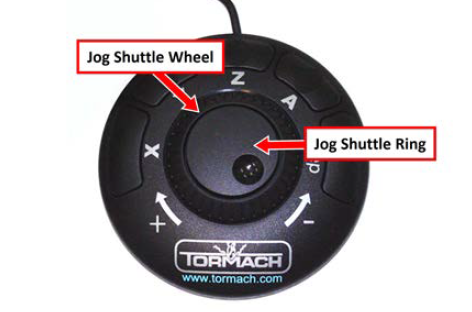

  1. If applicable, verify the optional Jog Shuttle:
  • Press any axis button on the Jog Shuttle — X, Y, Z, or A — to select an axis.
Figure 10: Functions on the optional Jog Shuttle.
From the PathPilot interface, on the Main tab, the corresponding green Axis light comes on.
Figure 11: Axis lights.
  • Turn the Jog Shuttle Ring in any direction to move the selected axis, then turn it in the opposite direction to reverse the direction.

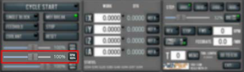

  3. From the PathPilot interface, confirm that the Spindle Override slider isn't set to 0% (when it's set to 0%, the slider is yellow). To clear the override, select RPM 100%.
Figure 12: Spindle Override slider.
NOTE: The Spindle Override slider changes the programmed spindle speed by a specific percentage. If it's set to 0%, the spindle won't move during the following steps in this procedure. For information, see “About Spindle Override”.

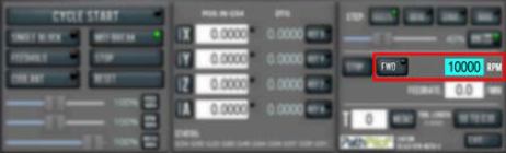

  1. From the PathPilot interface, in the RPM DRO field, type 10,000. Then select the Enter key.
  2. Select FWD.
Figure 13: Spindle controls.
The spindle rotates clockwise (viewed from above) at 10,000 rpm.

  1. Push the Emergency Stop button to lock it into the disabled position.
Figure 14: Emergency Stop button.
With the Emergency Stop button in the disabled position all motion and spindle function stops, the Reset button is disabled , and the blue Reset LED goes off. From the PathPilot interface, on the Status tab, the Machine OK light illuminates yellow.
