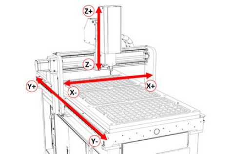

Axes
The machine has three linear axes of motion used for machining:
  • The X-axis, which is (horizontally) along the width of the gantry.
  • The Y-axis, which is (horizontally) along the length of the machine table.
  • The Z-axis, which is (vertically) along the Z-axis linear rail plate.
Figure 1: Axes directions on the machine.
Each axis has a different limit of travel, which is the distance it moves from its reference position (G53) before reaching a soft limit:
  • X-Axis 24.75" (628 mm)
  • Y-Axis 55.75" (1416 mm)
  • Z-Axis 6.7" (170 mm)

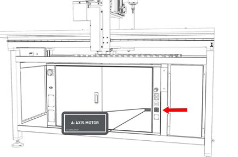

  • A-Axis Motor Connector On the front right end of the electrical cabinet.
Figure 2: A-axis motor connector on the machine.
The A-axis motor connector is used to connect to a rotary 4th axis (used for indexing or continuous 4th axis machining).

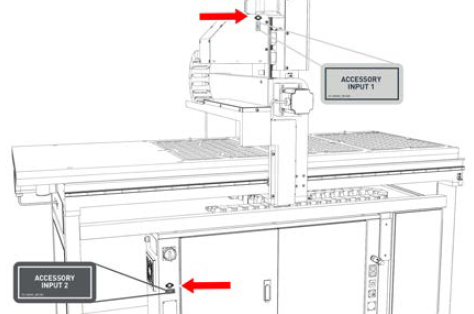

  • Accessory Input (2x)
    • Accessory Input 1 On the operator side of the rear Z-axis cover.
    • Accessory Input 2 Below the Main Disconnect switch on the electrical cabinet.
Figure 3: Accessory input ports on the machine.
The two accessory inputs are used to connect accessories (like probes, tool setters, and tool touch plates) to the machine.

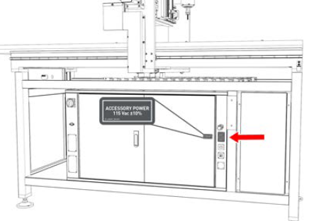

  • Accessory Power Port (2x) On the front right end of the electrical cabinet.
Figure 4: Accessory power ports on the machine.
The two IEC-320 accessory power ports are used to supply power to peripheral accessories (like the PathPilot controller and monitor). These outlets output 115 Vac ±10%.

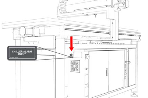

  • Chiller Alarm Input On the side of the left end of the electrical cabinet.
Figure 5: Chiller alarm input on the machine.
The chiller alarm input connects the alarm status feedback from the spindle chiller to the machine control system. This feedback allows the machine control system to stop the spindle from running while the chiller isn't working.

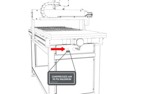

  • Compressed Air Line At the back end of the machine underneath the phenolic table.
Figure 6: Compressed air line on the machine.
The compressed air line is used to supply accessories and components with compressed air.

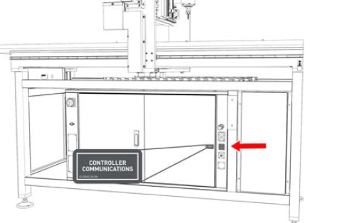

  • Controller Communications Port On the front right end of the electrical cabinet.
Figure 7: Controller communications port on the machine.
The controller communications port is used to connect the PathPilot controller to the machine. The controller communications port (and the cable that connects to it) sends all communication between the PathPilot interface and the machine.

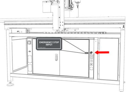

  • Emergency Stop Input On the front right end of the electrical cabinet.
Figure 8: Emergency stop input on the machine.
