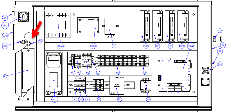

Reset the brake resistor’s thermal switch
Reason: The thermal switch tripped and needs to be reset.
  1. Reset the thermal switch (TS1) as follows:
    1. Power off the machine.
    2. Allow the brake resistor to cool.
    3. Press the reset button (between the thermal switch’s two terminals) to reset the thermal switch.
Thermal Switch Location 24R
