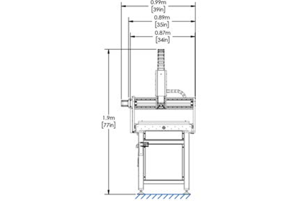

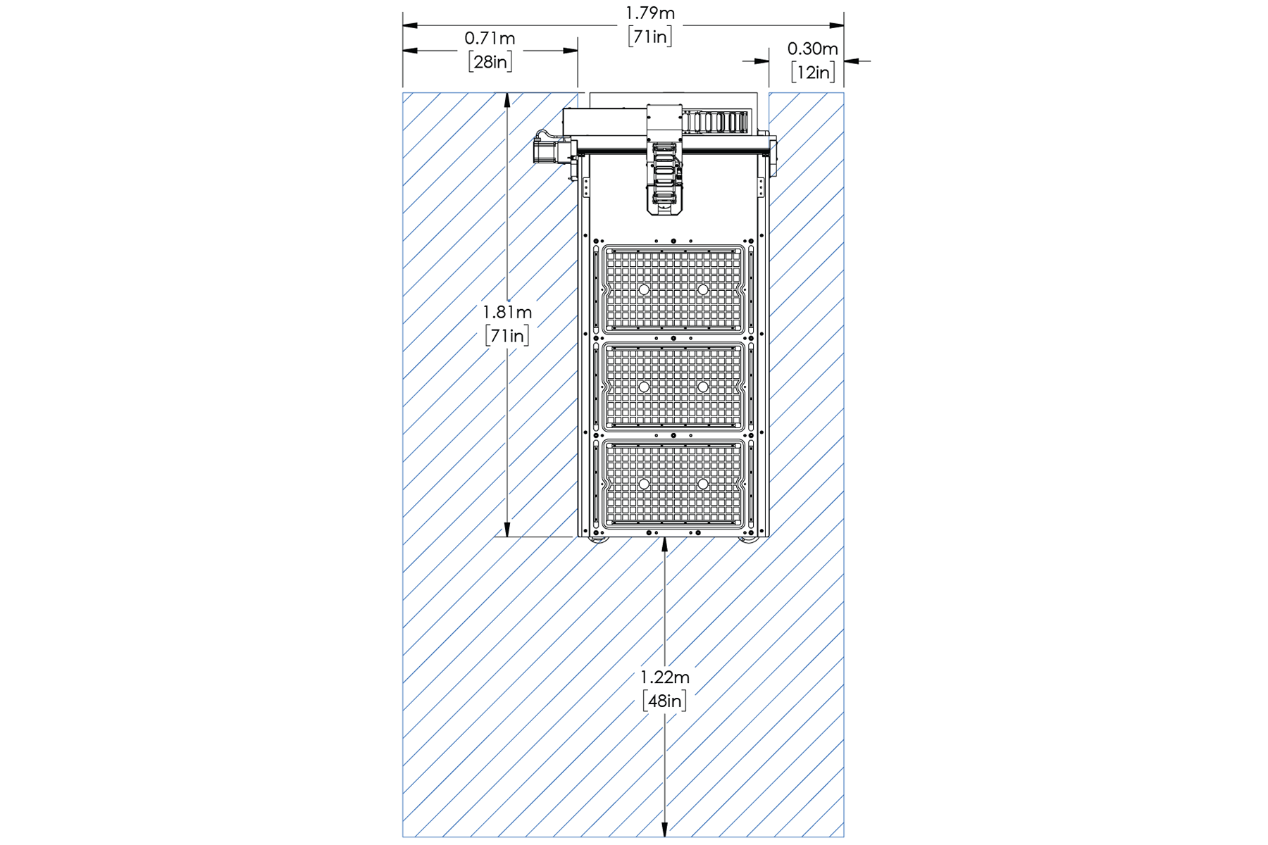

Space Requirements
The area must meet the following space requirements. Allow more space to access the rear of the machine for maintenance and repairs.
  • Machine Size 71" × 39" (1.8 m × 1 m)
  • Machine Height 77" (1.9 m)
  • Typical System Footprint 119" ×71" (3 m × 1.8 m)
Figure 1: Dimensions of the machine and it's required added space, as viewed from above.

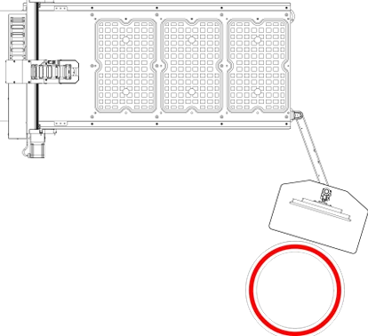

Operator Workstation Reference
The typical operator workstation is the area in front of the PathPilot controller, as shown in the following image.
Figure 2: Example of the typical operator workstation.
For information on the machine controls, go to “System Basics”.
