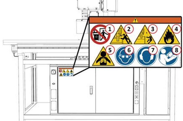

Next to the Main Disconnect
  1. Don't Operate Unattended. Never allow the machine to run unattended. The machine's spinning tool generates friction and heat — chips, dust, or materials can start on fire. Before operating the machine in any way, you must verify that you're using the correct tools for the material. During operations, you must be prepared to stop the cut if something seems incorrect or unsafe.
  2. WARNING! Entanglement / Entrapment Hazard. The machine operates under automatic control — it can start at any time and crush, cut, entangle, or pinch body parts. Always keep clear of positions on the machine where unexpected or unintended machine motion could cause harm. Before operating this machine in any way, you must verify that all operators know the location of the machine's Emergency Stop button.
  3. WARNING! Ejection Hazard. Fixtures, tooling, workpieces, or other loose items can become dangerous projectiles and can cause death or serious injury. Before operating this machine in any way, you must verify that you have appropriately secured all components.
  4. WARNING! Fire Hazard. The machine is not designed to contain fire or explosions. Only use materials and coolants that are intended for the specific machining operation. Never use flammable or explosive items. Before operating the machine in any way, you must read all Safety Data Sheets (SDSs) for any workpiece materials, coatings, coolants, lubricants, and other consumables used.
  5. WARNING! Inhalation Hazard. The machine does not protect you from airborne particulates. Chips, dust, and vapors from certain materials can be toxic or otherwise harmful. Before operating the machine in any way, you must read all Safety Data Sheets (SDSs) for any workpiece materials, coatings, coolants, lubricants, and other consumables used.
  6. Personal Protective Equipment: Eyes. Prevent injury by always wearing protective safety eyewear. Before operating this machine in any way, you must verify that your eyewear is impact-resistant and rated for ANSI 787+.
  7. Personal Protective Equipment: Ears. Prevent injury by always wearing ear protection when you expect the machine or the machining processes to exceed safe exposure limits.
  8. Operator Knowledge. Before operating this machine in any way, you and all other operators must read and understand all instructions. If you don't, there's a risk of voided warranty, property damage, serious injury, or death.

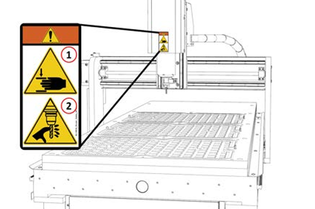

On the Spindle Head
Figure 3: Example of a safety decal on the spindle nose.
  1. WARNING! Crush Hazard. Moving parts can entangle, pinch, or cut you, causing death or serious injury. Before operating this machine in any way, you must verify that all body parts, long hair, and clothes are clear of the machine's extent of motion.
  2. WARNING! Cut Hazard. Tools and swarf can cut you. Only hold tools by the tool holder. Before inserting or removing tools from the machine, you must verify that all motion is completely stopped.

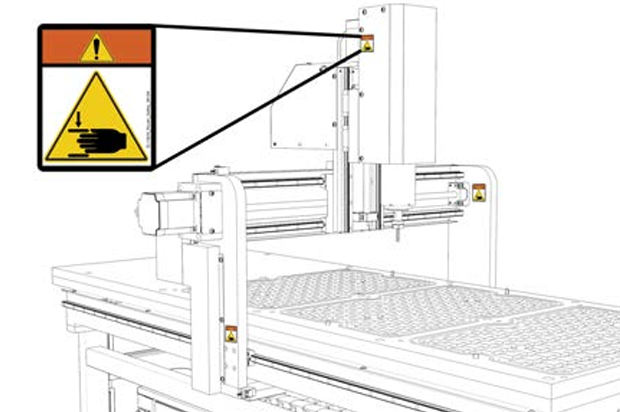

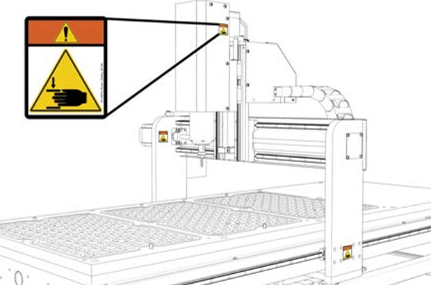

On the Gantry and the Spindle Head
Figure 4: Example of safety decals on the spindle head.
Figure 5: Example of safety decals on the left side of the machine.

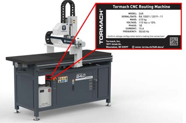

Serial Number Plate
Figure 6: Example of the serial number plate on the side of the electrical cabinet.
