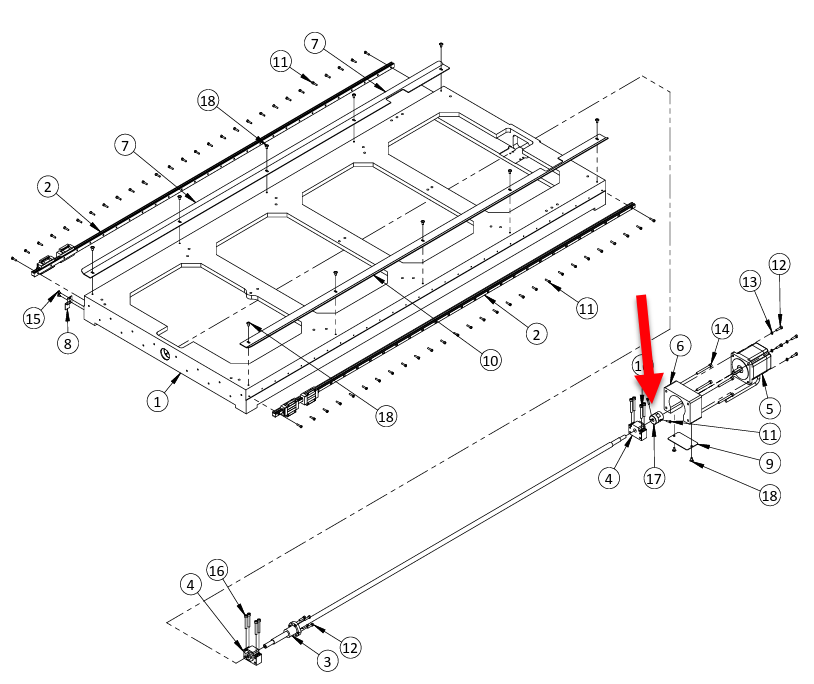

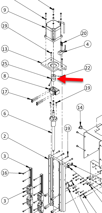

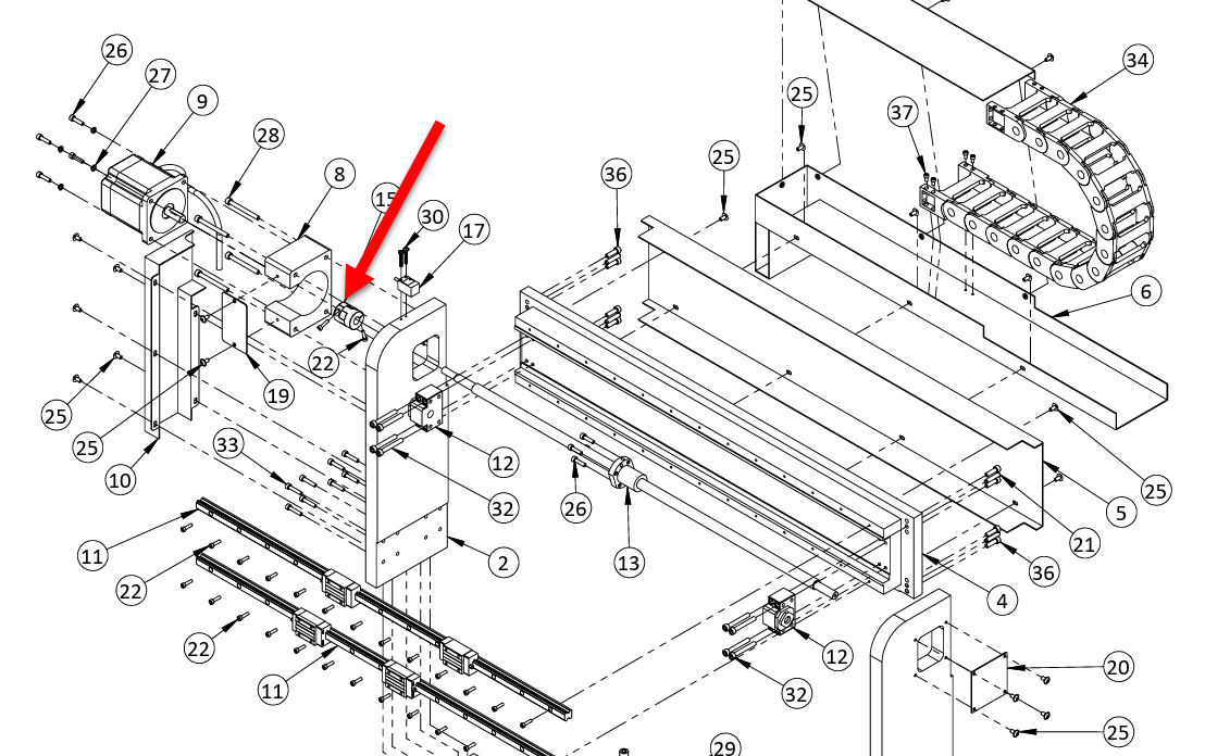

Examine the motor coupling
Reason: The motor coupling is loose or cracked
A loose or cracked coupler can allow the ball screw to spin in the coupler freely.
X-Axis Coupler
