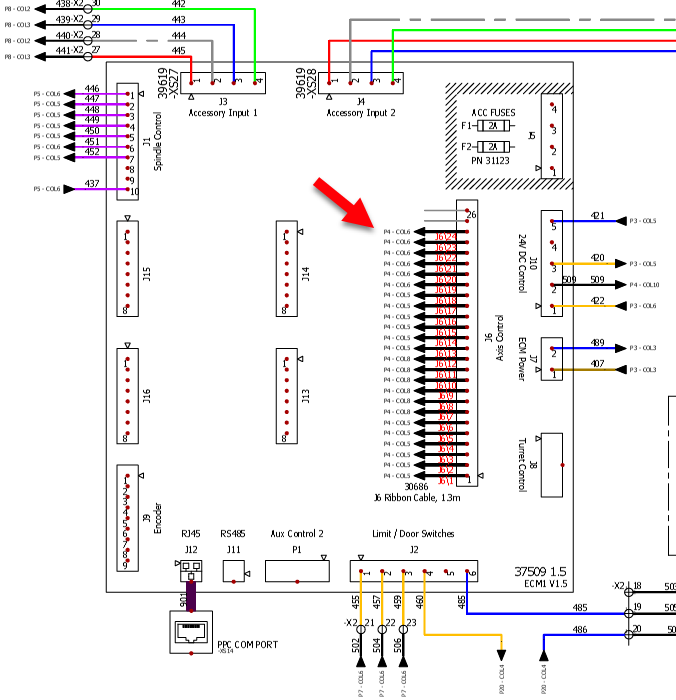

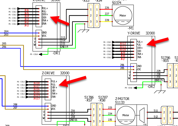

  1. Examine the power and control cables at the DC-Bus and the stepper driver controllers removing, inspecting, and re-connecting them to ensure they are seated.
      1. 203/204 (X-axis)
      2. 205/206 (Y-axis)
      3. 207/208 (Z-axis)
  2. If there is any discoloration, replace the cable and driver.
  3. Continue to the next troubleshooting topic.
Inspect the Stepper Driver Controller
Reason: There's a defective axis driver module.
  1. See One Axis Won't Move (or Only Moves in One Direction), and Other Axes Move - 24R.

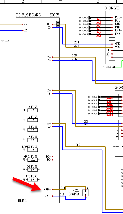

Inspect the DC-BUS Capacitor (C1)
Reason: The C1 (DC-BUS) capacitor is defective.
  1. Power off the machine. Then, unplug the green power connectors on all of the axis drivers (X, Y, Z, and A).
  2. With the electrical cabinet door open, power on the machine.
  3. Examine the green LED on the DC-BUS board, and then twist out the Emergency Stop button and press the Reset button. The green LED should come on.
  4. Push in the Emergency Stop button.
    1. If the LED goes out in two seconds or less, the capacitor is defective and must be replaced. If the LED takes five seconds or more to go out, the capacitor is OK.
  5. If the results are not conclusive, power off the machine. Then, unplug the green power connectors from the axis drivers (if they're not already unplugged).
  6. Power on the machine). Then, carefully measure DC voltage on wires 212 (common) and 211 on the DC-BUS board.
    1. If there's a DC voltage of a nominal 65 Vdc (55-75), this indicates the capacitor is OK.
    2. If there's a DC voltage of a nominal 40 Vdc (35-45), this indicates the capacitor is defective.

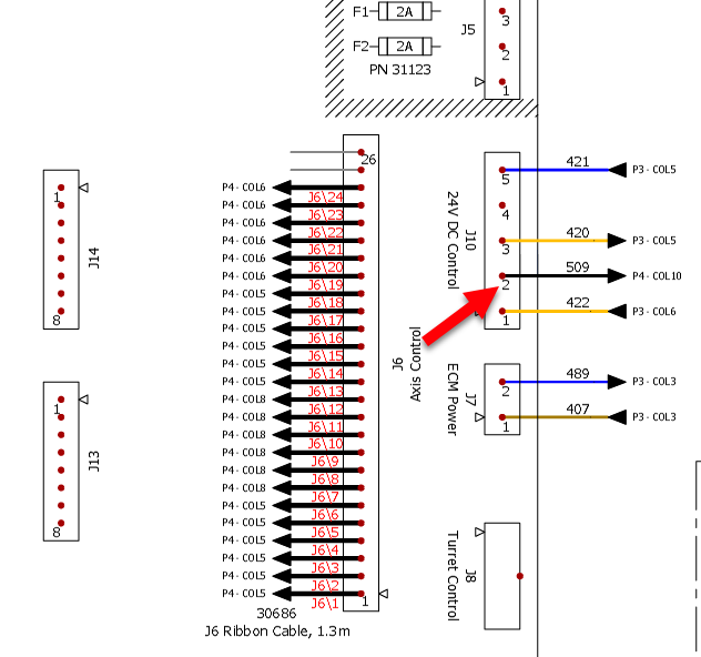

Inspect the Axis Brake (if installed)
Reason: The axis brake is failing.

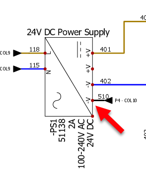

  1. With a multimeter, check for 24Vdc between wires 509 and 510 on the ECM board and 24V Power Supply.
  2. If 24 Vdc is not present, the relay on the ECM board has failed and the ECM board needs to be replaced. If 24 Vdc is present, the brake has failed and needs to be replaced.
Wire 509 on ECM Board
Wire 510 on DC Power Supply
