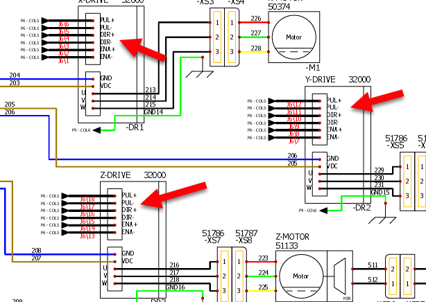

Your machine axes require power and control signals to work. If either of those are disrupted you can lose any or all of your axes motion. If only one motor is not working go to, One Axis Won't Move (or Only Moves in One Direction), and Other Axes Move - 24R .

24R Axis Drivers

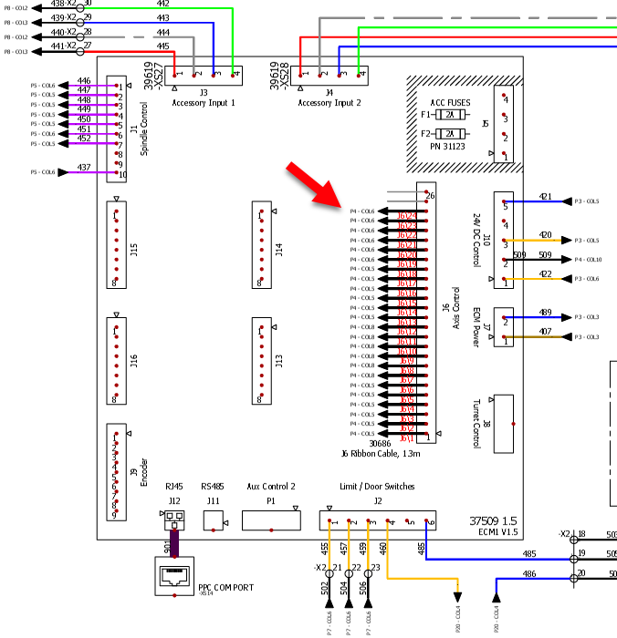

24R ECM Board
  1. Examine the power and control cables at the DC-Bus and the stepper driver controllers removing, inspecting, and re-connecting them to ensure they are seated.
      1. 203/204 (X-axis)
      2. 205/206 (Y-axis)
      3. 207/208 (Z-axis)
  2. If there is any discoloration, replace the cable and driver.
  3. Continue to the next troubleshooting topic.
