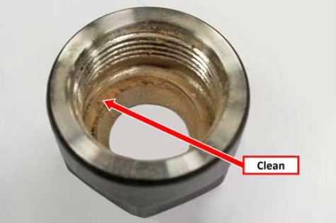

Collet Nut
  • Inspect the inside of the collet nut for dust and resin buildup before each tool change, and clean it if necessary.
Figure 1: Example of a collet nut with dust and resin buildup.
  • Inspect the collet nut for wear and damage every day, and replace it if necessary.

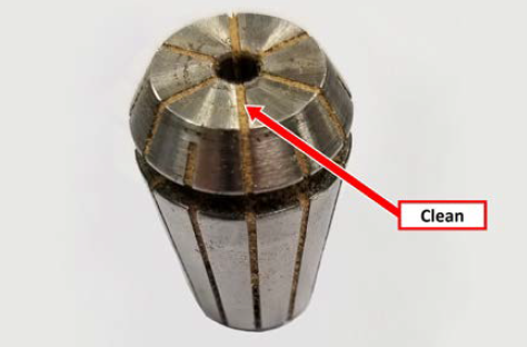

Collet
  • Inspect the slots of the collet for dust and resin buildup, and clean it if necessary.
Figure 2: Example of a collet with dust and resin buildup.
  • Inspect the collet for wear and damage before each tool change, and replace it if necessary.

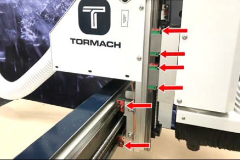

  1. Identify the machine's bearing blocks.
Figure 3: Example of bearing blocks.

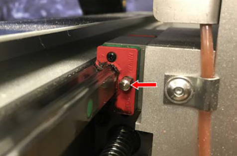

  1. Identify the lubrication port on the bearing blocks.
Figure 4: Lubrication port on a bearing block.

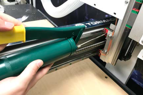

  1. Find the Grease Gun (PN 50360) and the Grease Nozzle Kit (PN 50389) provided with the machine. From the Grease Nozzle Kit, identify the concave nozzle.
  2. Assemble the Grease Gun with the concave nozzle, and lubricate the linear bearings with the recommended lubrication quantity once every 6 months.
Figure 5: Lubricating a bearing block with the Grease Gun.

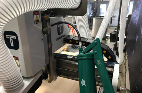

  1. Identify the three remote-mounted lubrication ports.
  2. Use the Grease Gun (PN 50360) provided with the machine (and its attachments) to lubricate the ball screws with the recommended lubrication quantity once every 2-3 months.
Figure 6: Lubricating a remote-mounted lubrication port with the Grease Gun.
