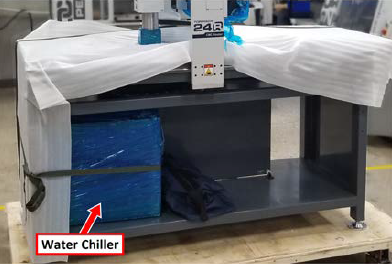

  1. Remove and discard the plastic wrap from the machine.
  2. Cut and remove the shipping straps securing the water chiller and the stand end panel to the machine stand, and set both aside for later installation.
Figure 1: Water chiller packaged for shipping inside of the machine stand.

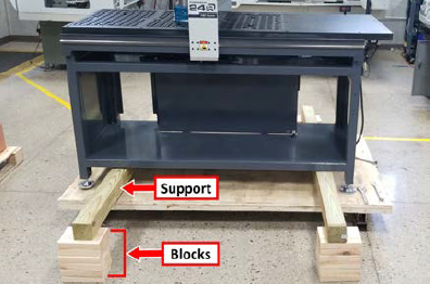

  1. Put two supports on the pallet so that they're approximately 6 in. from each end of the machine stand. Verify that there's enough room between the supports for the pallet jack.
  2. Stack blocks under each end of the supports as shown in the following image.
Figure 3: Boards arranged under the machine to prepare for pallet removal.
WARNING! Transportation and Lift Hazard: Before moving the machine, you must confirm that all persons are clear of the area below the machine. Qualified professionals must transport, lift, and move the machine. Moving parts can entangle, pinch, or cut you, causing death or serious injury.

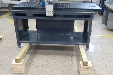

  1. Lower the machine with an adjustable wrench until the weight of the machine is completely held by the supports. Verify that the feet aren't touching the pallet.
  2. Slowly remove the pallet from under the machine.
Figure 4: Pallet removed from the machine, which is now completely held by the boards.

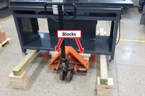

  1. Lift the machine off of the supports with a pallet jack. If your pallet jack doesn't lift high enough to move the machine, stack blocks on it. You must verify that the additional blocks are placed evenly on the pallet jack, and that they're beneath all four lifting points on the machine before attempting to raise the pallet jack.
Figure 5: Lifting the machine from the boards with a pallet jack (and additional boards).

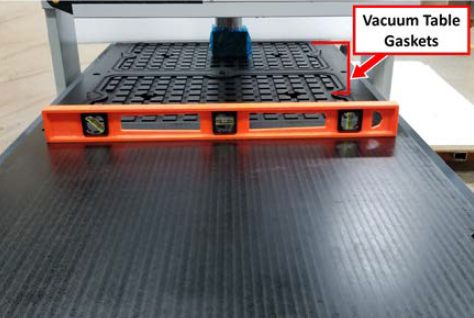

  1. Put a carpenter's level on the machine table. Verify that the level is flat on the table, and isn't on the vacuum table gaskets.
Figure 6: Carpenter's level on the machine table.
