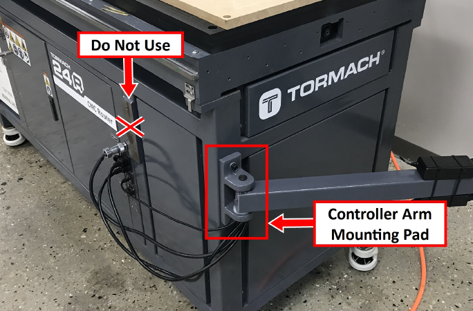

  3. Find the mounting pad on the machine stand.
Figure 1: Controller Arm mounting pad.
WARNING! Crush Hazard: Only install the Controller Arm on the mounting pad at the front end of the machine. If there's a mounting pad next to the electrical cabinet on the machine stand, don't use it. If you do, there's a risk of entrapment between the Controller Arm and the machine's moving parts.

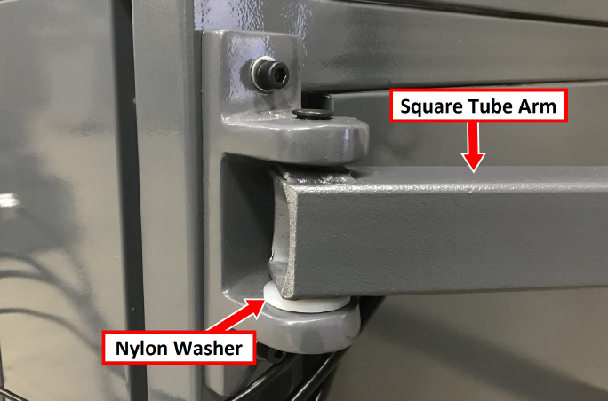

  1. Secure the square tube arm to the machine stand with two M8 socket head cap screws, two M8 flat washers, two M8 lock washers, and a 6 mm hex wrench. Verify that the white nylon washer is located toward the bottom of the mounting pad.
Figure 2: White nylon washer on the square tube arm.

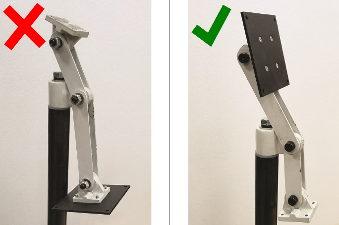

Figure 3: Incorrect and correct orientations of the monitor bracket on the Controller Arm.
Figure 4: Tightening the monitor bracket in place.

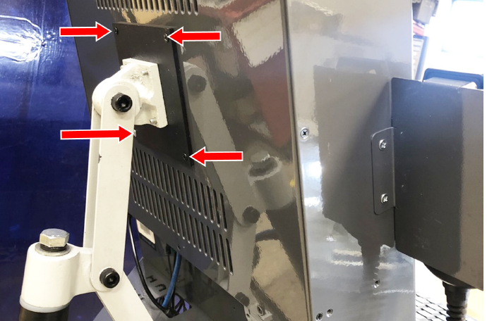

  1. Put the operator console against the monitor mounting plate and align the holes. Attach the operator console and monitor mounting plate together with four M4 × 12 mm socket head cap screws (provided with the operator console).
Figure 5: Operator console attached to the monitor mounting plate.

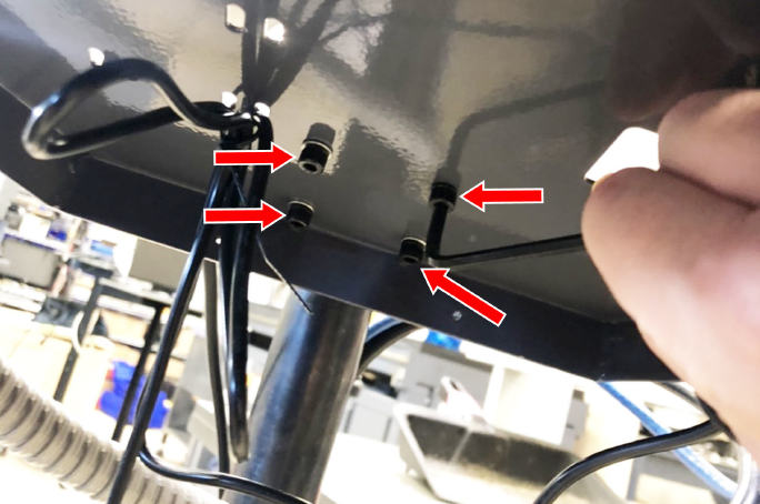

  1. Attach the keyboard tray to the lower controller arm mount with an 8 mm hex wrench.
Figure 6: Attaching the keyboard tray to the lower controller arm mount (from below).

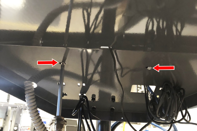

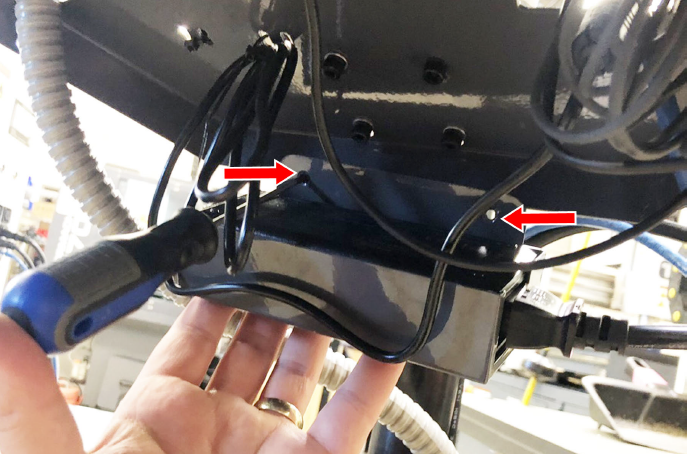

  1. Put the operator console's power supply into the power supply bracket (provided in the operator console box), and attach the assembly to the underside of the keyboard tray with M3 Phillips screws and a Phillips screwdriver.
Figure 8: Attaching the operator console's power supply and power supply bracket to the keyboard tray (from below).

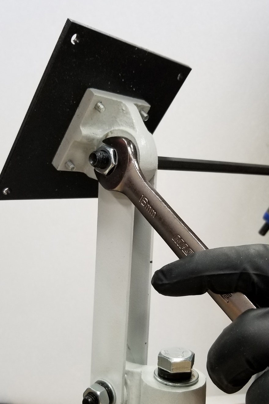

  2. Use the three pivot bolts on the controller arm monitor bracket to adjust the position of the operator console and the keyboard tray to your desired angle with a 3 mm hex wrench and 16 mm hex wrench.

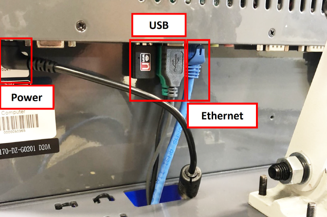

  1. Connect the WiFi dongle to any USB port on the operator console.
  2. Connect the Ethernet cable to the Ethernet port on the operator console.
Figure 9: USB accessories connected
  1. Connect the barrel end of the power supply cable to the Power Supply port on the operator console.
  2. Route the loose ends of the USB, Ethernet, and power supply cables through the square hole in the keyboard tray. Then, use the cable tie holes to secure the loose power supply and USB cables.

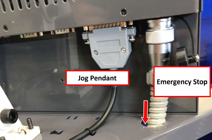

  1. Connect the jog pendant cable and the Emergency Stop cable to the operator console.
Figure 11: Jog pendant (left) and Emergency Stop (right) cables connected.

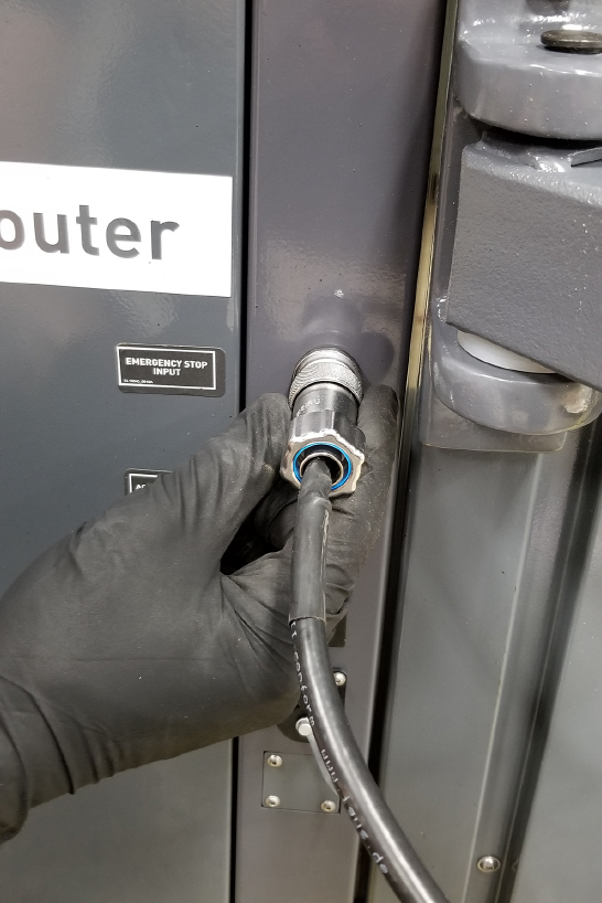

  1. Connect the cable from the operator box to the Emergency Stop Input port on the front right end of the electrical cabinet. Tighten the locking collar to secure the cable.
Figure 12: Operator box cable connected to the Emergency Stop Input port.

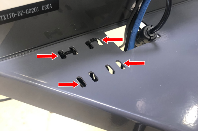

  1. Route the loose end of the operator console's 12 ft power cable, and the Ethernet cable down the controller arm. Then, route the cables through the slots in the square tube arm that's connected to the machine stand.
  2. On the right side of the machine, connect the loose ends of the cables as follows:
    1. Connect the operator console's power cable to any of the Accessory power outlets.
    2. Connect the Ethernet cable to the Controller Communications port.
  3. Secure the cables to the wire tie mounts that you installed on the round monitor post with four 4 in. cable ties.

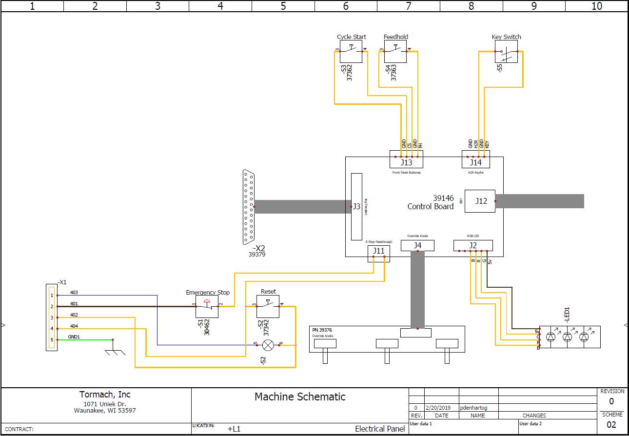

PathPilot Operator Console Electrical Schematic
To view a PDF version of your manual, go to Tormach document TD10787.
