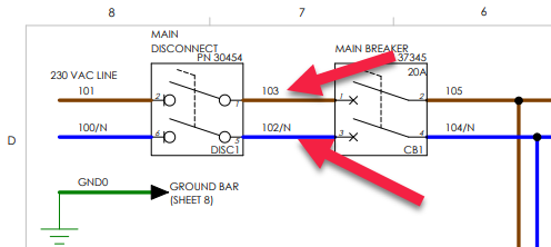

  2. Press the Reset button.
  1. Examine the building’s breaker. If it's not already on, turn it on.
Machine
Wires
Measure for…
1100M/MX
102/N and 103
230 Vac nominal

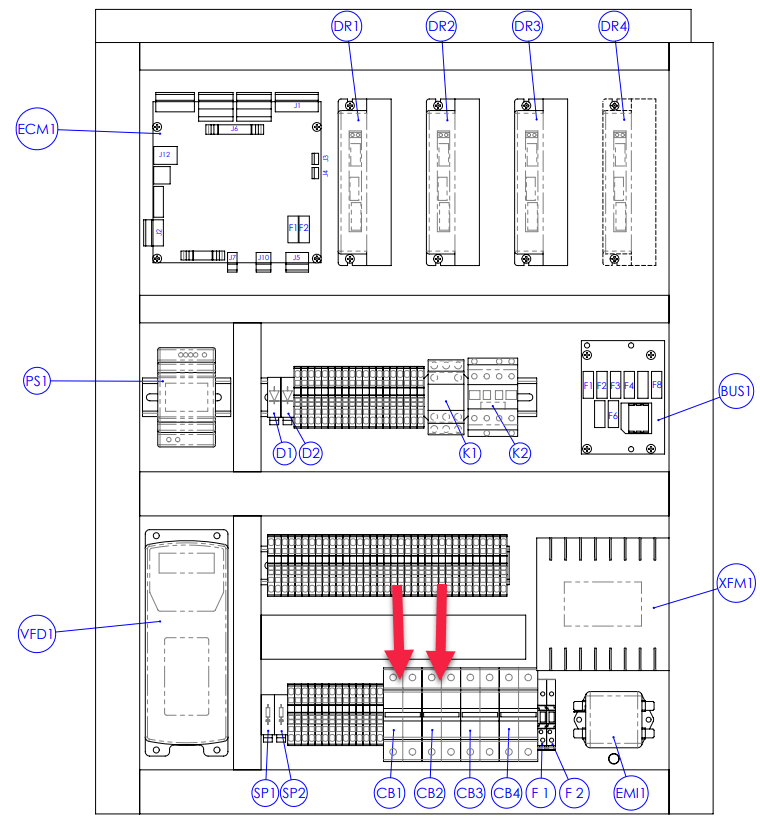

Reset the CB1 and/or CB2 Circuit Breaker
Reason: The CB1 and/or CB2 circuit breaker tripped.
  1. Measure the wires as indicated below.
  2. If required, power off the machine and reset the tripped breaker.
Machine
Wires (CB1 and CB2)
Measure for…
1100M/MX
105 and 104/N
and
107 and 106/N
230 Vac nominal
1100MX CB1 and CB2 Locations

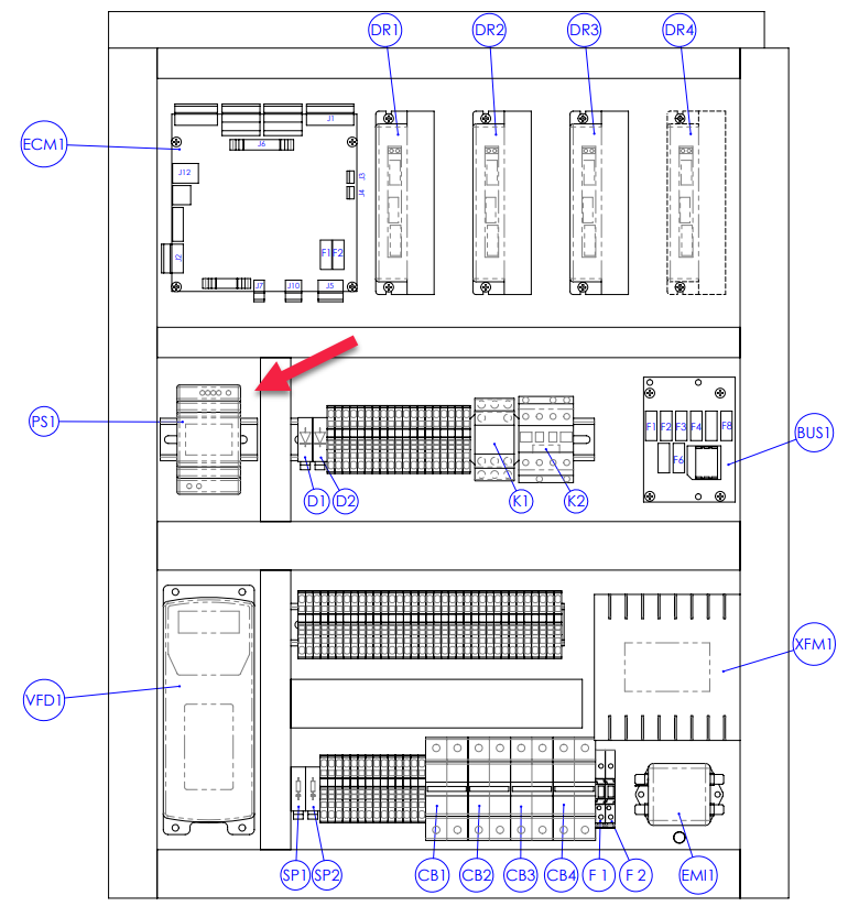

Inspect the DC Power Supply (PS1)
Reason: The DC power supply PS1 is defective.
  1. With a multimeter measure the Vdc between 400 and 401
  2. If the digital multimeter reads below 22 Vdc, with a multimeter measure between 112/N and 113 for the input Vac.
    If the input Vac is correct, replace the DC power supply.
Machine
Wires
Measure for…
1100M/MX
400 and 401
24 Vdc nominal
Machine
Wires
Measure for…
1100M/MX
112/N and 113
220 Vac nominal
1100M/MX PS1 Location
