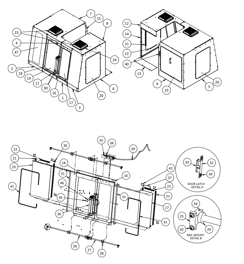

Install the Enclosure Panels
Tip! To install the enclosure panels, work from the left to the right of the machine.
To make it easier to install all components, don't install the side windows until later in the procedure.
Keep all screws one quarter-turn loose while installing the enclosure panels. This makes it easier to align the panels. Once you're done installing the enclosure, fully tighten all screws.
Install the Left Rear Panel
  1. Attach the column cover to the machine column with three M6 × 1.0 - 12 screws.
  2. Attach the left rear panel to the column cover with three M5 × 0.8 - 10 screws.
  3. Attach the left rear panel to the left chip pan with three M6 × 1.0 - 12 screws.

Install the Rear Splash Shield
  1. Attach the rear splash shield to the right chip pan below the electrical cabinet with four M6 × 1.0 - 12 screws.

Install the Front Doors
Assemble the Front Doors
Figure 23: Rubber trim, window, and window retainers layered to assemble the front door.
  1. Push a strip of rubber trim onto the edge of the window opening on each front door. Make sure that the trim starts at one end of the door handle mount, continues around the perimeter of the window, and ends at the opposite side of the door handle mount. When finished, use shears or a knife to cut the excess trim.

Enclosure Exploded View
Enclosure Parts List
