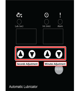

Specify the Interval Time
The oiler distributes oil at the following times:
  • When the machine is powered on
  • After a specified interval
The interval time is the amount of time, in minutes, that the oiler waits between oil applications.
NOTE:   If your machine will be unused for a long period of time (like overnight), we recommend powering off the machine to avoid over-lubricating the system.
  1. On the oiler's control panel, push and hold either of the Minutes Adjustment buttons. It doesn't matter which button you push.
Figure 3: Automatic oiler control panel.
The oiler beeps.
  1. While looking at the Minutes display, do one of the following:
    1. To increase the interval time, push the Up Arrow. We recommend that you set it to 480 minutes (eight hours).
    2. To decrease the interval time, push the Down Arrow.
NOTICE! Pressure Hazard: To avoid potential equipment damage, don't set the interval time to less than five minutes.
Specify the Actuation Time
The actuation time is the amount of time, in seconds, that the oiler distributes oil during an oil application.
  1. On the oiler's control panel, push and hold either of the Seconds Adjustment buttons. It doesn't matter which button you push.
The oiler beeps.
  1. While looking at the Seconds display, do one of the following:
  • To increase the interval time, push the Up Arrow. We recommend that you set it to 12 seconds.
  • To decrease the interval time, push the Down Arrow.
NOTICE! Pressure Hazard: To avoid potential equipment damage, don't set the actuation time to more than three minutes.
