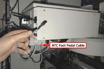

  2. Route the foot pedal cable around the back of the machine and toward the Automatic Tool Changer (ATC).
  3. Find the gray foot pedal cable that's preinstalled on the ATC.
Figure 2: Foot pedal cable preinstalled on the ATC.
  1. Connect the two-pin Molex connector from the foot pedal's cable to the mating connector on the ATC's cable.
  2. Use cable ties to organize the cables.

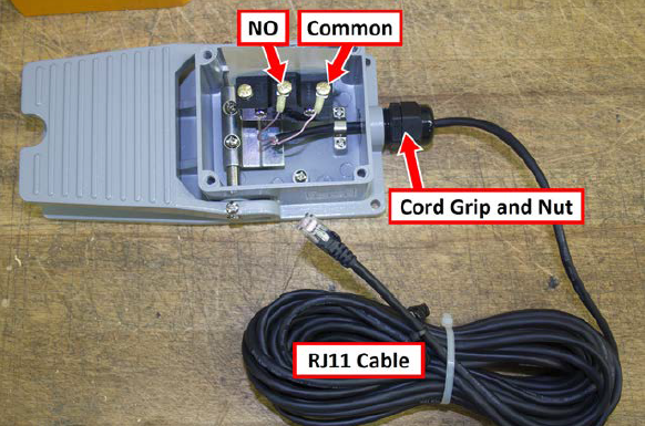

  1. Remove the cover from the foot pedal. Then, set aside the screws and the cover.
  2. Remove the spade connectors from inside the foot pedal. Then, loosen the cord grip and nut, and remove the entire cable from the foot pedal. You can discard this cable.
  3. Find the RJ-11 cable (provided).
  4. Put the end of the RJ-11 cable with exposed wires into the foot pedal.
  5. Connect the brown wire from the cable to NO, and connect the white/brown wire from the cable to Common (as shown in the image).
Figure 3: RJ11 cable installed on the foot pedal.
NOTE: Wire color and polarity don't matter.
Figure 5: RJ11 cable installed on the foot pedal.

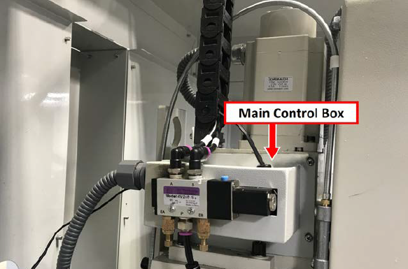

  1. Remove the four screws on the corners of power drawbar's main control box that secure it to the Z-axis motor mount. Then, set aside the screws.
Figure 6: Power drawbar's main control box.

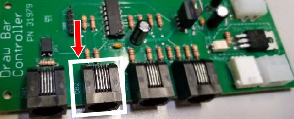

  1. Connect the RJ-11 connector from the foot pedal's cable to the DB2 port on the power drawbar control board.
Figure 7: DB2 port on the ATC control board.
  1. Replace the power drawbar's main control box on the Z-axis motor mount.
