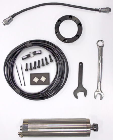

Qty
High-speed Spindle Kit (PN 35178)
PN
High-speed Spindle
34829
Clamping Collar
33160
Spindle Cable
35174
VFD Programming Stick (R8)
31096
VFD Programming Stick (HSS)
35177
M8x25 mm Socket Head Cap Screws
34635
Cable Tie Holders
33193
Cable Ties
31719
30 mm Wrench (use w/ ER collet nut)
30151
21 mm Wrench (use w/ ER collet nut)
35523
16’
Nylon Tubing
35463

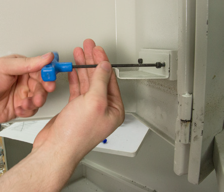

  2. Using an M4 hex wrench, remove the spindle door Interlock Tab (see Figure 1); set aside for later use.
Figure 1

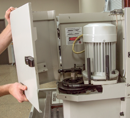

  1. Remove Door (see Figure 2).
Figure 2

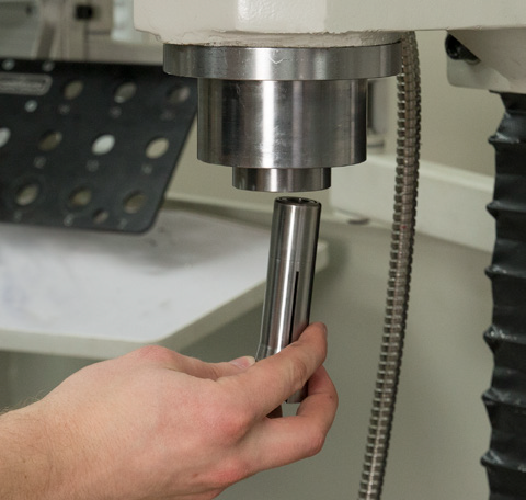

  1. Remove Tormach Tooling System (TTS) collet or tool holder from R8 Spindle (see Figure 3).
Figure 3

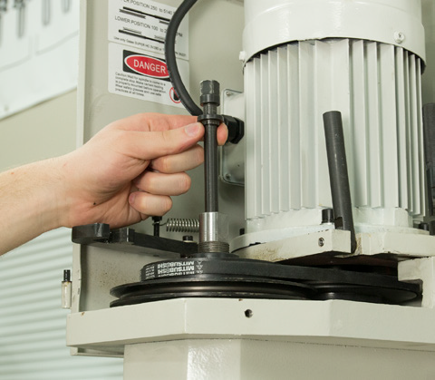

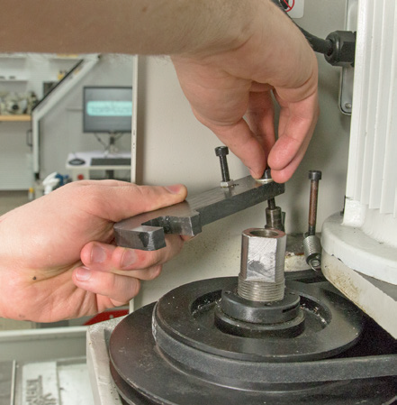

  1. Unscrew and remove Drawbar and Thrust Washer from R8 Spindle (see Figure 4); set aside for future use.
Figure 4

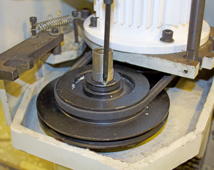

  1. Using a Phillips screwdriver, loosen the Locking Screw on the pulley retention nut (see Figure 5).
Figure 5

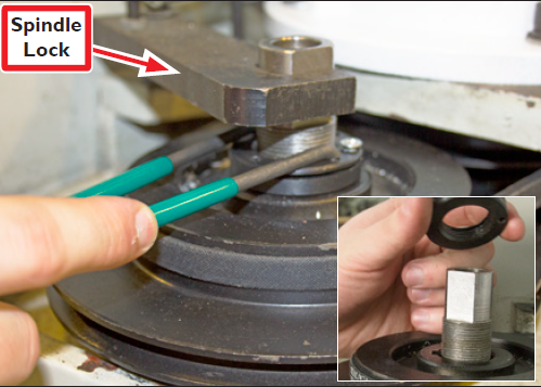

  1. With the Spindle Lock in place, use a pin spanner wrench or channel lock pliers to loosen pulley retention nut (see Figure 6).
Figure 6
  1. Move Spindle Lock to side; remove pulley retention nut (see Figure 6 inset); set aside for future use.

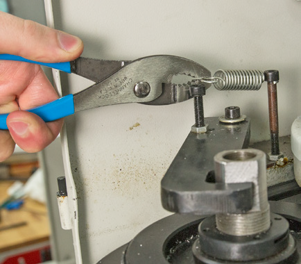

  2. Using a pliers, carefully remove spring from the Spindle Lock (see Figure 7); set aside for future use.
Figure 7

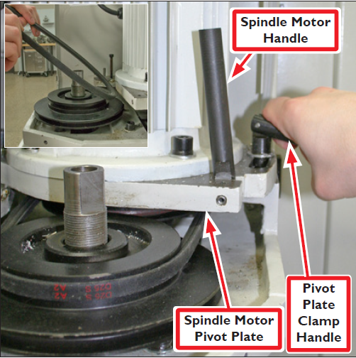

  1. Loosen Pivot Plate Clamp Handle as shown in Figure 9. Swing Spindle Motor Handle down and move Spindle Motor Pivot Plate forward to remove spindle belt (see Figure 9 inset).
Figure 9
  1. Swing Spindle Motor Pivot Plate back to allow spindle belt removal; set aside belt for future use.

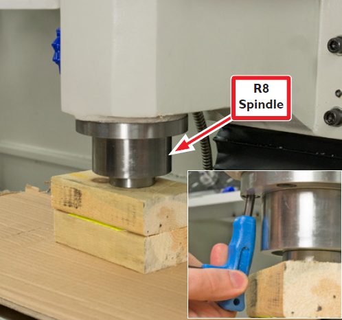

  3. Power off machine according to “Power Off/ On Procedure” earlier in this document.

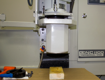

  4. Place wood block(s) under R8 Spindle to prevent damage to both spindle and machine table; lower spindle until gentle contact is made with block(s) as shown in Figure 10.
Figure 10
NOTE: Allow enough space between table and R8 Spindle to allow access to six socket head cap screws (see Figure 10 inset).
  1. Using an M6 hex wrench, remove six socket head cap screws; set aside for future use.

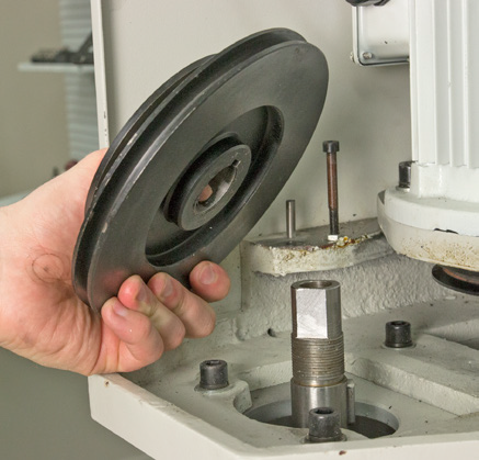

  2. Slowly jog machine up to raise Head Casting just until Spindle Pulley can be removed (see Figure 11); set aside for future use.
Figure 11
NOTE: If pulley is stuck, spray with WD-40® and/or use large gear puller.

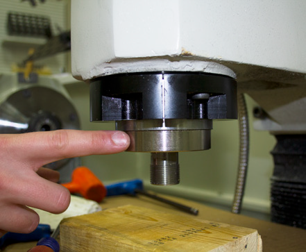

  1. Carefully raise Head Casting slowly until R8 Spindle can be removed (see Figure 12); set aside for future use.
Figure 12

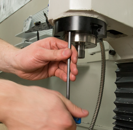

  1. Jog machine down to position spindle mounting face approximately 8” off of machine table (see Figure 13).
Figure 13

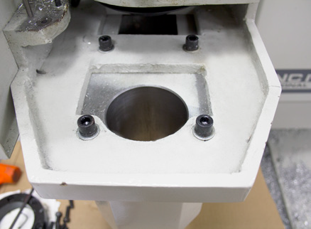

  1. Thoroughly clean spindle bore and use WD-40® or similar to lightly lubricate.
NOTE: Inside rim of Spindle Bore should be free of paint and corrosion. If necessary, use a mild abrasive material such as Scotch-Brite™ to remove any paint overspray present (see Figure 14).
Figure 14
CAUTION! Crush Hazard: Keep hands clear below Spindle Bore when lowering High-speed Spindle into bore. Failure to do so could result in serious injury and/or machine damage.
CAUTION! Pinch Hazard: Keep hands clear on sides of Spindle Bore when lowering High-speed Spindle into bore. Failure to do so could result in serious injury and/or machine damage.

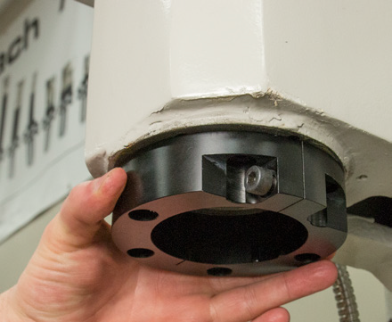

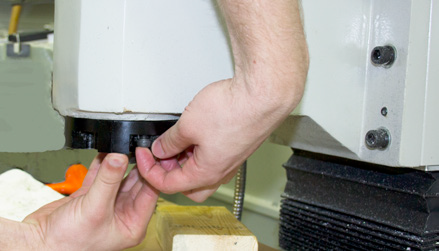

  1. Loosely attach Clamping Collar to Head Casting with two M8x25 mm Socket Head Cap Screws (included), one each on opposite sides of collar for support (see Figure 15).
Figure 15
  1. Loosely install one M8x25 mm Socket Head Cap Screw in clamp position of Clamping Collar (see Figure 16).
Figure 16

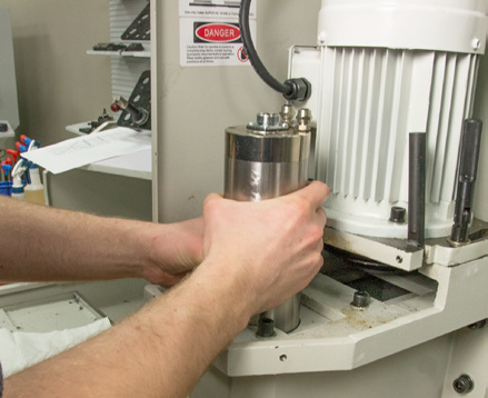

  1. Ensure exterior of High-speed spindle is clean.

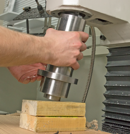

IMPORTANT! Position wood block under Head Casting to protect table against inadvertent drops.
  1. Using two hands, carefully lower High-speed Spindle through bore. Take care to prevent spindle from falling through bore onto machine table (see Figure 17).
Figure 17
NOTE: Depending on fit, Clamping Collar may prevent High-speed Spindle pass through. If necessary use flat screwdriver to wedge Clamping Collar open at slit. Ensure two mounting screws previously installed are not preventing Clamping Collar from flexing.
  1. Adjust spindle depth in collar until between 5/8” to 3/4” of spindle is exposed beyond bottom of Clamping Collar as shown in Figure 18.
Figure 18
  1. Using a hex wrench, finish installing Clamping Collar with four remaining M8x25 mm Socket Head Cap Screws (included) as shown in Figure 19. Tighten all six securely.
Figure 19

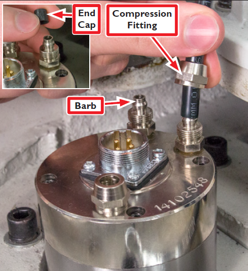

Cooling System Connections
NOTE: The High-speed Spindle requires a source of cooling water. Use of a device such as Water Chiller Kit (PN 35175) or similar is required to circulate water through High-speed Spindle.
  1. Using a diagonal cutters, cut 16’ Nylon Tubing (included) in half to create two equal-lengths.
  2. Using an M14 wrench, remove one Compression Fitting from top of High-speed Spindle (see Figure 20).
Figure 20
  1. Remove plastic End Cap on Barb under Compression Fitting (see Figure 20 inset).
  2. Slide one end of water line through Compression Fitting and push forcefully onto Barb; tighten nut and repeat procedure for second water line.

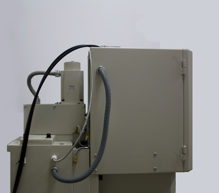

  3. Route water lines from High-speed Spindle over back of mill.
  4. Raise Machine Column to maximum height and then secure water lines with two Cable Tie Holders and Cable Ties (included) in locations shown in Figure 21.
Figure 21

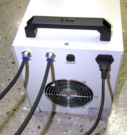

  1. Attach loose ends of water lines to Water Chiller’s inlet and outlet connections (see Figure 22).
Figure 22
NOTE: There is no designated supply or return water line.

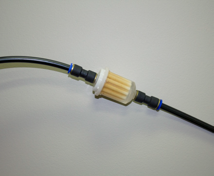

  1. Using a diagonal cutters, cut chiller inlet line to install Water Chiller Replacement Filter (PN 35495) or similar. Arrow in Figure 23 indicates direction of water flow from spindle to inlet connection.
Figure 23
  1. Fill chiller with 2.25 gallons of water and add Water Chiller Anti-corrosive Additive (PN 35553) or similar according to product directions.
  2. Plug chiller into 115 VAC; turn on chiller to inspect for leaks.

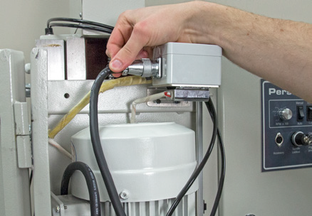

  1. Connect loose end of Spindle Cable to Quick-disconnect Junction Box and screw down threaded connector (see Figure 25).
Figure 25
NOTE: The above step assumes the required Motor Quick Change Kit (PN 35167) is already installed.

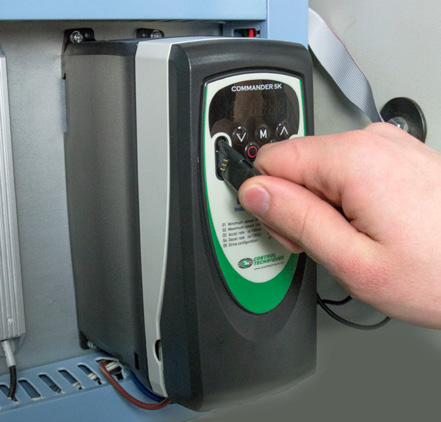

  1. Power off machine according to “Power Off/ On Procedure” earlier in this document.
IMPORTANT! Ensure mill is off before inserting VFD Programming Stick.
  1. Insert included VFD Programming Stick (HSS) into VFD with gold contacts on left as shown in Figure 26.
Figure 26
NOTE: Two different VFD programming sticks are included with High-speed Spindle Kit, one to convert mill for High-speed Spindle use, and a second to revert mill back to R8 Spindle use.
  1. Leave VFD Programming Stick (HSS) plugged into VFD.

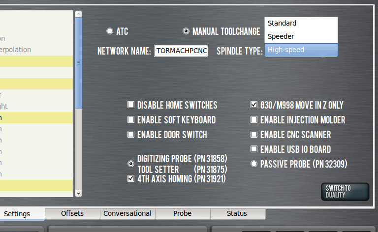

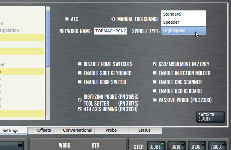

  2. In PathPilot interface, click on Settings screen tab (see Figure 27).
Figure 27
  1. In Spindle Type drop-down menu, select High-speed.
  2. On Settings screen, verify Manual Tool Change is selected (see Figure 27).

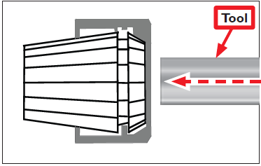

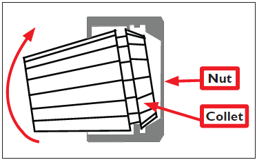

The ER20 collet is a self-extracting collet. The collet must first be mounted in the nut before a cutting tool can be installed:
  1. Holding collet at an angle (see Figure 28), tip collet to snap it into place as shown in Figure 29.
Figure 28
Figure 29
  1. Insert assembly into spindle and tool into collet; tighten using 21 mm and 30 mm wrenches (included).
IMPORTANT! If above steps are not followed, collet/nut may be damaged and holding capacity reduced.
NOTE: Collet nut is intentionally bored asymmetrical. This allows collet to self extract as the nut is loosened.
