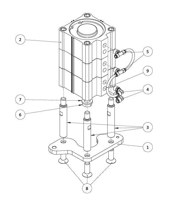

  1. Find the Power Drawbar cylinder assembly provided.
  2. Identify the Power Drawbar mounting surfaces inside of the spindle motor cabinet, as shown in the following image.
Figure 11: Power Drawbar mounting surfaces inside of the spindle motor cabinet.
  1. Put the Power Drawbar cylinder assembly on the mounting surface.
  2. Find the 10 mm shoulder screw provided, and then put Anti-Seize on its threads.
  3. Install the 10 mm shoulder screw on the Power Drawbar cylinder’s mount plate with a 5 mm hex wrench.
NOTE: The head of the shoulder screw will protrude above the mounting plate when the thread of the shoulder screw is fully installed.
The unit, which floats by design, is now securely installed to the spindle head.
Figure 12: 10 mm shoulder screw installed on the Power Drawbar cylinder's mount plate.
  1. Find the quick-release pin provided, and then insert it into the Power Drawbar cylinder’s mount plate.
    The quick-release pin allows the Power Drawbar cylinder to pivot within the spindle motor cabinet.
Figure 13: Quick-release pin inserted into the Power Drawbar cylinder's mount plate.

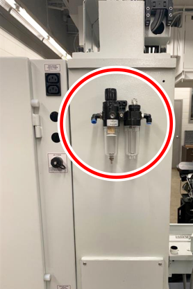

  1. Identify the two holes on the back of the column. This is the mounting location for the FRL.
Figure 15: FRL installed on the machine.
  1. Install the FRL bracket on the machine with your own hardware.
  2. Connect the air lines to the quick-connect bushings.

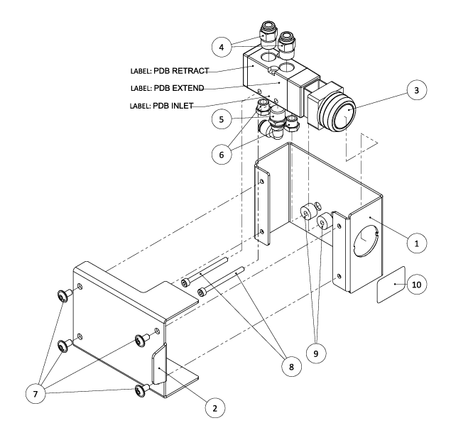

  1. Find the button box assembly provided.
  2. Remove four M5 × 0.8 - 10 button head screws securing the cover to the button box with a 3 mm hex wrench. Then, remove the cover.
  3. Install the button box base, standoffs, and button assembly on the mill head with two M4 × 0.7 - 50 socket head cap screws.
Figure 18: Button box base installed on the mill head.

Examine Air Pressure
Appropriate air supply helps with smooth actuation, and prevents premature component failure.
  • Examine the air to the Power Drawbar to make sure that it's:
    • Between 90 psi and 120 psi (620 kPa to 825 kPa)
    • Been lubricated with common air tool oil

TTS Power Drawbar Cylinder Exploded View
TTS Power Drawbar Cylinder Assembly Parts List
ID
Power Drawbar Mount Plate (PN 37747)
Pneumatic Cylinder, Double Acting, 100 mm Bore, 12 mm Stroke, 3-Stack (PN 31313)
Power Drawbar Standoff, M14 × 2 (PN 38282)
Fitting, Branch Tee, 1/4 NPT to 1/4 OD Tube (PN 31325)
Screw, Hex Head Cap, M16 × 1.5 - 25 (PN 31322)
Washer, Flat, M16 (PN 31445)
Screw, Flat-Head Cap, M14 × 2 - 40 (PN 38285)
Tube, 1/4 in. OD, Plastic (Red) - 125 mm (PN 38408)
Power Drawbar Push Button Exploded View
Power Drawbar Push Button Parts List
ID
Power Drawbar Push Button Base (PN 38217)
Power Drawbar Push Button Cover (PN 38218)
Push Button Air Valve (4-Way, 5-Port) (PN 37295)
Fitting, Male Connector, 1/4 NPT to 1/4 in. PTC (PN 32212)
Fitting, Muffler (Flat), 1/8 NPT (PN 37297)
Screw, Socket Head Cap, M4 × 0.7 - 50 (PN 38220)
Power Drawbar Push Button Spacer (PN 38219)
Decal, Power Drawbar, Release Tool (PN 37340)
