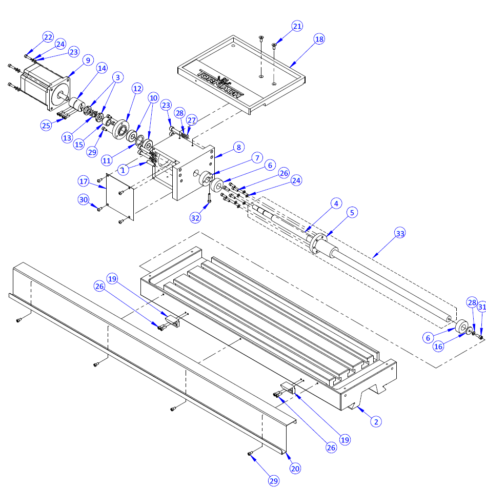

X-Axis Assembly - 1100M
Alternative Part Number
Taper Pin, 8 mm × 30 mm (PN 30428)
1100 Machine Table (PN 30436)
Bearing Nut, M14 × 1.5, Tab Lock (PN 30363)
1100 X-Axis Ball Screw (PN 37953)1
1100 X-Y Ball Nut1
X-/Y-Axis Ball Screw End Bumper, 1100 (PN 30400)
Ball Screw End Stop Clamp (PN 30433)
X-Axis Motor Mount*
X-/Y-Axis Motor, 1100 (PN 32001)
Bearing, Angular Contact, 7202B (P6), 15 mm × 35 mm × 11 mm (PN 30373)
11
X-Y Ball Screw Bearing Spacer (PN 30429)
12
X-Y Ball Screw Bearing Cover Plate*
13
Bearing Nut Lock Washer, M14 (PN 30364)
14
Ball Screw Coupler (PN 30362)
15
X-Y Bearing Nut Sleeve (PN 30444)
16
X-Y End Bumper Washer (PN 30401)
17
1100 X-Axis Motor Mount Cover Plate*
18
Tool Tray, 1100 (PN 31630)
19
X-Axis Limit Switch Flag (PN 31208)
20
Table Drip Guard, 1100 (PN 32753)
