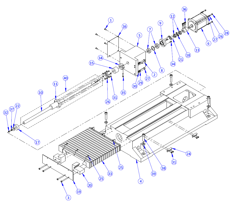

Y-Axis Assembly - 1100M
Alternative Part Number
Screw, Button Head Cap, M5 × 0.8 - 12, Stainless Steel
McMaster-Carr: 92095A210
Taper Pin, 8 mm × 30 mm (PN 30428)
Screw, Pan Head Machine, M6 × 1 - 40
McMaster-Carr: 92005A442
1100 Machine Base*
Y-Axis Motor Mount*
X-/Y-Axis Motor, 1100 (PN 32001)
Bearing, Angular Contact, 7202B (P6), 15 mm × 35 mm × 11 mm (PN 30373)
X-Y Ball Screw Bearing Spacer (PN 30429)
X-Y Ball Screw Bearing Cover Plate*
1100 Y-Axis Ball Screw (PN 37951)1
11
1100 X-Y Ball Nut1
12
Bearing Nut, M14 × 1.5, Tab Lock (PN 30363)
13
Ball Screw Coupler (PN 30362)
14
Ball Screw End Stop Clamp (PN 30433)
15
Y-Axis Ball Screw Back Bumper, 1100 (PN 30446)
16
Motor Mount Cover Plate*
17
X-/Y-Axis Ball Screw End Bumper, 1100 (PN 30400)
18
Bearing Nut Lock Washer, M14 (PN 30364)
19
Y-Axis Cover Plate (PN 30406)
20
Y-Axis Bellows Spacer*
21
X-Y Bearing Nut Sleeve (PN 30444)
22
X-Y End Bumper Washer (PN 30401)
23
Fitting, Oil, Tee (PN 32354)
24
Y-Axis Limit Switch Flag (PN 30450)
25
Screw, Pan Head Machine, M4 × 0.7 - 12
McMaster-Carr: 92005A222
26
Washer, Split Lock, M5
McMaster-Carr: 91111A124
27
Screw, Socket Head Cap, M8 × 1.25 - 40
McMaster-Carr: 91290A442
28
McMaster-Carr: 91290A242
29
Washer, Split Lock, M8
McMaster-Carr: 91202A238
30
Washer, Flat, M8
McMaster-Carr: 91166A270
31
Screw, Socket Head Cap, M5 × 0.8 - 16
McMaster-Carr: 91290A232
32
Screw, Socket Head Cap, M6 × 1 - 16
McMaster-Carr: 91290A321
33
Y-Axis Way Cover, 1100 (PN 30578)
34
Screw, Socket Head Cap, M5 × 0.8 - 10
McMaster-Carr: 91290A224
35
McMaster-Carr: 91290A252
36
Screw, Socket Head Cap, M4 × 0.7 - 16
McMaster-Carr: 91290A154
37
Washer, Split Lock, M6
McMaster-Carr: 91169A180
38
Screw, Socket Head Cap, M12 × 1.75 - 50
McMaster-Carr: 91290A626
39
Washer, Flat, M12
McMaster-Carr: 91166A290
40
Y-Axis Ball Screw Assembly, 1100 (PN 38800)1
1Items #10 and #11 sold as assembly #40 PN 38800.
