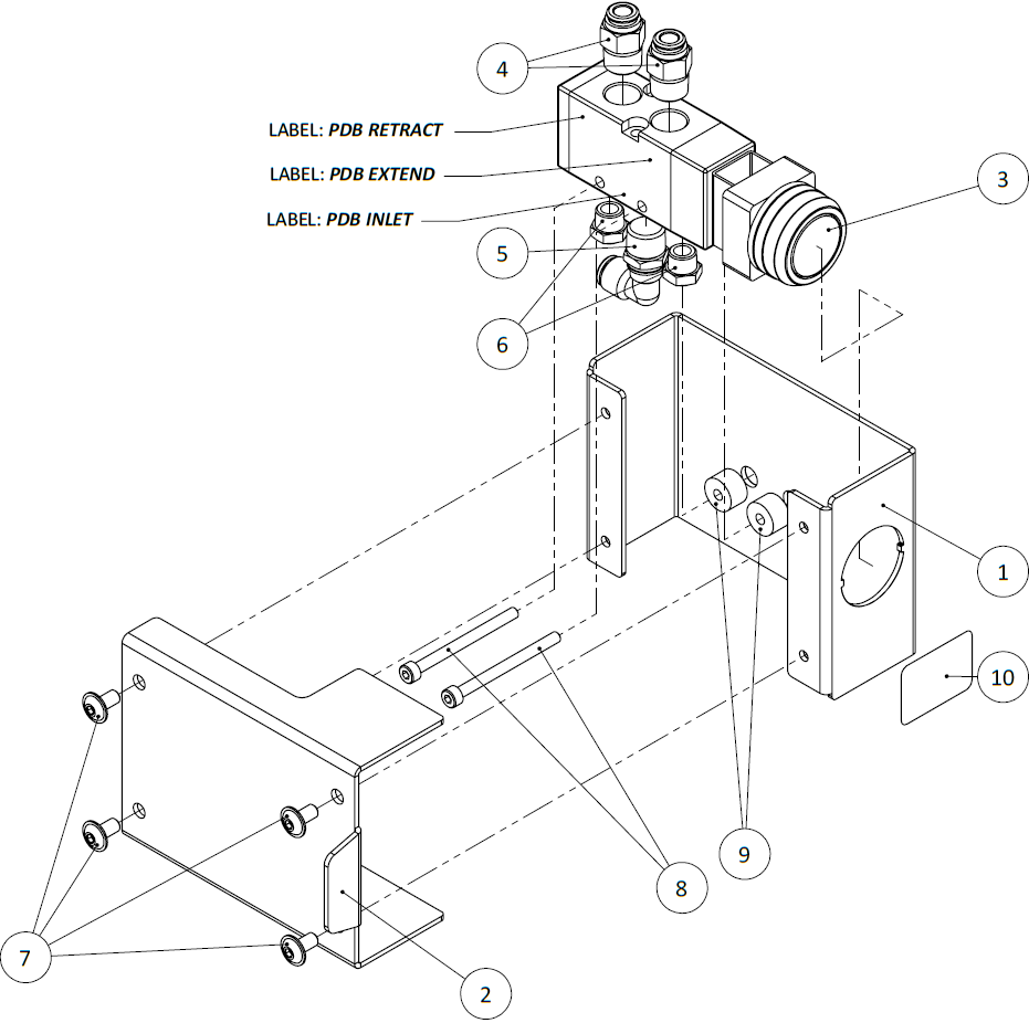

Alternative Part Number
Power Drawbar Push Button Base (PN 38217)
Power Drawbar Push Button Cover (PN 38218)
Push Button Air Valve (4-Way, 5-Port) (PN 37295)
Fitting, Male Connector, 1/4 NPT to 1/4 in. PTC (PN 32212)
Fitting, Muffler (Flat), 1/8 NPT (PN 37297)
McMaster-Carr: 97654A376
Screw, Socket Head Cap, M4 × 0.7 - 50
McMaster-Carr: 91290A186
Power Drawbar Push Button Spacer (PN 38219)
Decal, Power Drawbar, Release Tool (PN 37340)
