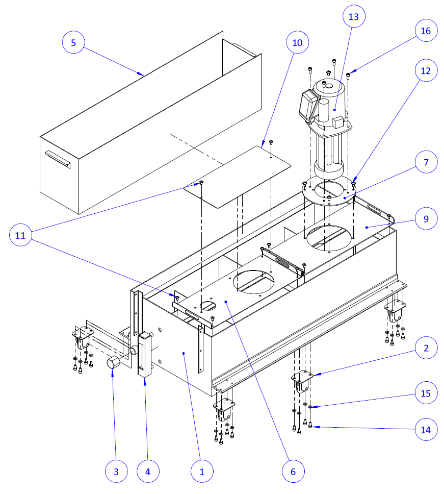

Coolant Tank - 1100M
Alternative Part Number
Coolant Tank*
Straight Caster (PN 37626)
3/4 in. NPT Cap (PN 37627)
Sight Gauge (PN 50868)
Chip Tub (PN 37532)
Skimmer Plate*
Pump Adapter Cover*
Cup Clamp*
Large Pump Plate*
Skimmer Plate Cover*
11
McMaster-Carr: 97654A376
12
12
McMaster-Carr: 97654A380
13
Coolant Pump, 1/8 hp (PN 33218)
14
Screw, Socket Head Cap, M6 × 1 - 12
McMaster-Carr: 91290A318
16
15
Washer, Flat, M6
McMaster-Carr: 91166A250
16
16
Screw, Socket Head Cap, M6 × 1 - 14
McMaster-Carr: 91290A319
