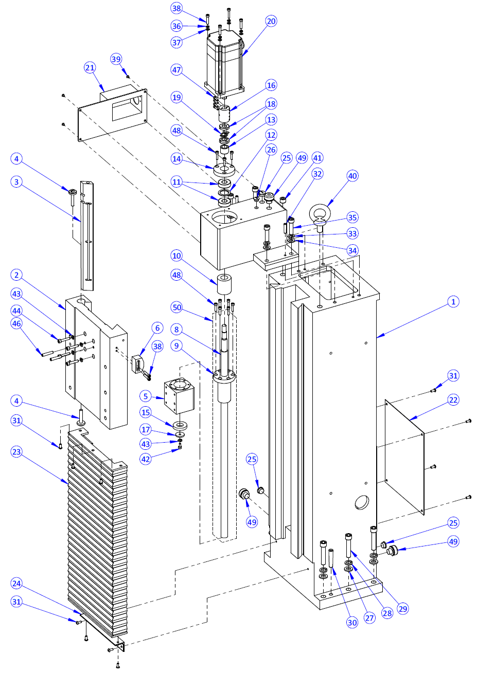

Z-Axis Assembly - 1100M
Alternative Part Number
1100 Column*
1100 Z-Axis Saddle*
Z-Axis Gib (PN 30384)
Z-Axis Gib Screw (PN 30412)
Z-Axis Ball Nut Carrier (PN 30387)
Z-Axis Limit Switch Flag*
Z-Axis Motor Mount*
1100 Z-Axis Ball Screw1
1100 Z-Axis Ball Nut1
Z-axis Ball Screw Upper Bumper, 1100 (PN 30375)
11
Bearing, Angular Contact, 7202B (P6), 15 mm × 35 mm × 11 mm (PN 30373)
12
Bearing Spacer (PN 30374)
13
Bearing Nut Sleeve (PN 30371)
14
Z-Axis Bearing Retainer (PN 30372)
15
Z-Axis Ball Screw Lower Bumper, 1100 (PN 30388)
16
Ball Screw Coupler (PN 30362)
17
Lower Bumper Washer*
18
Bearing Nut, M14 × 1.5, Tab Lock (PN 30363)
19
Bearing Nut Lock Washer, M14 (PN 30364)
20
Motor, DCM + Brake, NEMA 34, 5.5 Nm (PN 38402)
21
Z-Axis Drag Chain Box*
22
Column Cover Plate*
23
Z-axis Way Cover (PN 30378)
24
Z-Axis Way Cover Bracket*
25
Hole Plug, Threaded PG9*
26
Hole Plug, Threaded PG7*
27
Washer, Flat, M12
McMaster-Carr: 91166A290
28
Washer, Split Lock, M12
McMaster-Carr: 91202A246
29
Screw, Socket Head Cap, M12 × 1.75 - 60
McMaster-Carr: 91290A234
30
Taper Pin, 10 mm - 55 mm (PN 30381)
31
Screw, Button Head Cap, M5 × 0.8 - 12, Stainless Steel
McMaster-Carr: 92095A210
11
32
Taper Pin, 6 - 30*
33
Washer, Split Lock, M10
34
Washer, Flat, M10
McMaster-Carr: 93475A280
35
Screw, Socket Head Cap, M10 × 1.5 - 40
McMaster-Carr: 91290A528
36
Washer, Split Lock, M5
McMaster-Carr: 91111A124
37
Washer, Flat, M5
McMaster-Carr: 93475A240
38
McMaster-Carr: 91290A252
39
Screw, Button Head Cap (Flanged) M3 × 0.5 - 6
McMaster-Carr: 97654A674
40
Eye Bolt, M16 × 2 - 28
41
Screw, Flat Point Set, M16 × 2 - 12
McMaster-Carr: 93245A457
42
Screw, Socket Head Cap, M5 × 0.8 - 10
McMaster-Carr: 91290A224
43
Washer, Split Lock, M6
McMaster-Carr: 91169A180
44
Screw, Socket Head Cap, M6 × 1 - 30
McMaster-Carr: 91290A332
45
Nut, Hex, M5 × 0.8
McMaster-Carr: 90591A260
46
Taper Pin, 6 - 35*
47
Screw, Socket Head Cap, M4 × 0.7 - 16
McMaster-Carr: 91290A154
48
McMaster-Carr: 91290A242
49
Flex Conduit Fitting, 13 mm ID × 16 mm OD (PN 30628)
50
Z-Axis Ball Screw Assembly, 1100 (PN 30382)1
