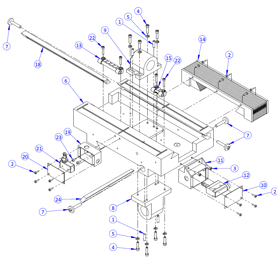

Y-Axis Saddle - 1100M
Alternative Part Number
6 - 25 Taper Pin (PN 30439)
Screw, Pan Head Machine, M4 × 0.7 - 12
McMaster-Carr: 92005A222
14
McMaster-Carr: 91290A242
McMaster-Carr: 91290A330
Washer, Split Lock, M6
McMaster-Carr: 91169A180
1100 Y-Axis Saddle*
Gib Adjustment Screw for 1100 (PN 30412)
Y-Axis Ball Nut Carrier (PN 30453)
X-Axis Ball Nut Carrier (PN 30441)
Y-Axis Limit Switch Cover Plate*
11
Y-Axis Limit Switch Housing (PN 30452)
12
Y-Axis Limit Switch (PN 30461)
13
5-Port Manifold (PN 33955)
14
Y-Axis Way Cover, 1100 (PN 30578)
15
Lubrication System, 2-Port Manifold (PN 33954)
16
1100 X-Axis Ball Screw1
17
1100 X-Y Ball Nut1
18
X-Axis Gib (PN 30443)
19
X-Axis Limit Switch Housing (PN 31211)
20
X-Axis Limit Switch Cover Plate (PN 31210)
21
X-/Z-Axis Limit Switch (PN 31860)
22
McMaster-Carr: 91290A252
23
Screw, Pan Head Machine, M5 × 0.8 - 10
McMaster-Carr: 92095A182
24
Y-Axis Gib (PN 30413)
1 Purchased as assembly PN 30483
