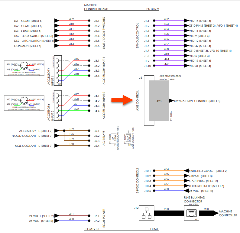

Your machine axes require power and control signals to work. If either of those are disrupted you can lose any or all axis motion. If all of your motors are not working, go to All Axes Won't Move When Commanded.

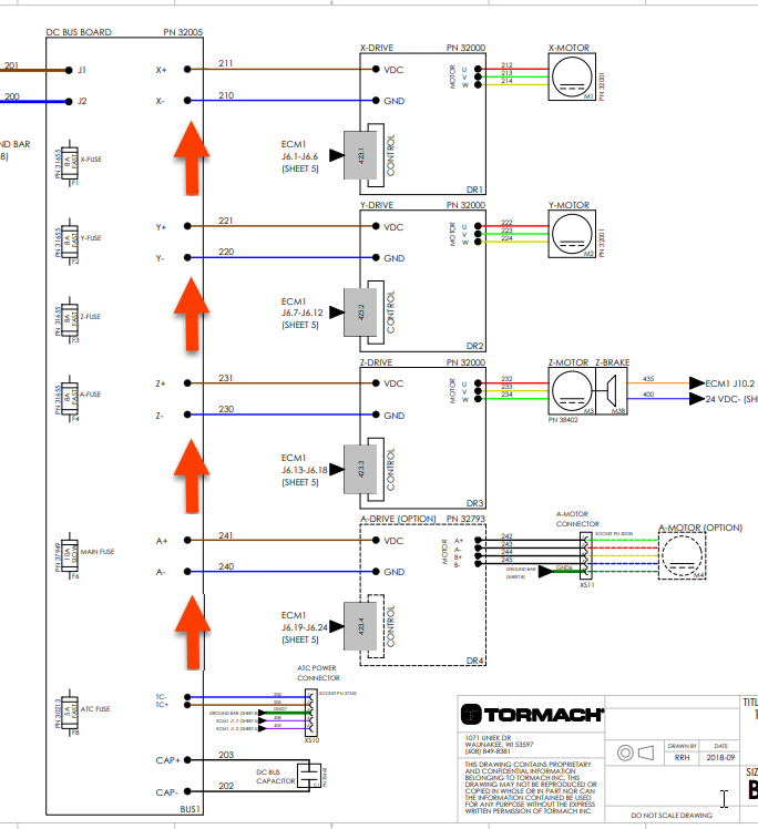

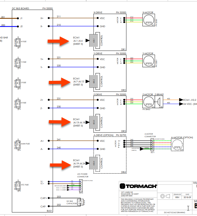

M Axis Drivers
M ECM Board
    DC-Bus/Stepper driver controllers: Spade connectors/Degson style
    1. 210/211 (X-axis)
    2. 220/221 (Y-axis)
    3. 230/231 (Z-axis)
M DC Bus Board
Inspect the Motor’s Drivers
Reason: There's a defective or malfunctioning axis driver/cable.
Full Stepper Driver Controller Swap (Full Driver Swap) warning NOTE: 4th AXIS DRIVERS CANNOT BE SWAPPED WITH SERIES 3 OR 'M' SERIES MACHINE DRIVERS. warning
  1. Power off the machine.
    info There will be no change to how to jog the swapped axis.
  4. Power on the machine.

Inspect the DC-BUS board
Reason: There's a blown fuse on the DC-BUS board.
    1. If the green LED is not illuminated: Go to All Axes Won't Move When Commanded - 1100M
  3. Power off the machine.
Function
Fuse Number
Amperes
Speed
X-Axis
F1
8 A
Fast
Y-Axis
F2
8 A
Fast
Z-Axis
F3
8 A
Fast
A-Axis
F4
8 A
Fast
Main DC-BUS fuse
F6
10 A
Slow
ATC
F8
5 A
Fast
