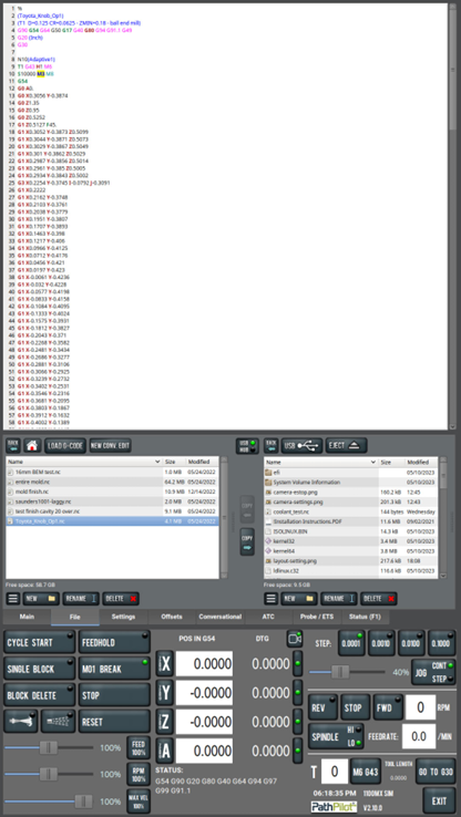

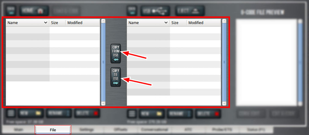

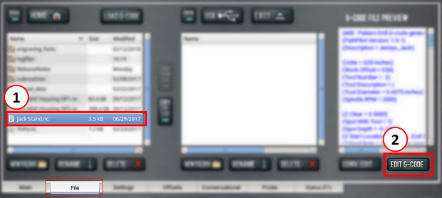

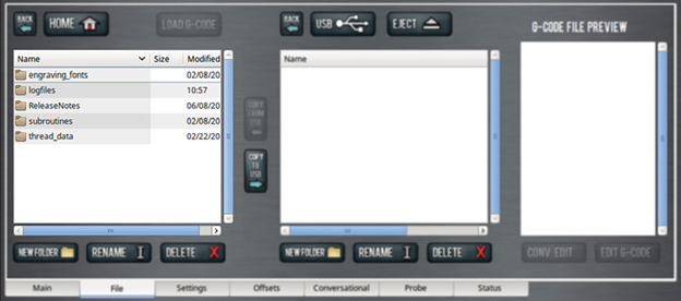

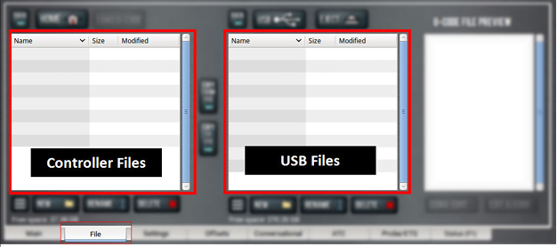

Load G-Code
To load G-code:
  2. Select Load G-Code.
  2. From the File tab, select the file to transfer (either in the USB Files window or the Controller Files window).
  1. If you’re using a USB drive, Select Eject.

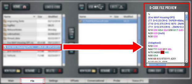

Preview G-Code Files
To preview G-code files:
Access Recent G-Code Files
    The G-code program loads.

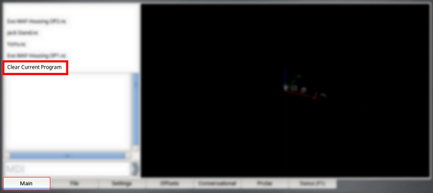

Close the Current Program

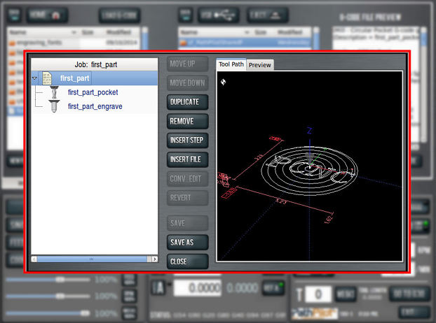

Change the Step Order
Create a New Job Assignment
  1. Select Insert Step.
  3. Select Insert.
Load an Existing G-Code File
  3. Select Open.
Edit a Job Assignment
  1. Select the job assignment, and then select Conv. Edit.
  2. Edit the job assignment.
  3. Select Finish Editing.

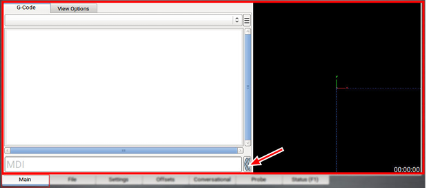

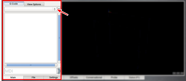

Read G-Code
Expand the G-Code Tab
To expand the G-Code tab:
  • Select the Window Expander.
About the G-Code Tab

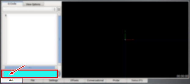

Search in the Code
To search in the code:
  1. Select the Enter key.
  2. (Optional) Select Enter.
Set a New Start Line
To set a new start line:
    1. Right-click any line in the program.
  • Tap the line. Then, select the Options menu.

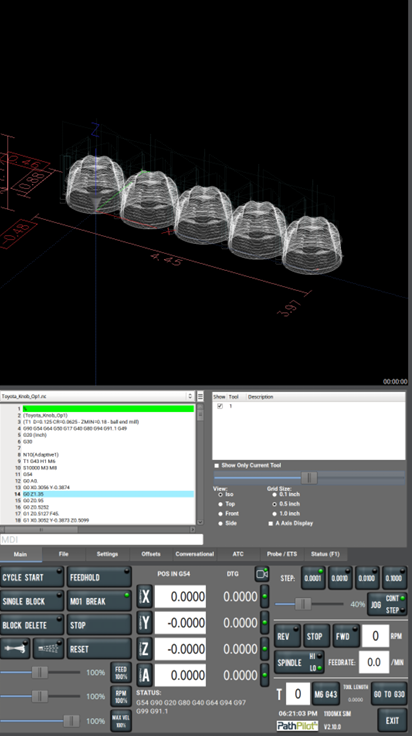

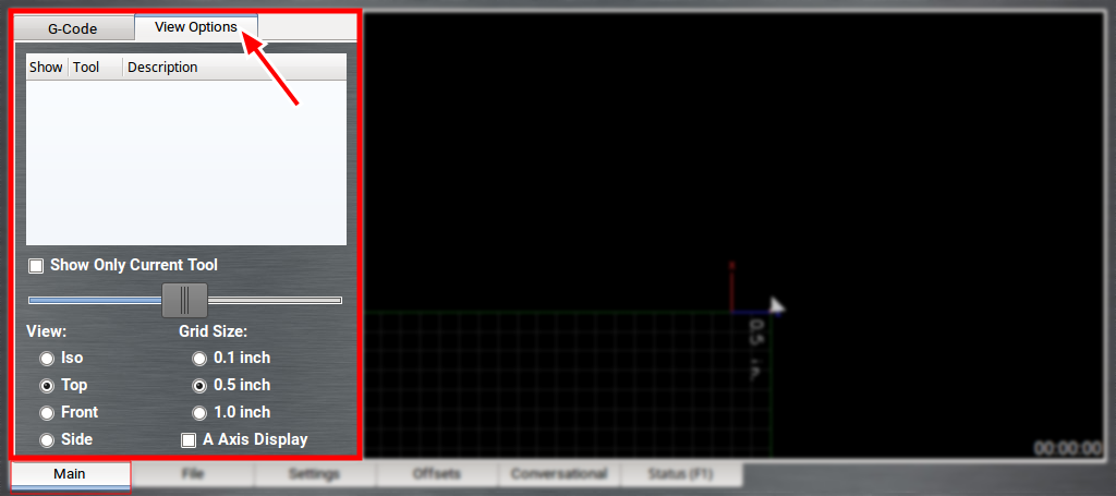

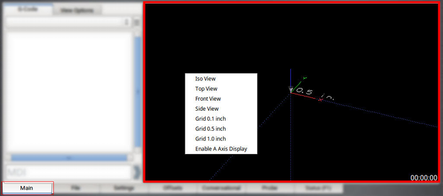

  1. Select a new view.
About the Tool Path Display
  • Front
  • Iso
  • Side
  • Top
  • G20 Mode 1/2 in. intervals
  • G21 Mode 5 mm intervals
  • Select Reset.

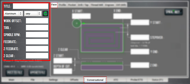

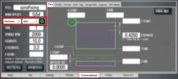

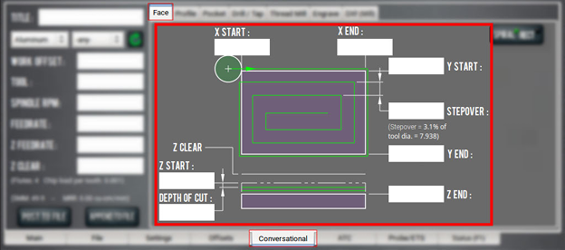

Create a Face on a Part
Using conversational programming, you can program PathPilot to take multiple cuts — each following the last — on an X/Y plane over a Z range. For information, see "About Facing".
  • The area from the rear, left corner of the workpiece to the rear, right corner of the workpiece must be clear of any obstructions from the Z Start position to the Z End position.
  • The top of the workpiece must be free of any workholding devices.

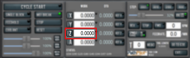

  • The value used in the Z End DRO field must be such that it is above the workholding device.
  • The value used in the Z Clear DRO field must be such that it is above any obstruction in the tool path between the end of one pass and the beginning of the next.
To create a face on a part:
    1. In the X Start DRO field and the X End DRO field, type the location of the workpiece edges. We recommend using the rear left corner of the part for the X Start value.
    2. In the Y Start DRO field and the Y End DRO field, type the location of the workpiece edges. We recommend using the front right corner of the part for the Y End value.
    3. In the Stepover DRO field, type the required distance between tool paths. To prevent uncut areas in the spiral corners, we recommend limiting this value to 80% of the tool diameter. For information, see "Facing Reference".
    4. In the Z Start DRO field and the Z End DRO field, type the location of the first and last Z passes. For a single Z pass at the location typed in the Z End DRO field, type a value of 0 or a full Z range value into the Depth of Cut DRO field.
    5. In the Depth of Cut DRO field, type the desired amount of material to remove.
NOTE: The depth of cut is later adjusted within the Z range so that each pass in the Z range has the same depth (rather than the last Z pass having a short depth of cut).

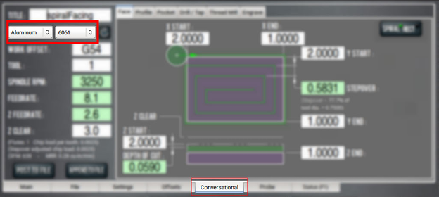

About Facing
Face milling is the process of cutting a surface that's perpendicular to the axis of the cutting tool. A facing program is usually used to cut an accurate, finished top surface on a rough piece of stock material. After a facing program is complete, tool marks remain — creating a fairly flat surface, with microscopic height differences.
Facing in PathPilot
When using a facing routine, each tool pass along the X-/Y-axis begins off to the side of the workpiece to avoid plunging into the workpiece. To compensate for this procedure, PathPilot sets lead-in tool paths outside of the workpiece using the part's work offsets, the tool's diameter, and the predetermined stepover value. PathPilot also adjusts the depth of cut to make sure each tool pass has the same depth, rather than cutting a short depth on the last pass of the program.
  1. Moves the machine to the predefined G30 position, or the tool change position.
  2. If required, performs or requests a tool change.
  3. Makes a rapid move in the X and Y direction to the beginning of the workpiece.
  4. Makes a rapid move in the Z direction to the predefined Z Clear position.
  5. Begins the cut in the X/Y plane at an adjusted Z depth of cut.
NOTE: The value entered into the Depth of Cut DRO field is adjusted within the Z range (the value entered into the Z End DRO field minus the value entered into the Z Start DRO field).
  1. Makes cuts in a rectangular spiral from the workpiece perimeter to the workpiece center.
For information on using conversational programming in PathPilot to face a part, see "Create a Face on a Part".

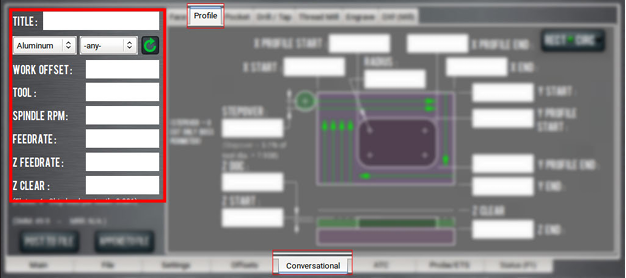

Create a Profile on a Part
Using conversational programming, you can program PathPilot to take multiple cuts — each following the last — on an X/Y plane over a Z range to form a boss. For information, see "About Profiling".
  • The value used in the Radius DRO field must be between 0 and either:
    • One half of the boss' narrow width, or
    • The full radii on the long ends of the boss
  • The value used in the Z Clear DRO field must be set to clear any obstructions between path changes.
To create a profile on a part:
  2. From the Conversational DROs group, set the parameters for the profiling operation.
    3. In the X Profile Start DRO field, the X Profile End DRO field, the Y Profile Start DRO field, and the Y Profile End DRO field, type the location of the profile's outer edges.
    4. In the Stepover DRO field, type the required distance between tool paths. If you want a single cut in the workpiece (to create a slot), type 0.
    5. In the Radius DRO field, type the required radius for the corners of the profile. For no corner radius, type 0.
    6. In the Z Start DRO field and the Z End DRO field, type the location for the first and last Z passes. For a single Z pass at Z End, type 0 — or a full Z range value — in the Z DOC DRO field.
    7. In the Z DOC DRO field, type the desired amount of material to remove.

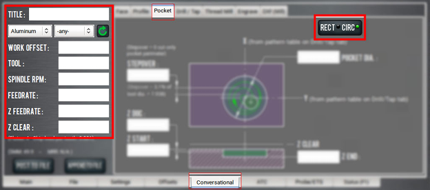

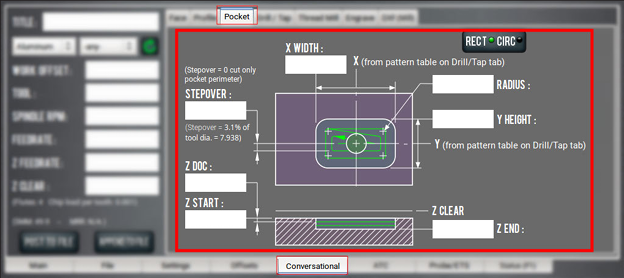

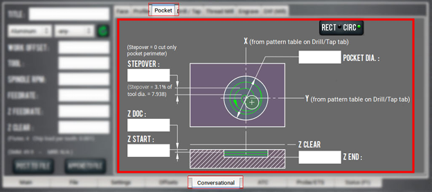

Create a Pocket on a Part
Using conversational programming, you can program PathPilot to take multiple cuts — each following the last — on an X/Y plane over a Z range to form a circular or rectangular pocket. For information, see "About Pockets".
    • One half of the pocket's narrow width, or
    • The full radii on the long ends of the pocket

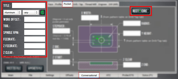

To create a circular pocket on a part:
  1. From the Conversational tab, select the Pocket tab.
  2. From the Conversational DROs group, set the parameters for the pocket operation.
    1. In the X Center DRO field and the Y Center DRO field, type the location of the pocket's center.
    2. In the Pocket Dia. DRO field, type the required diameter for the pocket.
NOTE: The radius of the tool is used to set the tool path diameter.
c. In the Stepover DRO field, type the required distance between each rotation of the spiral cut. For a single cut around the inside perimeter of the pocket (to create a slot), type 0.
d. In the Z Start DRO field and the Z End DRO field, type the location of the first and last Z passes. For a single Z pass at the location typed in the Z End DRO field, type a value of 0 or a full Z range value into the Depth of Cut DRO field.
e. In the Z DOC DRO field, type the desired amount of material to remove.
To create a rectangular pocket on a part:
    1. In the X Start DRO field, the X End DRO field, the Y Start DRO field, and the Y End DRO field, type the location of the pocket edges.
    2. In the Radius DRO field, type the required radius for the corners of the pocket. For no corner radius, type 0.
    3. In the Stepover DRO field, type the required distance between adjacent tool paths. For a single cut around the inside perimeter of the pocket (to create a slot), type 0.
    5. In the Z DOC DRO field, type the desired amount of material to remove.
About Pockets
A pocket program is usually used to remove a large amount of material from a part.
Creating Pockets in PathPilot
For more information about creating a pocket on a part using conversational programming, see of the following sections, depending on the shape of the pocket:
For information on using conversational programming in PathPilot to make a pocket on a part, see "Create a Pocket on a Part".
About Circular Pockets
PathPilot does one of the following, depending on the diameter of the tool:
  • Tool Diameter Larger Than Pocket Diameter PathPilot displays an error and does not create any G-code. You must select a different tool or edit the diameter of the pocket.
  • Tool Diameter Just Small Enough to Fit Within Pocket Diameter PathPilot does the following in the order listed:
  1. Uses a straight Z plunge into the pocket center. You must use a center-cutting end mill.
  2. Makes a single pass around the perimeter of the pocket at the adjusted Z depth of cut.
  3. Continues to make single passes around the perimeter of the pocket.
  • Pocket Diameter More Than Two Times Tool Diameter PathPilot does the following in the order listed:
  1. Uses a helical entry into the pocket center.
  2. Makes a hole that is two times the diameter of the tool diameter in the pocket center.
  3. Makes a spiral cut out from the pocket center to the pocket diameter.
  4. Makes a cut around the perimeter of the pocket.
About Rectangular Pockets
  • Tool Diameter Larger Than Pocket Width PathPilot displays an error and does not create any G-code. You must select a different tool or edit the width of the pocket.
  • Tool Diameter Just Small Enough to Fit Within Pocket Parameters PathPilot does the following in the order listed:
  • Length of Pocket More Than Two Times Diameter of Tool PathPilot uses a linear ramp entry.
  • Pocket Parameters More Than Two Times Diameter of Tool PathPilot uses a helical entry.

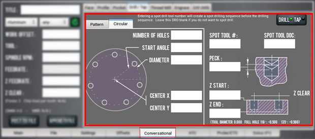

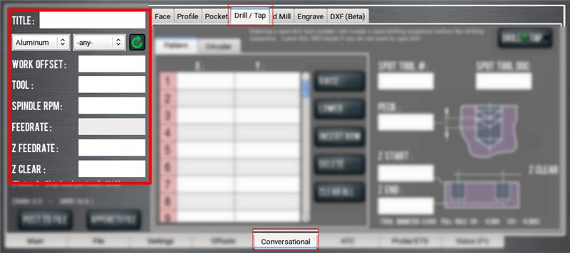

Create Hole Locations on a Part (Drill/Tap)
Using conversational programming, you can program PathPilot to make multiple holes on a part. For information, see "About Drilling and Tapping".
  • In the Conversational DROs group, the value in the Z Clear DRO field must be set to clear any obstructions between hole changes.
To make a specific hole pattern of evenly spaced holes around a circumference (also know as a bolt pattern):
  1. From the Conversational tab, select the Drill/Tap tab.
  1. From the Drill/Tap tab, select the Circular tab.
  2. In the Number of Holes DRO field, type the number of holes (greater than 0) required for the pattern.
  3. In the Start Angle DRO field, type the value of the angle from angle 0 (from -90 to 90).
  4. In the Diameter DRO field, type the size of the circular pattern (as defined by a line through the center point of each hole).
  5. In the Center X DRO field and the Center Y DRO field, type the location for the center of the hole.

To make a hole pattern based on X and Y locations on a part:
  1. From the Drill/Tap tab, select the Pattern tab.
  2. In the Location table, select the row, then select the cell to edit.
    Holes indicated in the Location table are completed from top to bottom.
  3. Depending on if you're drilling or tapping the holes, do one of the following:
Tips
  • To rearrange the row order, select a row, and then select Raise or Lower.
  • To clear all values in the table, select Clear All.
  • To make sure that the value is a valid number, leave the cell. If the value isn't a valid number, it's erased, and an error displays on the Status tab.
  • Before posting the file, make sure that there are none of the following:
    • X values without a Y value
    • Y values without an X value
    • An empty row before the last row with values
A drilling and tapping program is used to create a series of holes in defined locations on a part.
Drilling and Tapping in PathPilot
PathPilot has the following options to define the locations:
  • Pattern Use X and Y locations to make a list of hole locations.
  • Circular Use a circumference to make a specific pattern of evenly spaced holes.
For information on using conversational programming in PathPilot to drill and tap holes, see "Create Hole Locations on a Part (Drill/Tap)".
During a drilling routine, PathPilot uses one of the following canned G-code cycles, depending on the entries in each DRO field:
  • G81 Drill
  • G82 Drill with dwell
  • G83 Drill with peck
NOTE: The features can't be combined, because peck cancels dwell.
When using a tapping routine, PathPilot uses the G84 canned G-code cycle. G84 is similar to G81, but it commands a spindle reverse once it gets to the bottom of the hole.
It's important that the Z Feedrate matches the spindle RPM and tap pitch, so the rate is calculated from the Pitch and RPM DRO entries. The result is displayed in the Z Feedrate DRO (in the left panel) after the Enter key is selected in one of the RPM, Pitch, or TPU DRO fields.
NOTE: An auto-reversing tapping head typically uses a drilling cycle.
Create a Drilling Sequence
The Drill tab uses one of the following canned G8x cycles to drill a hole at each identified location:
  • G81 Drill
Hole depth is usually defined as the full diameter portion of the hole, so you may need to consider the Z length from the drill point to the corner.
  1. In the Spot Tool # DRO field, type the number of the spot drill.
    If a valid tool number is used in the Spot Tool # DRO field, PathPilot makes a spot drilling sequence before the drilling sequence. In the spot drilling sequence, PathPilot uses the values indicated in the Feedrate DRO field, the Spindle RPM DRO field, and the Z Clear DRO field.
NOTE: To skip a spot drilling sequence, leave the Spot Tool # DRO field blank.
  1. In the Spot Tool DOC DRO field, type the depth of cut for the spot drilling sequence.
NOTE: To skip a spot drilling sequence, leave the Spot Tool DOC DRO field blank.
  1. In the Peck DRO field, type the distance for each peck.
NOTE: Any entry greater than 0 typed in the Peck DRO field replaces G81 with G83 in the G-code. For information, see "Drilling and Tapping Reference".
  1. Set the parameters for the hole in the Z range:
    1. In the Z Start DRO field, type the location for the first Z pass.
    2. In the Z End DRO field, type the location for the last Z pass.
Create a Tapping Sequence
The Tap tab uses the G84 canned cycle — it's similar to the G81 drill cycle, but it commands a spindle reverse once it reaches the bottom of the hole.
NOTE: If you're using an auto-reversing tapping head, use a drilling sequence. Go to "Create a Drilling Sequence".
  1. In the Dwell DRO field, type the time — in seconds — for the tool to pause at the bottom of the hole before retracting.
    A dwell gives the tool time to completely cut the bottom of the hole.
NOTE: Any entry greater than 0 typed in the Dwell DRO field replaces G81 with G82 in the G-code — unless there is an entry greater than 0 in the Peck DRO field.
  1. Set the parameters for the threads: In the Pitch (In) DRO field or the Threads/In DRO field, type either the required pitch or the threads per inch.
NOTE: The Pitch (In) DRO field and the Threads/In DRO field are linked — after you type a value in one and press Enter on the keyboard, the other is auto-filled.
  1. In the Conversational DROs group, make sure that the value in the Z Feedrate DRO field is the same as the value that you set in Step 2.
  2. Set the parameters for the hole in the Z range:
PathPilot uses the following terms when drilling and tapping on a part in conversational programming:
  • Start Angle Specifies the angle from angle 0. Angle 0 is a base (horizontal) line from the center point going right (east) to the circumference. The angle from the base line can be:
    • Positive or negative
    • Up to 90 degrees (or -90 degrees)
      A negative angle produces a clockwise rotation; a positive angle produces a counterclockwise rotation.
    • Rotates the pattern either clockwise or counterclockwise
      For example, to create a hex pattern with flats on the top and bottom, use a value of 0 in the Start Angle DRO field. To create a hex pattern with flats on the left and right sides, use a value of 30 (or -30) in the Start Angle DRO field.
  • Peck The value isn't adjusted: the G83 routine feeds at the Z Feedrate, starting from Z Clear down to the Peck distance, then rapid retracts to Z Clear, and rapid returns to start the next Peck.
NOTE: The first and last peck will likely be shorter than the value typed into the Peck DRO field.

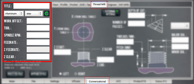

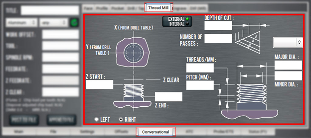

Create Threads on a Part
Using conversational programming, you can program PathPilot to take helical tool paths around a boss or inside a hole to create external or internal threads. For information, see "About Thread Milling".
  • The auto-filled DRO field values assume a full-form threaded tool. If you're using a fine-point threaded tool to cut coarse threads, you must modify the root diameter to account for the tool's smaller nose radius.
  • The value used in the Z Clear DRO field must be such that it can clear any blockages in the path between the end of one Z pass and the beginning of the next.
To create threads on a part:
  1. From the Conversational tab, select the Thread Mill tab.
  2. From the Conversational DROs group, set the parameters for the thread milling operation.
  1. Depending on the type of threads, do one of the following:
  • For external threading (creating threads on a boss, for example), select External.
  • For internal threading (creating threads inside a hole, for example), select Internal.
    1. From the Quick Reference drop-down, select the thread size.
      The Threads/In DRO field, Pitch (In) DRO field, Major Dia. DRO field, and Minor Dia. DRO field auto-fill.
NOTE: The threads listed follow the current unit setting: either inches (G20) or millimeters (G21).
b. In the Z Start DRO field, type the location of the first Z pass (where you want the thread to start).
c. In the Z End DRO field, type the location of the last Z pass (where you want the thread to end).
NOTE: The tool actually goes beyond the value entered in the Z End DRO field, due to the cutting tip width and the Z component of the compound feed angle and thread depth.
d. In the Depth of Cut DRO field or the Number of Passes DRO field, type a value to represent the amount of material to remove in each helical pass. For information, see "Thread Milling Reference".
NOTE: The Depth of Cut DRO field and the Number of Passes DRO field are linked — after you type a value in one and press Enter on the keyboard, the other is auto-filled.

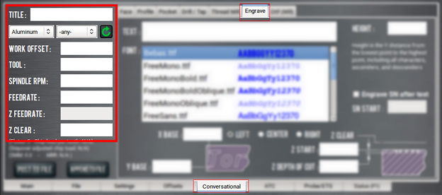

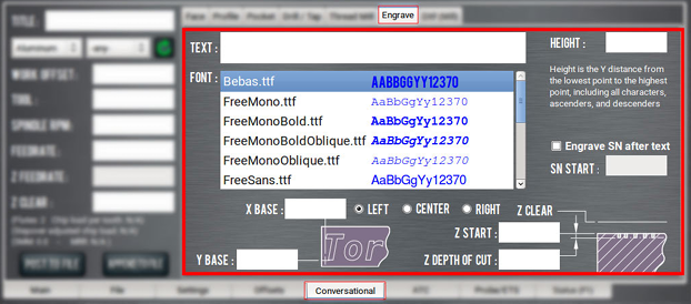

Create Text to Engrave on a Part
Using conversational programming, you can program PathPilot to engrave a single line of text on a part. For example, you could use this feature to engrave True Type stick or outline fonts into things like simple plaques, control panels, or data plates. For information, see "About Engraving".
To create an engraving sequence on a part:
  1. From the Conversational tab, select the Engrave tab.
  2. From the Conversational DROs group, set the parameters for the engraving operation.
    1. In the Text DRO field, type the desired text to engrave.
      The text appears in the Preview window.
b. From the Font list, select the desired font for the engraved text.
NOTE: To search the Font list, select a font and begin typing the font's name. PathPilot scrolls to the result.
The Preview window updates to display the font selected.
NOTE: You can add True Type font files to the PathPilot controller. For information, see "Transfer Files to and From the Controller".
c. Use the Alignment radio buttons to select the desired alignment of the text: either Left, Center, or Right.
d. In the Height DRO field, type the distance in the Y direction from the top of the text to the bottom of the text.
PathPilot uses the height value, along with font data, to calculate scale for character paths in the G-code program.
NOTE: The value typed in the Height DRO field includes ascenders and descenders, but no the tool cutting diameter. For a more accurate value, subtract the diameter from the overall height.
e. In the X Base DRO field and the Y Base DRO field, type the location of the left side of the first character’s baseline.
NOTE:   If any characters in the text have descenders, like y or g, they extend below the baseline.
f. In the Z Start DRO field, type the location of the surface on which to engrave.
g. In the Z Depth of Cut DRO field, type the desired depth the that the cutting tool is fed into the workpiece.
h. In the Z Clear DRO field, type the value for the tool to move or retract to — in the Z direction — at the start and end of the engraving sequence and between characters.
About Engraving

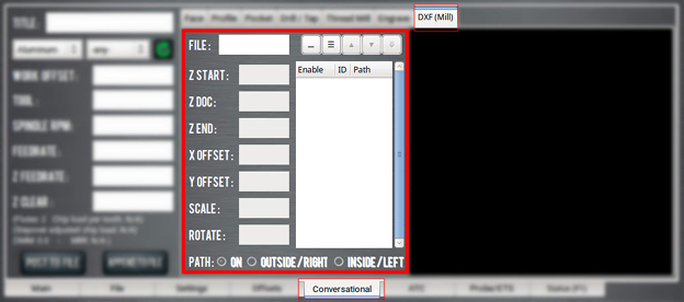

Import a DXF File
  1. Select the File DRO field.
Example

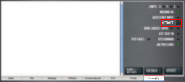

Enable an Internet Connection
If desired, you can enable an internet connection on your PathPilot controller. An internet connection allows you to receive automatic PathPilot updates and transfer files with PathPilot Hub instead of a USB drive.
  1. Once connected, you can use the PathPilot Hub and automatic updates features.

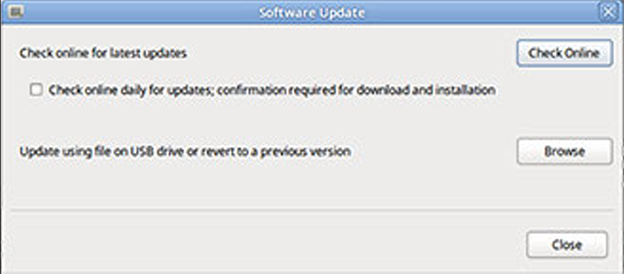

Enable Automatic Updates
To enable automatic updates:
  2. Select Close.

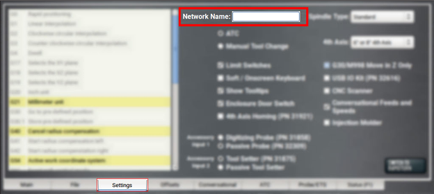

Change the Network Name
To change the network name:

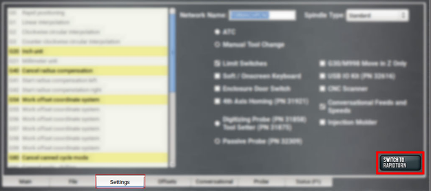

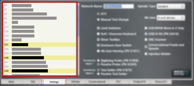

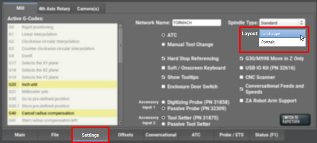

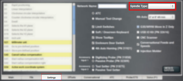

Select the Spindle Type
If you have an additional spindle (separate from the standard spindle), you must first select it in PathPilot.
To select the spindle type:
  • From the Settings tab, from the Spindle Type drop-down, select the appropriate spindle option.

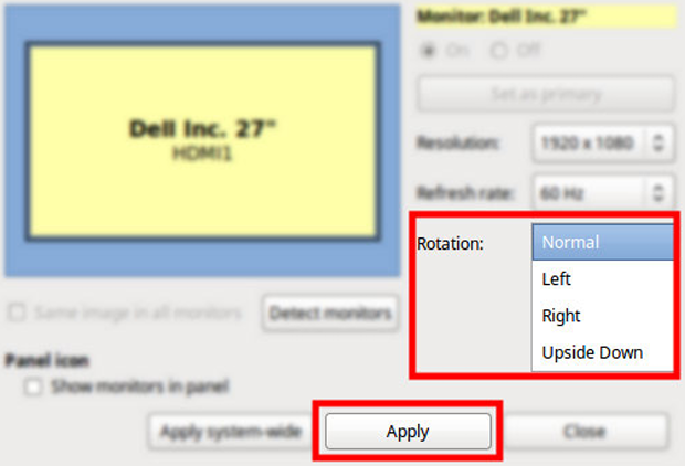

Change the Screen Orientation
About Portrait Screen Layout

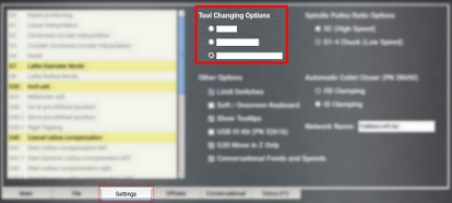

About Automatic Tool Changes
If you're using an Automatic Tool Changer (ATC) to make tool changes, PathPilot does the following:
  1. Looks for an ATC.
    In the PathPilot interface, the ATC tab displays.
  2. When PathPilot finds a Txx M06 command in the G-code program, the ATC loads the specified tool into the spindle.
About Manual Tool Changes
If you're making manual tool changes, PathPilot pauses when it finds an M06 command in the G-code program. While it's paused, PathPilot does the following:
  1. The Cycle Start button flashes.
  2. The Tool Path display shows the requested tool number.

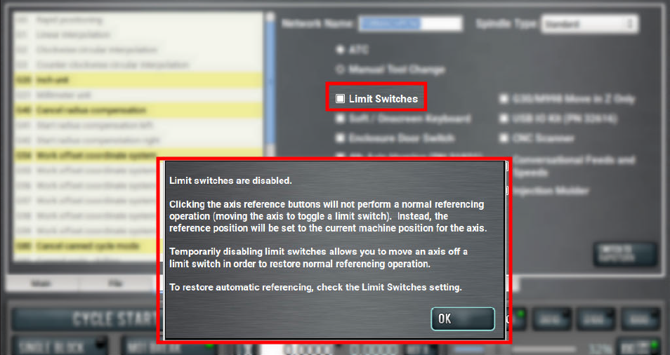

Disable Limit Switches
To provide a temporary workaround for a malfunctioning limit switch circuit, you can disable the limit switches. For information, see “About Limit Switches”.
NOTE: By default, the Limit Switches checkbox is selected.
To disable limit switches:
  1. From the Settings tab, clear the Limit Switches checkbox.
  1. Select OK.
In the PathPilot interface, on the Settings tab, the Limit Switches checkbox is selected by default. If the checkbox is cleared, the machine completes a unique referencing procedure after selecting Ref X, Ref Y, Ref Z, and Ref A: rather than moving each axis to the end of its travel, the reference position is set as the machine's current position. This is useful for troubleshooting: if the limit switches are disabled, you're able to move the axis off of its limit switch.

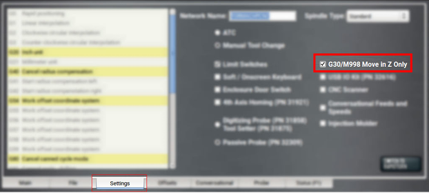

Limit G30 Moves
To limit G30 moves:
About G30

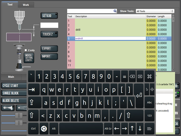

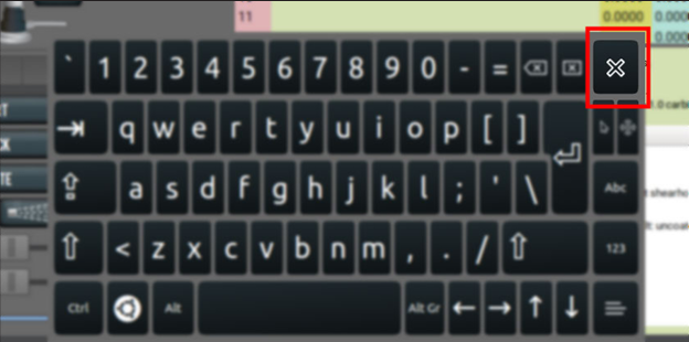

Enable the On-Screen Keyboard
About Soft Keyboards

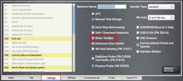

Enable Tooltips
  2. Open the enclosure doors.
    The doors unlock.

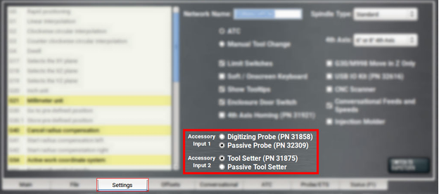

Specify Probing and Tool Measuring Options
If you have any of the following accessories, you must first specify which you're using in the PathPilot interface:
To specify a probe or a tool setter:
  • From the Settings tab, select the correct probing or tool measuring options for both Accessory Input 1 and Accessory Input 2.
Use the RapidTurn Interface
If you have a RapidTurn, you must first change the PathPilot interface.
To use the RapidTurn interface:
  • From the Settings tab, select Switch to RapidTurn.
The PathPilot interface for the mill closes, and the PathPilot interface for the RapidTurn opens.

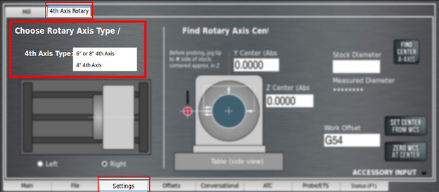

Specify the 4th Axis Rotary Type
To select the 4th axis that you're using:

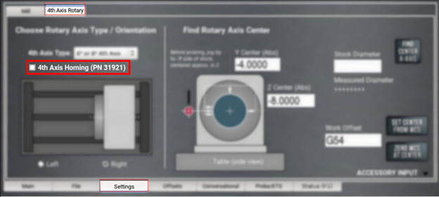

Enable the 4th Axis Homing Kit
If you have a 4th Axis Homing Kit (PN 31921), you must first enable it in the PathPilot interface.
To enable the 4th Axis Homing Kit:
  • From the Settings tab, select the 4th Axis Rotary tab. Then, select 4th Axis Homing (PN 31921).

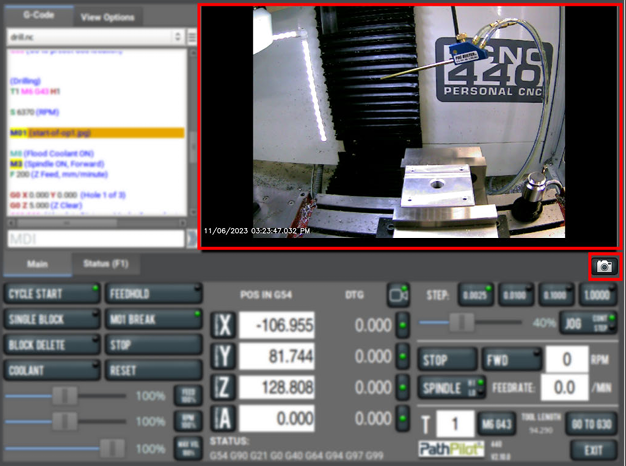

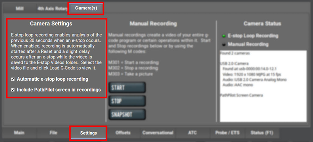

Use a USB Camera
About USB Cameras
Manual Recording
    The Main tab displays.
To view E-stop videos:
Review Video and Image Files
File Naming Convention
File Name
Description of File
Left Bracket Op1_0.mp4
Camera 0 mp4 video file
Left Bracket Op1_0.log
Left Bracket Op1_1.mp4
Camera 1 mp4 video file
Left Bracket Op1_1.log
Left Bracket Op1_PP.mp4
Left Bracket Op1_PP.log
G-Code Commands
File Naming Conventions
File Name
Description of File

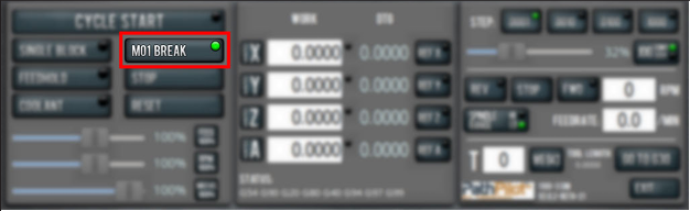

Use M01 to Take Pictures
To use M01 to take pictures:
  2. Run the G-code program.

Use a Probe with PathPilot
Use the Probe tab in the PathPilot interface to automate functions with a probe.
Set Up the Probe
Before using the functions on the Probe tab, you must first do the following:
  1. Verify that tool number 99 (the probe tool) is in the spindle.
  2. Disable the spindle to prevent any accidental spindle starts with the probe in the spindle.
  3. Verify that the feed rate is appropriate for probing moves.
NOTE: All probing moves occur at a feed rate specified by the DRO fields on the Probe Setup tab.
  1. Press the probe tip and make sure that, from the PathPilot interface, on the Probe tab, the Accessory Input light comes on.
    This indicates that the probe polarity is correctly specified.
    If the Accessory Input light does not come on, you must change the probe polarity setting. For information, see "Specify Probing and Tool Measuring Options".

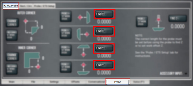

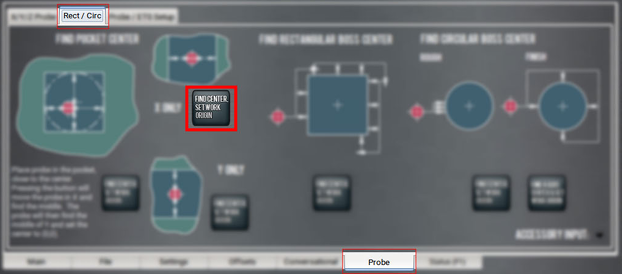

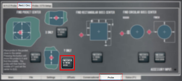

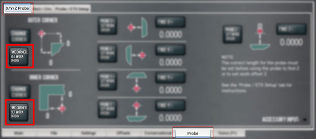

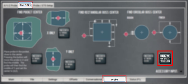

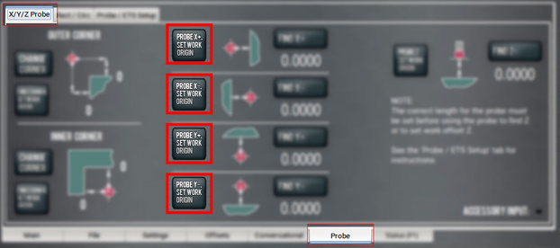

Use a Probe to Find a Feature's Location
To find the location of a workpiece or vise in the current work offset coordinates:
  1. From the PathPilot interface, on the Probe tab, select the X/Y/Z Probe tab.
  2. Position the probe near the workpiece or vise.
  3. One at a time, select Find X+, Find X-, Find Y+, Find Y-, or Find Z-.
The axis is probed, and the location of the probed surface is displayed.

Set the X and Y Work Offset Zero on the Corner of a Feature
  2. Position the probe so that it is below the surface of the feature and 1 in. away from the vice jaw corner in the X and Y directions.
  3. Select Find Corner, Set Work Origin.
The axes are probed, and the location of the probed surface is set as the current work offset's X/Y origin.
NOTE: Select Change Corner to change the corner on which to probe.
Set the Work Offset Zeroes on a Feature
  3. One at a time, select Probe X+, Set Work Origin, Probe X-, Set Work Origin, Probe Y+, Set Work Origin, Probe Y-, Set Work Origin, or Probe Z-, Set Work Origin.
The axis is probed, and the location of the probed surface is set as the current work offset's origin.

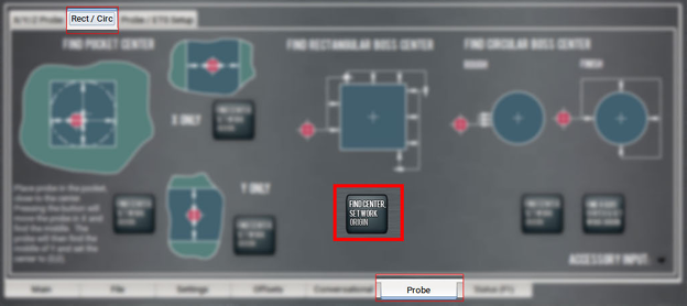

Use a Probe to Find the Center of a Feature
You can find the center of a pocket, slot, or boss on a part using a probe.
Find the Center of a Pocket
  1. From the PathPilot interface, on the Probe tab, select the Rect/Circ tab.
  2. Position the probe near the center of the pocket.
  3. Select Find Center, Set Work Origin as shown in the following image.
Find the Center of a Slot
  2. Position the probe near the center of the slot.
  3. Depending on the slot, do one of the following:
    1. To probe the slot in the X direction only, select Find Center, Set Work Origin as shown in the following image.
b. To probe the slot in the Y direction only, select Find Center, Set Work Origin as shown in the following image.
Find the Center of a Rectangular Boss
  2. Position the probe below the top surface of the boss and on the left-hand side.
The probe moves around the edge of the workpiece to find the center.
Find the Center of a Circular Boss
The probe moves around the workpiece three times to determine the approximate center of the curve, and then makes four additional move to confirm the center of the circle.
Find the Center Rotation of an A-Axis
  2. Position the probe directly above the A-axis center of rotation.
  3. Select Find A Axis Center & Set Work Origin.
The probe moves around the round workpiece mounted in the A-axis to find the center rotation of the A-axis.

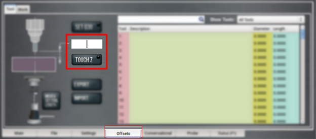

Set Tool Length Offsets

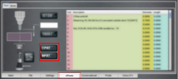

NOTE: You can import a .csv file with tool length offset data. For information, see "Import and Export the Tool Table".
To set tool length offsets:
    For information, see “Set Up Tooling”.
About Tool Offsets
Set a Known Reference Height
  8. While moving the paper back-and-forth across the reference surface, slowly step the Z-axis down (-Z) until you feel a light pull on the piece of paper. This indicates that the paper is contacting the spindle.
  1. Select Touch Z.
  4. Jog the Z-axis up (+Z).
Set up the Electronic Tool Setter (ETS)

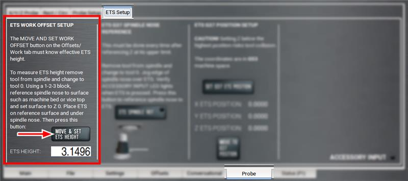

Set the ETS Height
To set the ETS height:
    For information, see “Set a Known Reference Height”.

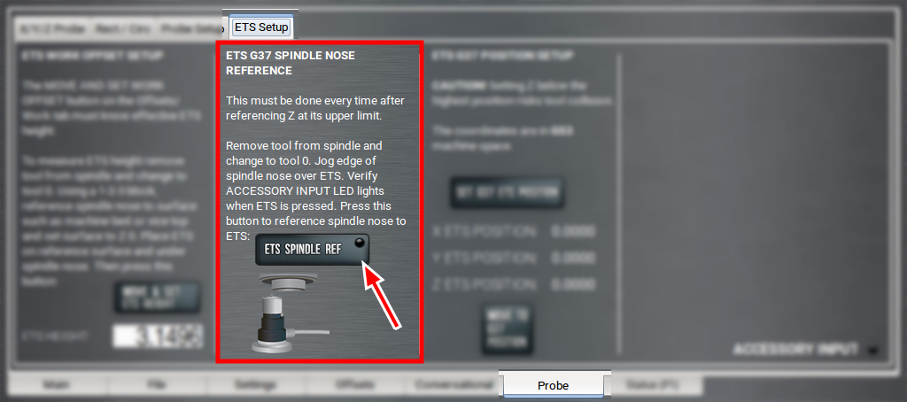

Reference the Spindle Nose
  2. Remove the toolholder from the spindle.
  3. From the PathPilot interface, in the Tool DRO field, type 0. Then select the Enter key.
  4. Jog the spindle until it's over the ETS. Then, slowly jog the Z-axis down (-Z) toward the contact pad on the ETS.
  5. From the PathPilot interface, on the ETS Setup tab, find the ETS G37 Spindle Nose Reference section, and select ETS Spindle Ref.

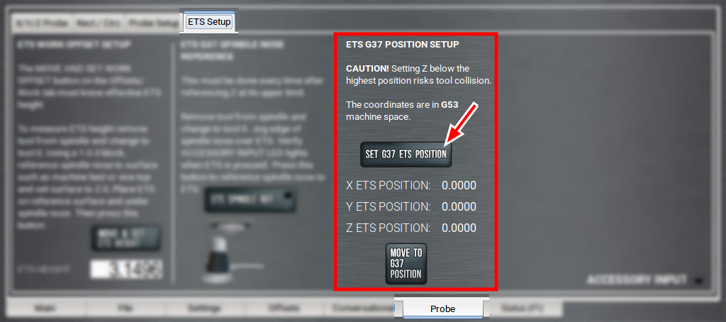

Set the G37 Position
  1. Remove toolholder from the spindle.
The G37 position is now set.

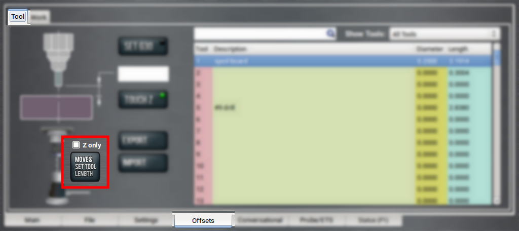

  1. On the Offsets tab, find the Move and Set Tool Length button and the Z only checkbox. Verify that the checkbox is cleared, and then select Move and Set Tool Length.
Note: You should only use the Z only checkbox to manually measure tools with a larger diameter. When it’s selected, the machine doesn’t go to the G37 position - instead, it just moves straight down (Z-) to measure the tool.
The machine moves to the G37 position and measures the tool with the ETS.
Note: Regardless of the initial feed rate, the final touch off feed rate while using and ETS is 2-1/2 in. per minute (IPM).

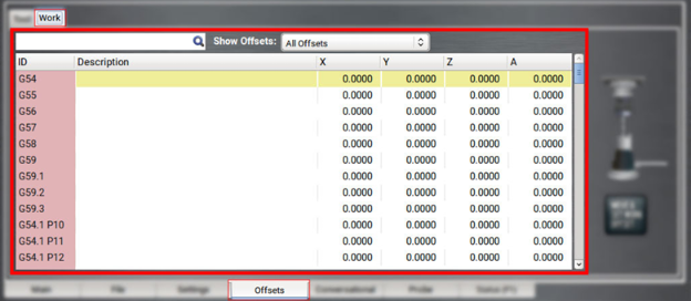

Set Work Offsets

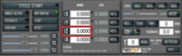

  • Select Zero [Axis].
To change work offsets:
    1. The Status read-only DRO field.
    2. Above the Work Offset DRO fields.
About Work Offsets
Work Offset Naming
Offsets 1-9 (Use either name)
Offset

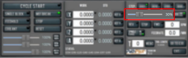

To set the velocity:
  • Drag the Jog Speed slider.

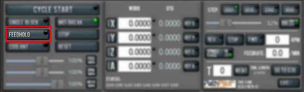

Use the Feed Hold Function
  • Select Feed Hold.
About Feed Hold

Use M01 Break Mode
  • Select M01 Break.
About M01 Break
  • In the same folder as the G-code program
  • In an images folder within the G-code program's folder
  • In an images folder within the home directory
  1. Program an M00 or M01 break, and, using parentheses, type the full file name of the image (including its extension).
Example
M01 (Op1_Setup.jpg) displays the image file on the Tool Path display.

Capture Images with a USB Camera
To us M01 to take pictures:
  3. When PathPilot executes the M01 it looks to see if the comment contains a file.
    1. If there isn’t a file name: The comment is shown as instructional text across the tool path.

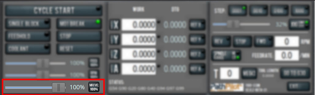

  • Select Maxvel 100%.
About Maxvel Override

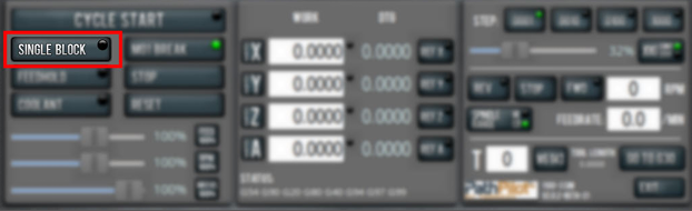

Use Single Block Mode
  • Select Single Block.
About Single Block

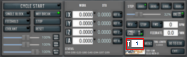

Change the Tool Number
  1. In the Tool DRO field, type a number (the valid range is from 0-1000). Then select the Enter key.
NOTE: You can also select M6 G43. For information, see "About M6 G43".

Manually Enter Commands
To manually enter commands:
The DRO field highlights.
  1. Type the command.
About the MDI Line DRO Field

  • Spindle RPM
  • Feedrate
  • Z Feedrate
  • Depth of Cut
  • Stepover
  • Peck (if drilling)
Refresh DRO Field Values
Use Additional Provided Information
The following tips are displayed based on the calculations that PathPilot is performing:
  • Chip Load Information Chip load — the amount of material removed per tooth — is based on the number of flutes, RPM, and feed rate.
    As the stepover value decreases, the actual chip load decreases. If the stepover is too small, the cutter may not have enough contact with the material to cut — effectively resulting in premature tool wear.
  • Cutting Speed Information Cutting speed is the speed that a given tooth (flute) on the cutter will be moving when it cuts through the material. All materials have a documented cutting speed.
    In imperial units, cutting speed is measured as surface feet per minute (SFM).
    In metric units, cutting speed is measured as surface meters per minute (SMM).

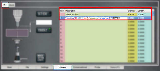

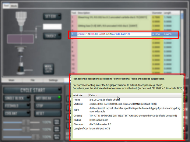

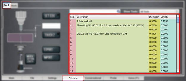

Create Tool Descriptions
  1. From the PathPilot interface, on the Offsets tab, identify the Tool Table window.
  2. Select a blank line.
Examples
Example
Dia:.3125 4FL R:03 AlTiN CRB variable loc:.75
  • 0.3125 tool diameter
  • Four flutes
  • 0.03 radius, or "bullnose"
  • Carbide
  • Variable helix
  • 0.75 length of cut (loc)
Example
Gold colored end mill from middle drawer
This description provides very little information, and PathPilot defaults to basic cutter features:
  • Two flutes
NOTE: If you don't know the part number, you can search for the tool at http://tormach.com .
  2. Type the part number for the tool, like 35571.
Tool Keywords Reference
Item
Pattern
Example
Notes
type
Drill, Ball, Flycut, Drag
flutes
4FL, 12FL, 2flute
length of cut (or flute length)
loc:0.875
tool coating
TiN, ZrN, TiB2
No coating is specified same as “uncoated.”
tool diameter
Diameter:.0341, dia:.750
tool material
HSS, CoHSS, crb
No tool material is specified the same as HSS (high-speed steel).
tool radius
R:.02, radius:0.02

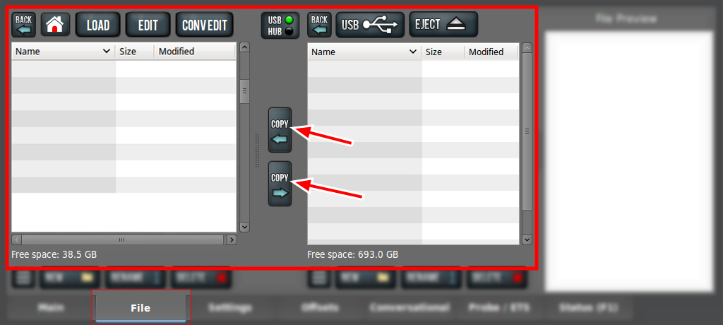

System File Management
Manage System Files
Use the File tab to manage system files on the PathPilot controller. For information, see "Transfer Files to and From Controller".
To manage system files:
    • Select a file, and go to the Options
      menu. Then, select Copy, Cut, or Paste.
  • Select Back or Home.
Create Backup Files
  2. Select Save.
  • logfiles
  • media
  • ReleaseNotes
  • subroutines
  • USB
  1. Select Copy to USB.
About Backup Files
Restore Backup Files
  2. Select Copy From USB.
Import a .csv File
  2. Select Save.
  4. Select Eject.
