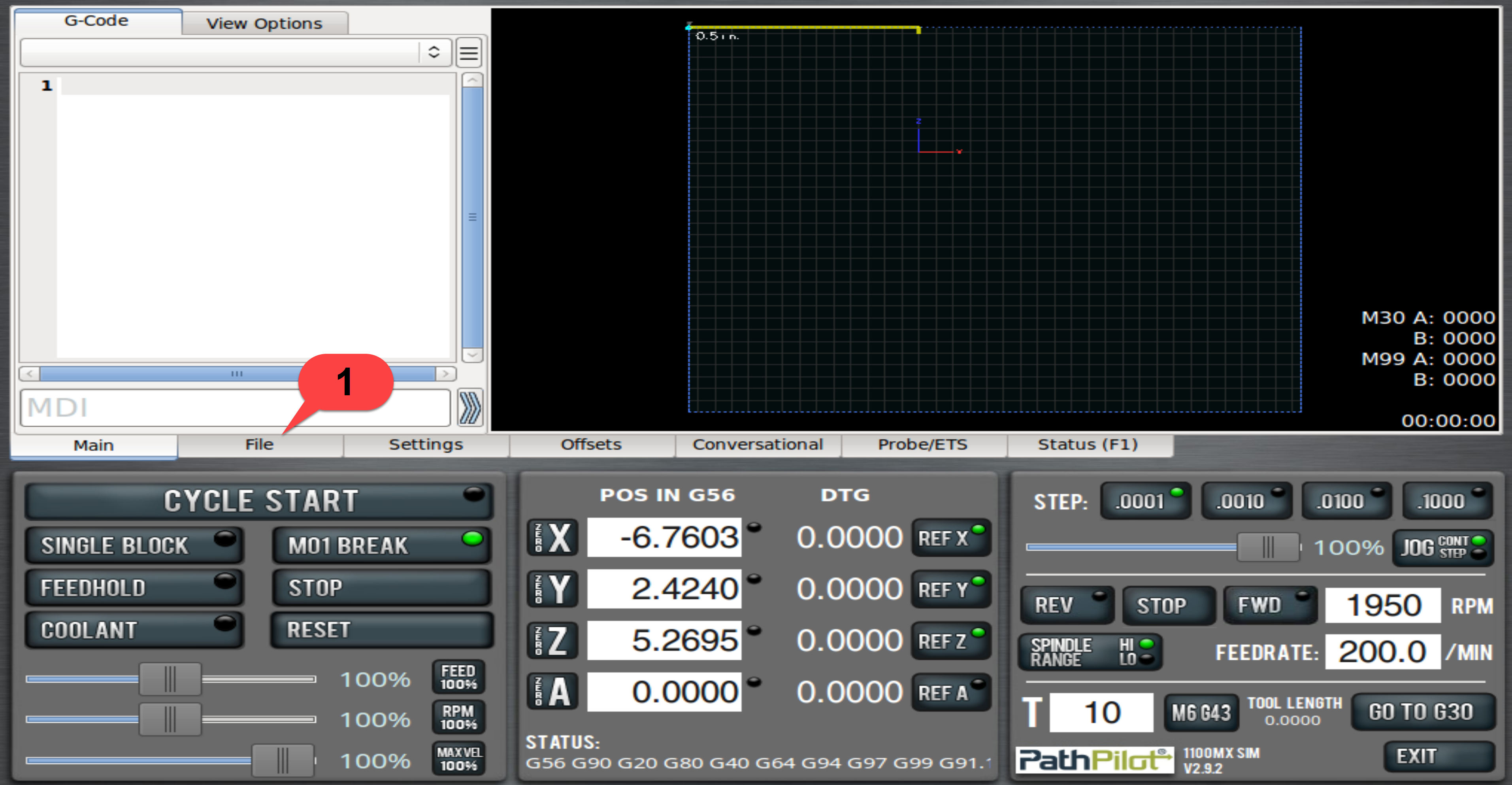

Click the file tab in PathPilot.

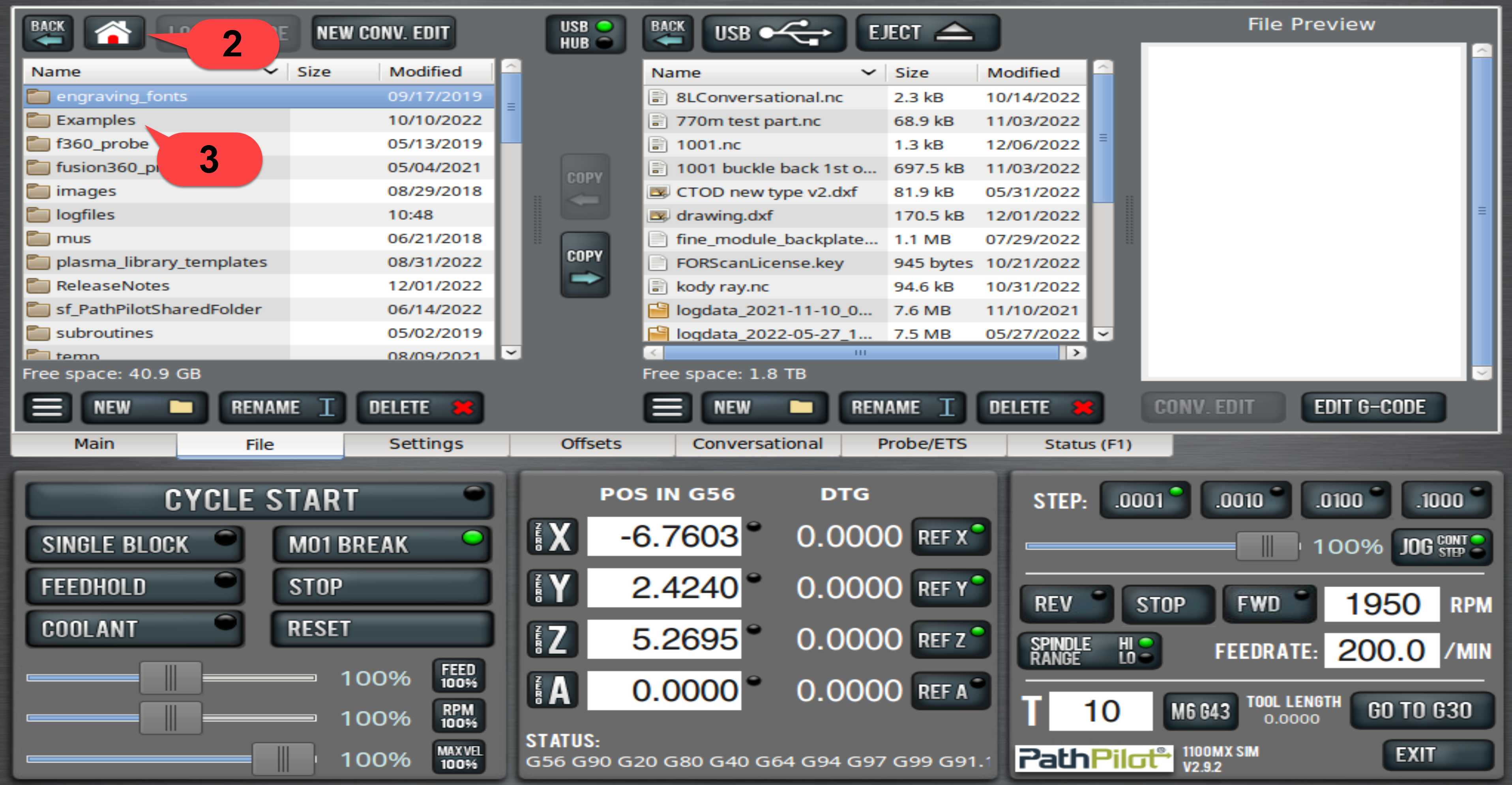

Click the Home button to come back to the main file directory. Then, locate the Examples folder, and double click.

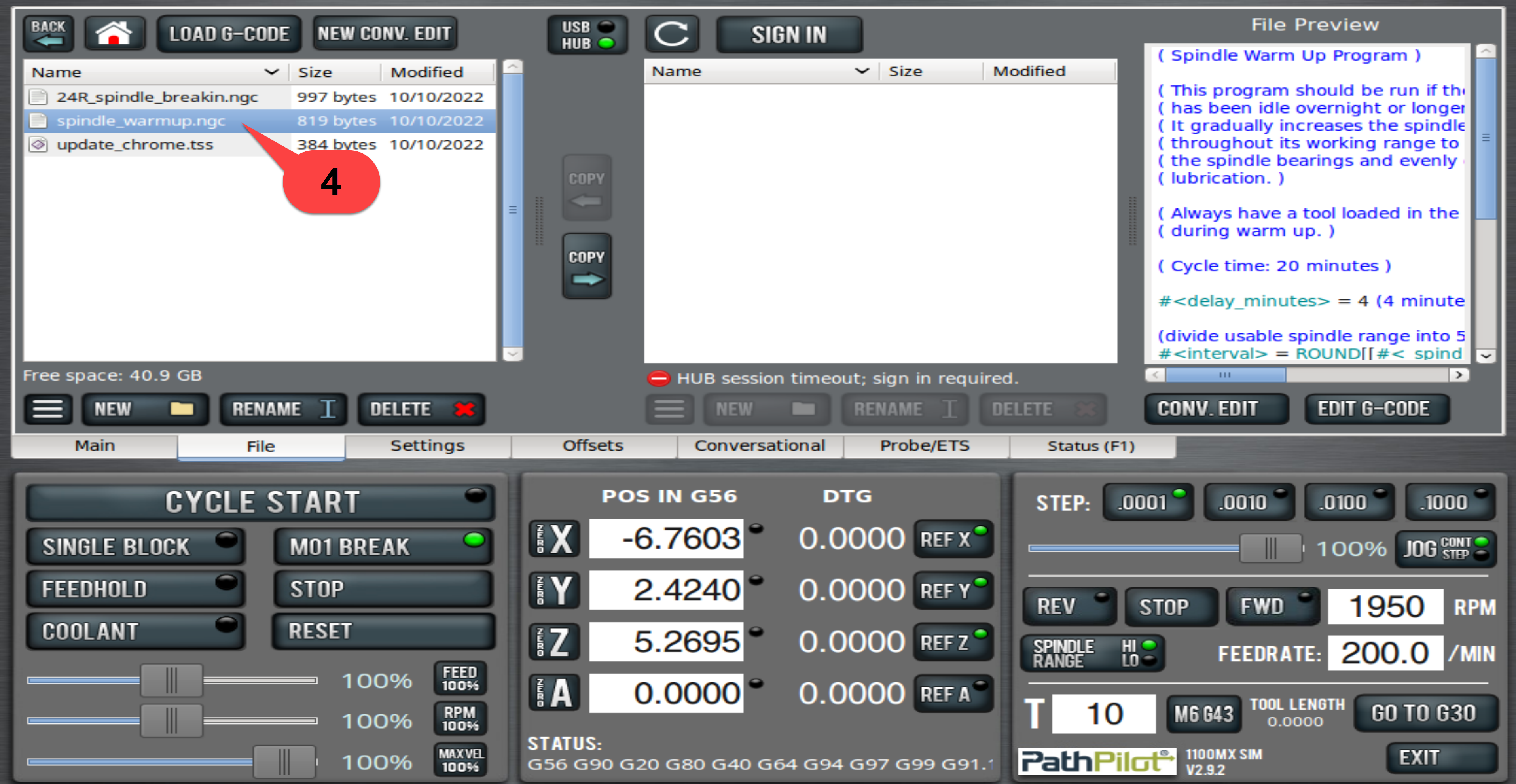

Locate the spindle_warmup.ngc file, and load the program. This warm up program will run for twenty minutes. Please see the embedded program notes before running.
