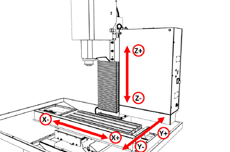

Axes
The machine has three linear axes of motion, and one optional rotary axis, used for machining:
  • The X-axis, which is (horizontally) along the long side of the machine table.
  • The Y-axis, which is (horizontally) along the short side of the machine table.
  • The Z-axis, which is (vertically) along the mill column.
  • (Optional) The A-axis, which is the axis of rotation that is typically aligned to the X-axis.
Figure 1: Axis directions on the machine.
Each axis has a different limit of travel, which is the distance it moves before reaching a limit switch:
  • X-Axis 18" (457 mm)
  • Y-Axis 11" (279 mm)
  • Z-Axis 16.25" (413 mm)
