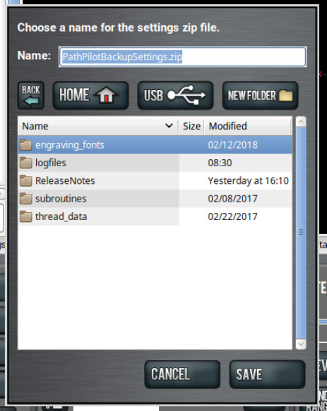

  2. From the PathPilot interface, on the Main tab, in the MDI Line DRO field, type ADMIN SETTINGS BACKUP.
    Then select the ENTER key.
Admin Settings Backup dialog box
  1. From the Admin Settings Backup dialog box, specify where (on the PathPilot controller or on a USB drive) to save the backup .zip file.
  2. Select Save.

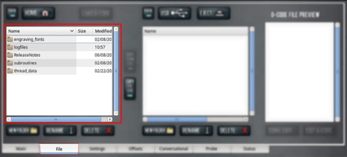

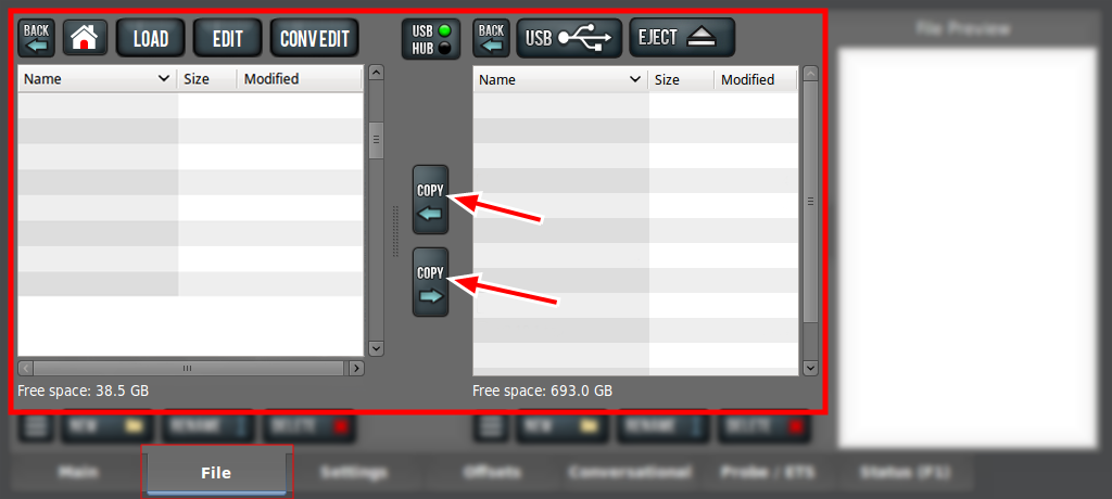

  3. If you saved the backup .zip file on the PathPilot controller, you must transfer it – along with other files you want to backup (like G-code programs) – to a USB drive. From the PathPilot interface, on the File tab, in the Controller Files window, select the backup .zip file and any other files you want to back up.
Controller Files window on the File tab
NOTE: Files must have unique names. If they don’t, PathPilot prompts you to overwrite or rename files, or cancel the file transfer.
  1. To prevent errors, make sure you don’t include the following folders:
  • logfiles
  • media
  • ReleaseNotes
  • subroutines
  • USB
  1. Select Copy to USB.
    The files are copied and display in the USB Files window.

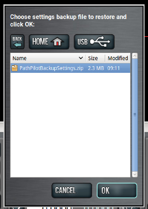

  2. From the PathPilot interface, on the Main tab, in the MDI Line DRO field, type ADMIN SETTINGS RESTORE. Then select the Enter key.
Admin Settings Restore dialog box
  1. From the Admin Settings Restore dialog box, navigate to the backup .zip file on the USB drive, and then select OK. The PathPilot operating system restores the backup, then restarts.
USB Files window on the File tab.
NOTE: To navigate backward, select Back. To navigate to the top level, select USB.
  2. Select Copy From USB.
