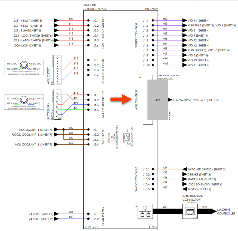

Reseat the Connectors on the Machine Control Board and Motors
  1. Inspect the stepper driver controller lights.
    1. Some controller lights are on: One Axis Won't Move (or Only Moves in One Direction), and Other Axes Move - 1100M .
    2. All the controller lights are off: Continue to the next step.
  2. Power off the machine.

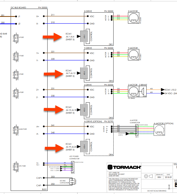

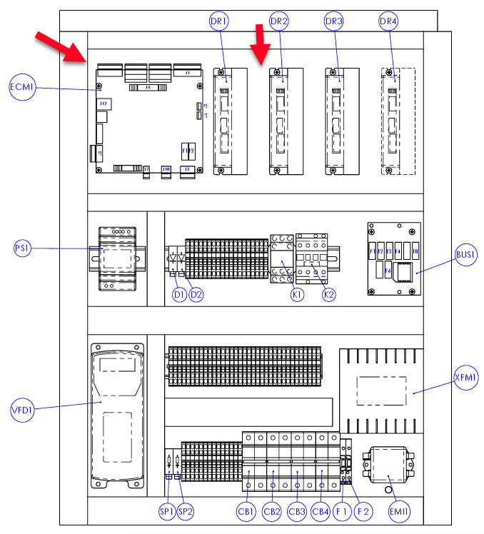

  3. Examine the data cable at the machine control board and the axes drivers.
      1. 423.1 (X-axis)
      2. 423.2 (Y-axis)
      3. 423.3 (Z-axis)
M Axis Drivers
M ECM Board
1100M ECM Board and Driver Locations
      1. 210/211 (X-axis)
      2. 220/221 (Y-axis)
      3. 230/231 (Z-axis)

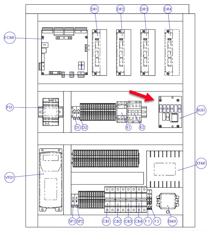

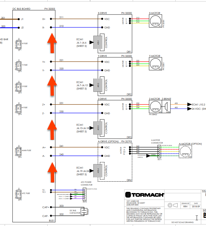

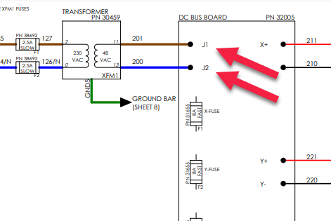

Inspect the DC-BUS board
Reason: The DC-BUS or DC power supply is malfunctioning.
    1. If it does: The stepper driver controllers will be illuminated, if the DC Bus Axis Fuses are not blown. To learn how to check individual fuses, see: One Axis Won't Move (or Only Moves in One Direction), and Other Axes Move - 1100M | Inspect the DC BUS board
    1. 200 (J2)
    2. 201 (J1)
  5. Continue to the next troubleshooting topic.

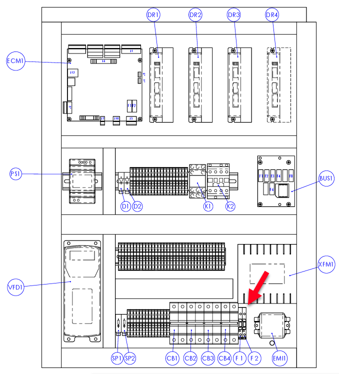

Inspect the XMF1 Transformer
Reason: The fuse(s) have blown.
  1. Power off the machine.
  2. Remove and measure the resistance across the F1 then F2 fuses with digital multimeter set to resistance.
    1. Replace the fuses if the digital multimeter reads OL, shows a resistance in the MΩ, and/or doesn’t produce continuity tone.
    2. If the fuses measures 0-5 Ω reinstall them.
1100M F1 and F2 Fuse Location

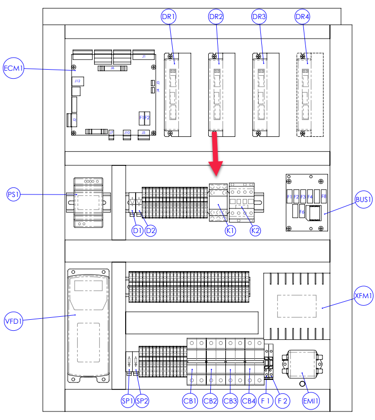

Check the K1 Contactor
Reason: The K1 is defective.
  2. Inspect the K1 for an illuminated red LED that indicates it has power.
    1. If the light is on: The K1 is latched. Using a digital multimeter set to Vac, measure for 220 Vac between:
      1. 114N
      2. 115
    2. If the light is not on: Continue to the next step.
      M Electrical Cabinet K1 Location
  3. Press and hold the Reset button on the operator box and observe the K1 LED. Then release the Reset button and observe the K1 LED.
    1. If the light only stays on when the button is pressed: There is a loose coil wire, short, or the K1 has malfunctioned.
    2. If the light never comes on: See Machine Won't Power On - 1100M
