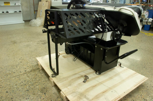

  2. Open and disassemble the machine's shipping crate with snips and a pry bar. Start with the top and follow by the four sides.
  3. Remove the plastic machine wrap and discard. When finished, the contents will look similar to the following image.
Figure 1: Bandsaw after opening the shipping crate.
