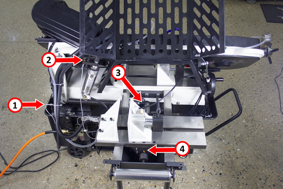

To properly validate the installation of your machine, you must verify that the proximity sensors are correctly installed, and that their wiring is free of knots or obstruction.
To verify the proximity sensor installation:
  1. Find the four proximity sensors on the machine as shown in the following image.
Figure 1: Proximity sensors on the bandsaw.

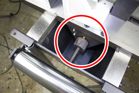

  1. Inspect each proximity sensor to verify that there's a 0.55 mm to 0.75 mm gap.
Figure 2: Proximity sensor.
  1. Verify that all proximity sensor wires are neat and secure, and that none are pinched or have kinks.
