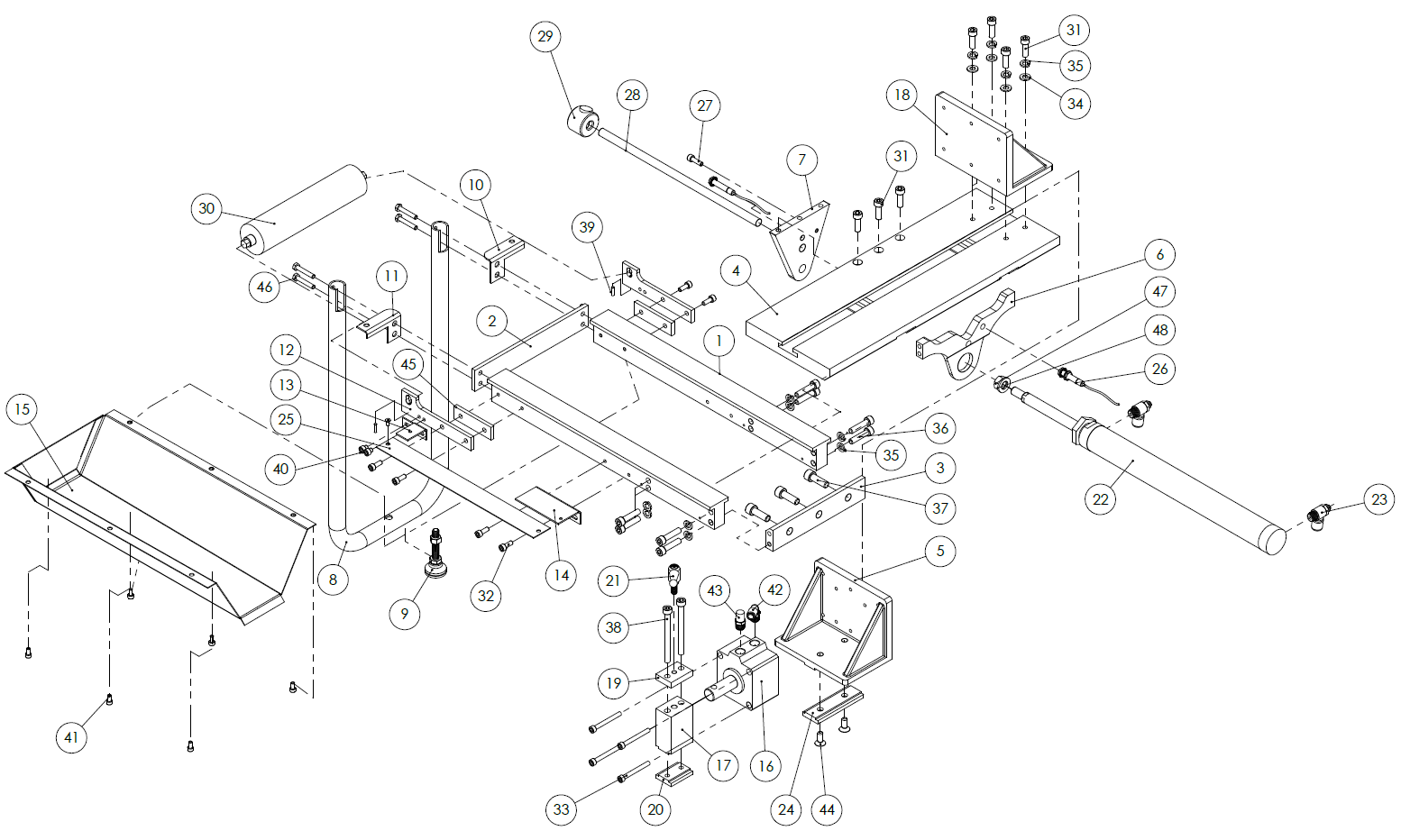

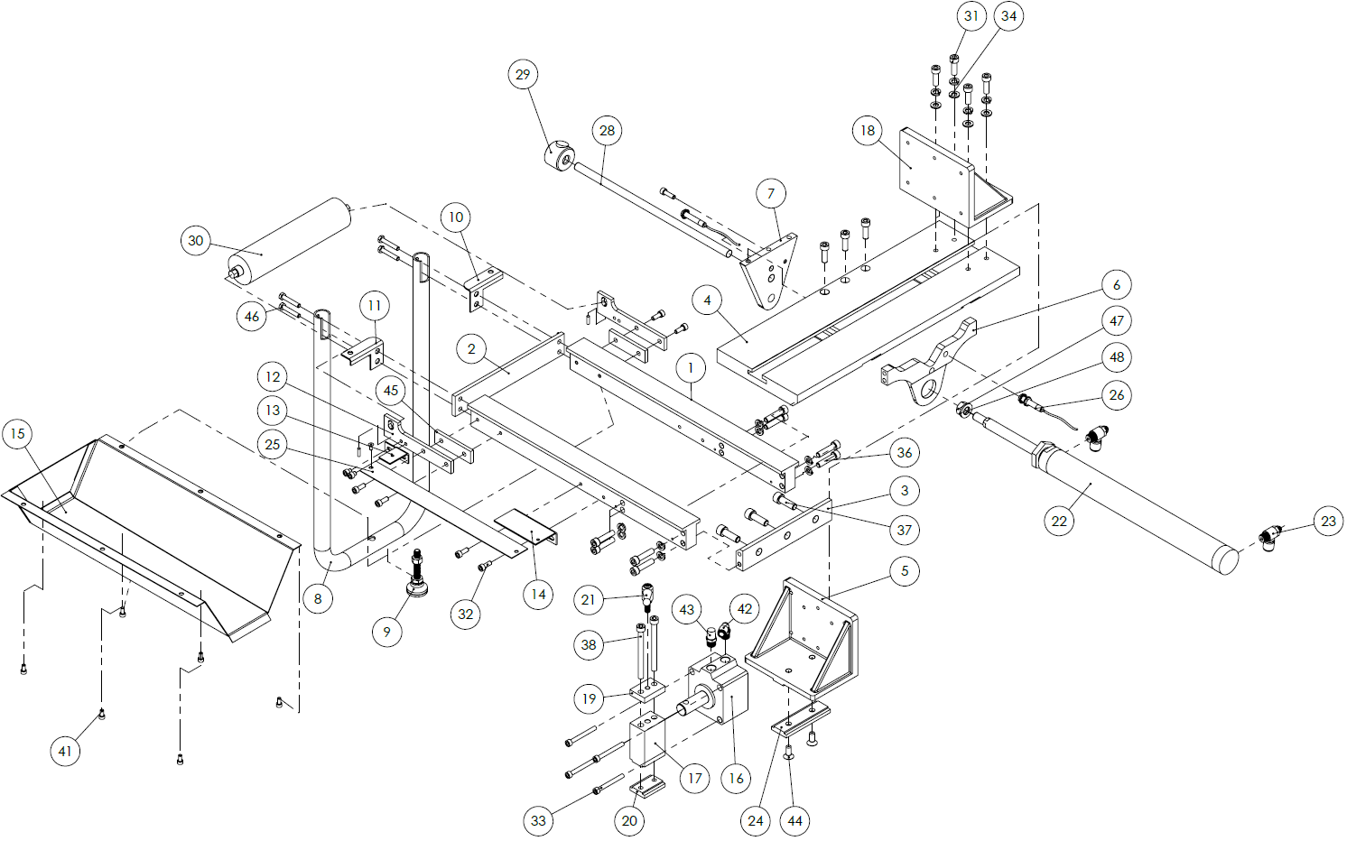

Infeed Table Exploded View - AF50
Alternative Part Numbers
Infeed Guide Rail*
Infeed End Plate A*
Infeed End Plate B*
Infeed Table*
Infeed Movable Jaw*
Infeed Air Cylinder Mount (PN 38007)
Infeed Table Bracket*
Infeed Support Leg (PN 38015)
Infeed Leveling Foot (PN 38016)
Motion Guard Support — Back*
11
Motion Guard Support — Front*
12
Infeed Roller Bracket*
13
Scale Mounting Bracket — Outboard*
14
Scale Mounting Bracket — Inboard*
15
Infeed Table Bottom Cover (PN 38020)
16
60 mm Air Cylinder (PN 38068)
17
Clamp Block — Infeed Table*
18
Infeed Fixed Vise Jaw*
19
Top Plate — Clamp Block*
20
Clamp Block T-Nut*
21
M8 × 1.25 Clamp Handle*
22
Infeed Air Cylinder — Body (PN 38069)
23
3/8 in. - 1/4 in. NPT Flow-Control Elbow*
24
Clamp Jaw T-Nut*
25
Stainless Scale*
26
Proximity Sensor (PN 38065)
27
Screw, Socket Head Cap, M06 × 1 - 20 mm
McMaster-Carr: 91290A326
28
M12 × 3 - 330 mm Acme Length Adjustment Screw (PN 38093)
29
M12 × 3 Acme Speed Nut Body (38092)
30
Roller — Infeed Table*
31
Screw, Socket Head Cap, M08 × 1.25 - 25 mm
McMaster-Carr: 91290A432
32
Screw, Socket Head Cap, M06 × 1 - 16 mm
McMaster-Carr: 91290A321
33
Screw, Socket Head Cap, M06 × 1 - 55 mm
McMaster-Carr: 91290A342
34
Washer, Flat, M8
McMaster-Carr: 91166A270
35
Washer, Split Lock, M8
McMaster-Carr: 93837A230
12
36
Screw, Socket Head Cap, M08 × 1.25 - 35 mm
McMaster-Carr: 91290A438
37
Screw, Socket Head Cap, M10 × 1.5 - 30 mm
McMaster-Carr: 91290A522
38
Screw, Socket Head Cap, M08 × 1.25 - 90 mm
McMaster-Carr: 91290A466
39
Screw, Cone Point Set, M4 × 0.7 - 16 , 90°
McMaster-Carr: 91210A117
40
Screw, Socket Head Cap, M06 × 1 - 6 mm
McMaster-Carr: 91290A310
41
Screw, Socket Head Cap, M05 × 0.8 - 10 mm
McMaster-Carr: 91290A224
42
5/16 in. - 1/4 in. NPT Push-to-Connect Elbow (PN 38097)
43
1/4 in. NPT Muffler (PN 38098)
44
Screw, Socket Head Countersunk, M8 × 1.25 - 20 mm
McMaster-Carr: 91294A284
45
Infeed Roller Spacer Plate*
46
Screw, Hex Head Cap, M06 ×1 - 35 mm
McMaster-Carr: 91310A341
47
Nut, Hex, M12
McMaster-Carr: 90591A181
48
Washer, Flat, M12
McMaster-Carr: 91166A290
