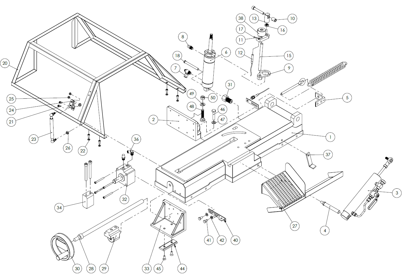

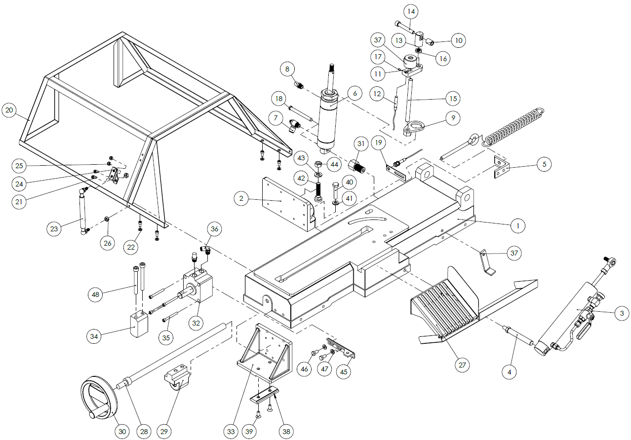

Base Casting Exploded View - AF50
Alternative Part Number
Base Casting*
Rear Vise Jaw*
Hydraulic Descent Cylinder (Feed) (PN 38035)
Feed Cylinder Axle*
Spring Handle Bracket*
Lift Cylinder (PN 34928)
3/8 in. - 1/4 in. NPT Flow-Control Elbow*
1/4 in. NPT Muffler (PN 38098)
Lift Cylinder Stop Base*
Top Spacer Pivot — Lift Cylinder*
11
Lift Cylinder Stop*
12
Proximity Sensor (PN 38065)
13
Clevis Lift Cylinder*
14
Screw, Socket Head Cap, M10 × 1.5 - 65 mm
McMaster-Carr: 91290A540
15
M12 × 3 - 150 mm Height Adjustment Rod (PN 38059)
16
12 mm Lift Cylinder Jam Nut*
17
Screw, Cone Point Set, M4 × .7 - 8, 90°
McMaster-Carr: 91210A796
18
Lift Cylinder Axle*
19
Proximity Bracket — Saw Down Position*
20
Motion Guard Lid*
21
Screw, Socket Head Cap, M06 × 1 - 12 mm
McMaster-Carr: 91290A318
22
Washer, Flat, M6
McMaster-Carr: 91455A120
23
Gas Spring — Motion Guard*
24
Bracket — Nitrogen Shock*
25
Nut, Hex, M6
McMaster-Carr: 90591A151
26
Nut, Hex, M8
McMaster-Carr: 90591A161
27
Outfeed Slide*
28
Vice Lead Screw*
29
Vice Lead Screw Nut (PN 38039)
30
Hand Wheel (PN 38037)
31
Bottom Pivot – Lift Cylinder*
32
Clamp Air Cylinder (PN 39381)
33
Infeed Moveable Jaw*
34
AF50 Clamp Block – Saw Table*
35
Screw, Socket Head Cap, M06 x 1 - 55 mm
McMaster-Carr: 91290A342
36
5/16 in. - 1/4 in. NPT Push-to-Connect Elbow*
37
M12 × 3 Acme Speed Nut Body (38092)
38
Clamp Jaw T-Nut*
39
Screw, Socket Head Countersunk, M8 × 1.25 - 20 mm
McMaster-Carr: 91294A284
40
Screw, Hex Head Cap, M10 × 1.5 - 50 mm
McMaster-Carr: 91290A218
41
Washer, Flat, M10
McMaster-Carr: 93475A280
42
Stud M12 — Rear Vise Jaw*
43
Washer, Flat, M12
McMaster-Carr: 91166A290
44
Nut, Hex, M12
McMaster-Carr: 90591A181
45
Lower Head Bump Stop*
46
Screw, Hex Head Cap, M08 x 1.25 - 16mm
McMaster-Carr: 91290A418
47
Washer, Flat, M8
McMaster-Carr: 91166A270
48
Screw, Socket Head Cap, M08 × 1.25 - 90 mm
McMaster-Carr: 91290A466
