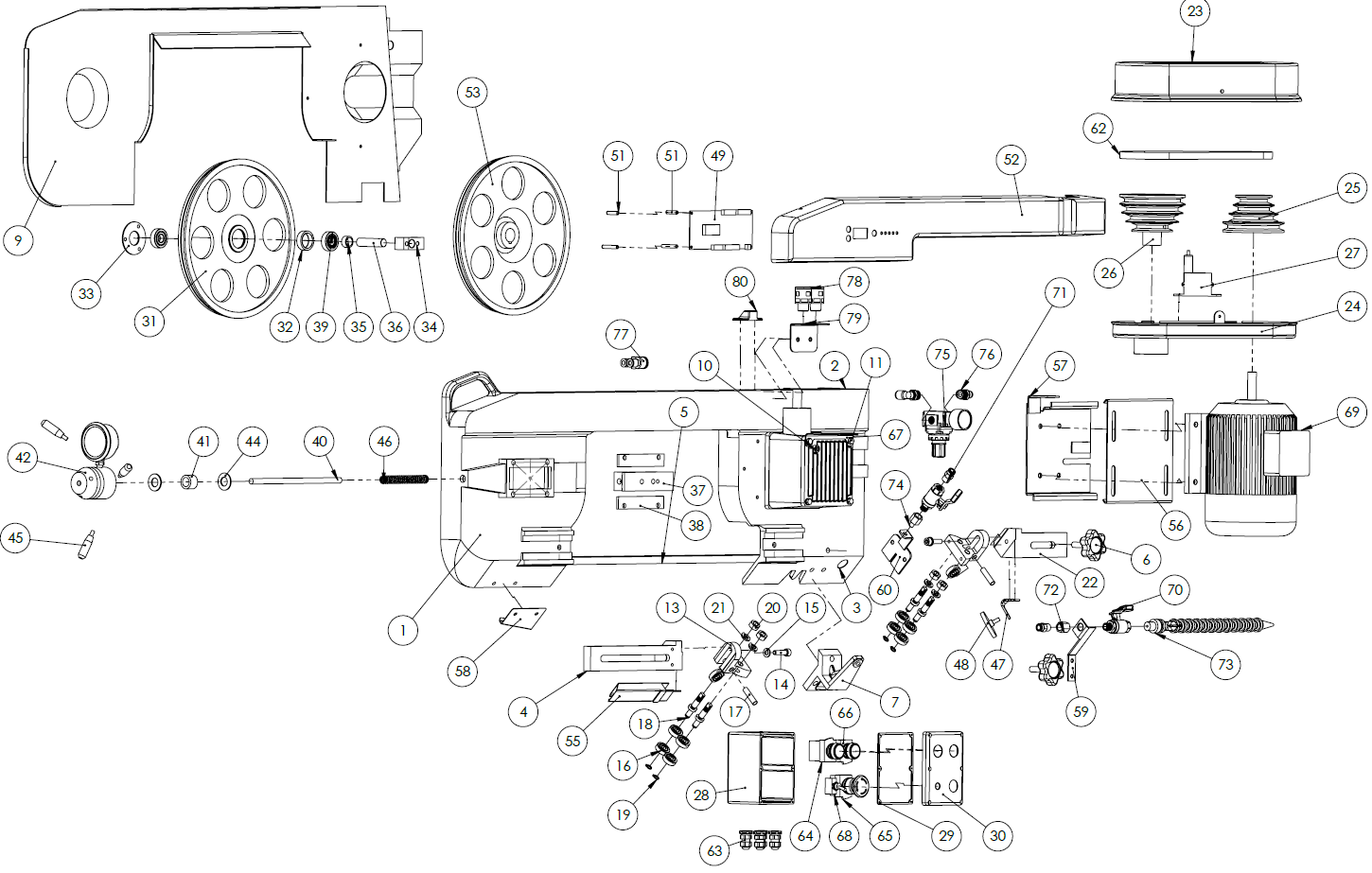

Head Casting Exploded View - AF50
Alternative Part Number
Saw Head Casting*
Rear Pivot Casting*
Saw Head Pivot Rod*
Front Blade Guide*
Saw Blade Section
Blade Guide Knob*
Hydraulic Pivot Arm Casting (PN 38052)
Blade Cover*
M8 × 10 Vent Screw
McMaster-Carr: 93235A351
Screw, Hex Head Cap, M06 × 1 - 20 mm
McMaster-Carr: 96364A201
11
Washer, Flat, M6
McMaster-Carr: 91455A120
12
Blade Guide Head*
13
Screw, Socket Head Cap, M08 × 1.25 - 30 mm
McMaster-Carr: 90348A036
14
Washer, Flat, M8
McMaster-Carr: 91166A270
15
Blade Guide Bearing (PN 38107)
16
Axle – Blade Bearing*
17
Blade Guide Cam (PN 38109)
18
Snap Ring
McMaster-Carr: 98541A116
19
Nut, Hex, M10
McMaster-Carr: 90695A041
20
Washer, Split Lock, M10
McMaster-Carr: 91202A242
21
Rear Blade Guide*
22
Belt Cover Assembly*
  • Belt Cover Top
23
  • Belt Cover Bottom
24
Motor Pulley*
25
Drive Wheel Pulley*
26
Pulley Door Switch (PN 38081)
27
(Control Box Assembly (PN 38132))
  • Control Box
28
  • Control Box Gasket
29
  • Control Box Top
30
Blade Wheel
(Sold as PN 51806 (Wheel Assembly includes #31-36, 38))
31
Bearing Spacer
32
Blade Wheel Bearing Cover
33
Wheel Axle Mount
34
Axle Spacer
35
Blade Wheel Axle
36
Blade Wheel Sliding Mount
37
Wheel Adjustment Guide*
38
Bearing (PN 38120)
39
Tension Rod*
40
Spacer (Pressure Gauge)*
41
Tension Handle Hub*
42
Pressure Gauge*
43
Belleville Washer 16 mm Shaft Diameter, 16.3 mm ID, 31.5 mm OD, 2 mm Thick*
44
Tension Handles*
45
Blade Tension Spring*
46
Angled Brush Bracket*
47
Blade Brush (PN 38033)
48
Control Board (PN 34924)
49
Control Board Long Spacer*
50
Control Board Short Spacer*
51
Molded Saw Cover (PN 35704)
52
Lower Blade Guide Wheel (PN 38143)
53
Upper Blade Guard*
54
Lower Motor Mount*
55
Upper Motor Mount*
56
Drip Guard*
57
Upper Coolant Bracket*
58
Lower Coolant Bracket*
59
Motor Belt (PN 38046)
60
Cord Grip, M16 × 1.5 (PN 31376)
61
Pushbutton, 22 mm, Green (PN 30463)
62
Emergency Stop Switch (PN 30462)
63
Pushbutton, 22 mm, Yellow (PN 38088)
64
Bracket – Clamp Pressure Regulator*
65
Coolant Switch*
66
AF50 Motor (PN 38084)
67
Ball Valve, 1/4 in. NPT Male and 1/4 in. NPT Female*
68
Push-to-Connect, 8 mm OD to 1/4 in. Male NPT*
69
Straight 1/4 in. Female Coupler*
70
1/4 in. Coolant Hose (PN 32833)
71
Reducer, 1/4 in. Female to M8 x 1.25 in.*
72
Pressure Regulator, 1/4 n. NPT × 1/4 in. NPT, 1/8 in. NPT Gauge Port, 7-125 psi, 150 psi (PN 39356)
73
3/8 in. tube OD to 3/8 in. NPT
74
Push-to-Connect, 12 mm to 8 mm Y Reducer
75
Flexible Plastic Conduit End*
76
Saw Head Conduit Mounting Bracket*
77
Top Pivot Mount – Lift Cylinder*
78
Gearbox (PN 51101)
