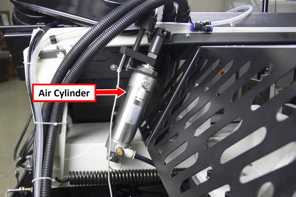

  1. On the back of the machine, identify the air cylinder, as shown in the following image.
Figure 1: Air cylinder on the back of the machine.

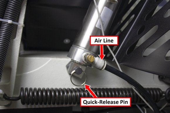

  1. Turn the air line valve, which allows you to access the air cylinder's quick-release pin, as shown in the following image.
Figure 2: Quick-release pin on the air cylinder.
  1. Pull the quick-release pin out of the air cylinder, and set it aside.
    The air cylinder hangs from the saw head.

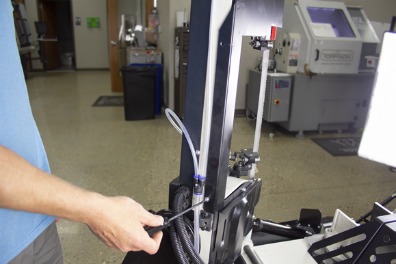

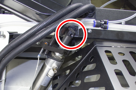

  2. Remove the bolt securing the air cylinder to the bandsaw with an 8 mm hex wrench.
Figure 3: Bolt on the air cylinder.

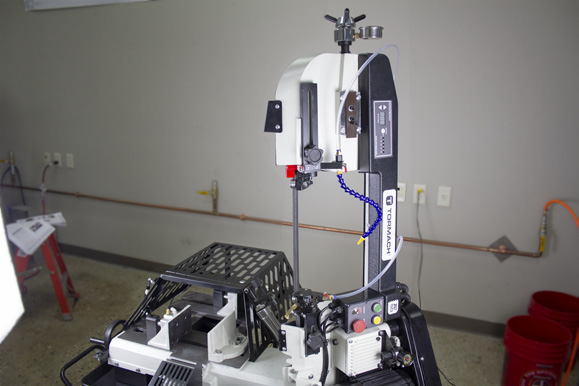

  2. Lift the saw head to the upright position, as shown in the following image.
Figure 4: Bandsaw head lifted upright.

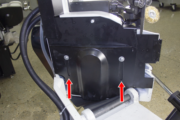

  1. Loosen the two screws on the bottom of the blade cover with a Phillips screwdriver, and then slide the blade cover up until it clears the base casting.
Figure 5: Blade cover.

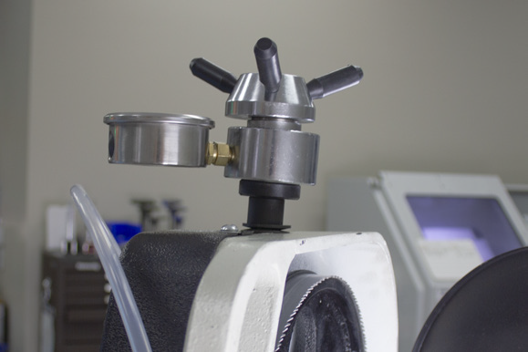

  1. Identify the tensioner on the top of the saw head.
Figure 8: Tensioner on top of the saw head.
  1. Loosen the tensioner to remove the tension on the blade.

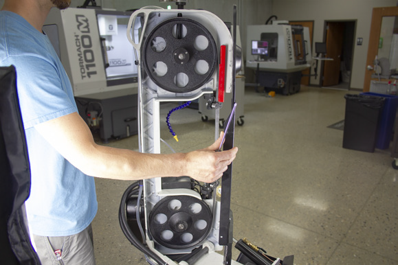

  2. Carefully remove the blade from the wheels.
  3. Put the new blade into the blade guides so that its teeth are pointing away from the blade guide's rollers, and so that its tooth direction is pointing toward the motor (from the blade guides).
  4. Use one hand to hold the blade in between the blade guides, and use the other hand to put the blade around the wheels.

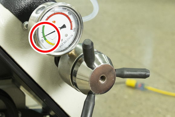

  5. Keep one hand on the blade to hold it in between the blade guides, and use the other hand to tighten the tensioner. Continue tightening until the needle on the blade tensioning gauge is aligned with the tip of the arrow, as shown in the following image.
Figure 9: Tensioner dial aligned with the tip of the arrow.

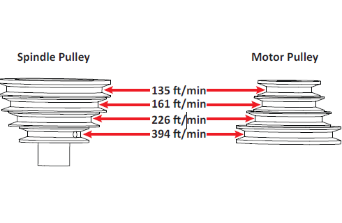

  5. Move the belt from one position on the pulleys to another.
    The following speed ranges are available:
  • 60 Hz: 135, 161, 226, 394 ft/min (41, 49, 69, 120 m/min)
Figure 10: Pulley speed configurations.
  • 50 Hz: 112, 135, 194, 322 ft/min (34, 41, 59, 98 m/min)
