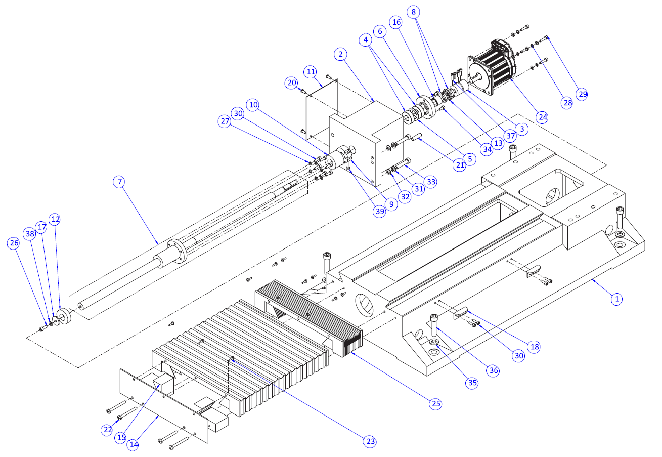

Y-Axis Assembly - 1100MX
Alternative Part Number
1100 Machine Base*
Y-Axis Motor Mount*
Ball Screw Coupler (PN 30362)
Bearing, Angular Contact, 7202B (P6), 15 mm × 35 mm × 11 mm (PN 30373)
X-Y Ball Screw Bearing Spacer (PN 30429)
X-Y Ball Screw Bearing Cover Plate*
Y-Axis Ball Screw Assembly, 1100 (PN 38800)
Bearing Nut, M14 × 1.5, Tab Lock (PN 30363)
Ball Screw End Stop Clamp (PN 30433)
Y-Axis Ball Screw Back Bumper, 1100 (PN 30446)
11
Motor Mount Cover Plate*
12
X-/Y-Axis Ball Screw End Bumper, 1100 (PN 30400)
13
Bearing Nut Lock Washer, M14 (PN 30364)
14
Y-Axis Cover Plate (PN 30406)
15
Y-Axis Bellows Spacer*
16
X-Y Bearing Nut Sleeve (PN 30444)
17
X-Y End Bumper Washer (PN 30401)
18
Y-Axis Limit Switch Flag (PN 30450)
19
Fitting, Oil, Tee (PN 32354)
20
Screw, Button Head Cap, M5 × 0.8 - 12, Stainless Steel
McMaster-Carr: 92095A210
21
Taper Pin, 8 mm × 30 mm (PN 30428)
22
Screw, Pan Head Machine, M6 × 1 - 40
McMaster-Carr: 92005A442
23
Screw, Pan Head Machine, M4 × 0.7 - 12
McMaster-Carr: 92005A222
12
24
Y-Axis Servo Motor, 1100 (PN 38701)
25
Y-Axis Way Cover, 1100 (PN 30578)
26
Screw, Socket Head Cap, M6 × 1 - 16
McMaster-Carr: 91290A321
27
Washer, Split Lock, M5
McMaster-Carr: 91111A124
28
Washer, Flat, M5
McMaster-Carr: 93475A240
29
McMaster-Carr: 91290A242
30
Screw, Socket Head Cap, M5 × 0.8 - 16
McMaster-Carr: 91290A232
31
Washer, Split Lock, M8
McMaster-Carr: 91202A238
32
Washer, Flat, M8
McMaster-Carr: 91166A270
33
Screw, Socket Head Cap, M8 × 1.25 - 40
McMaster-Carr: 91290A442
34
Screw, Socket Head Cap, M5 × 0.8 - 10
McMaster-Carr: 91290A224
35
Washer, Flat, M12
McMaster-Carr: 91166A290
36
Screw, Socket Head Cap, M12 × 1.75 - 50
McMaster-Carr: 91290A626
37
Screw, Socket Head Cap, M4 × 0.7 - 16
McMaster-Carr: 91290A154
38
M6 Lock Washer
McMaster-Carr: 91169A180
39
McMaster-Carr: 91290A252
