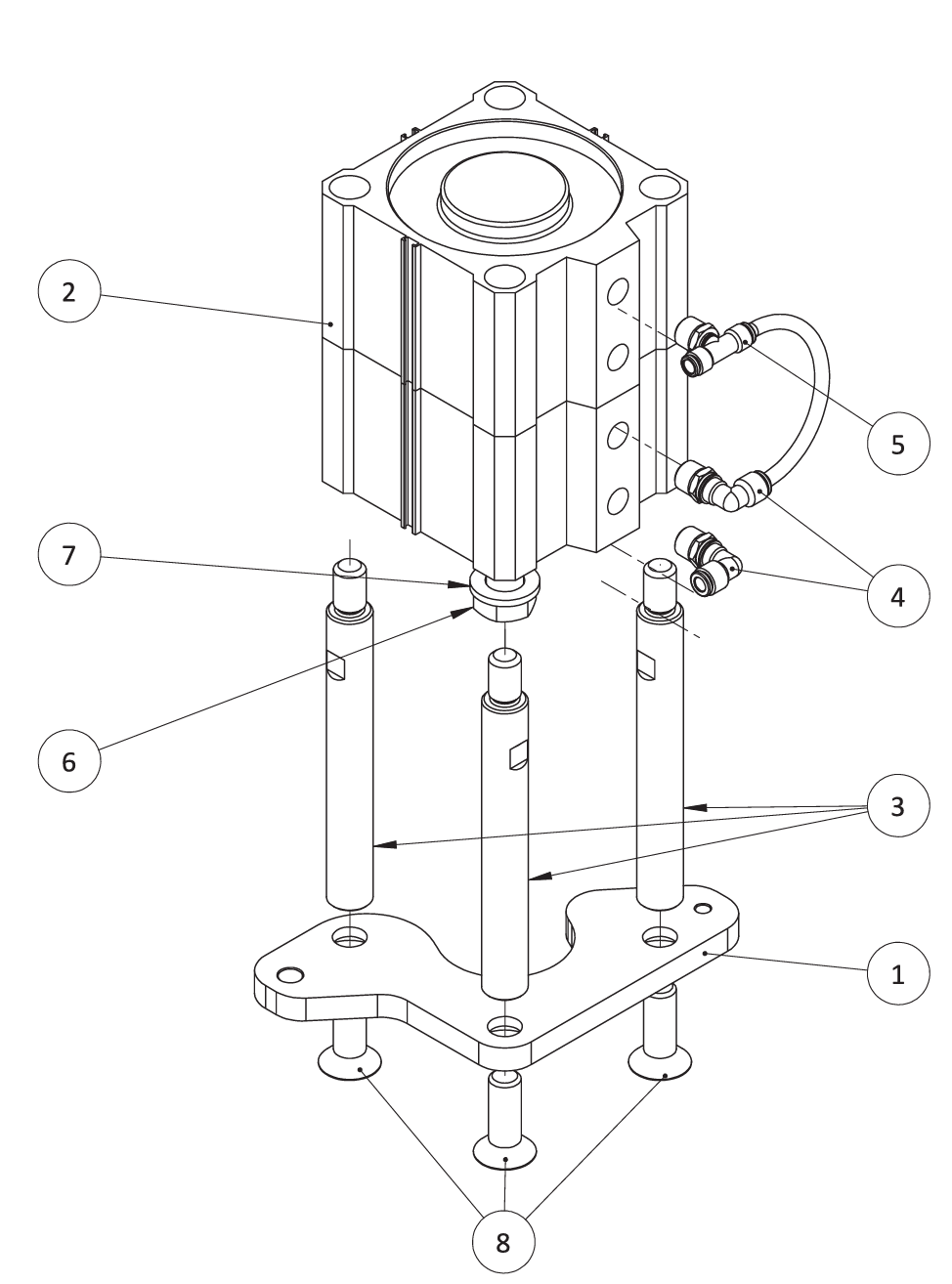

BT30 Power Drawbar Cylinder - 1100MX
Alternative Part Number
Power Drawbar Mount Plate (PN 37747)
Pneumatic Cylinder, Double Acting, 100 mm Bore, 25 mm Stroke, 2-Stack (PN 50450)
BT30 Power Drawbar Standoff, M14 × 2- 145 (PN 39710)
Fitting, Branch Tee, 1/4 NPT to 1/4 OD Tube (PN 31325)
Screw, Hex Head Cap, M16 × 1.5- 25 (PN 52949)
Washer, Flat, M16
McMaster-Carr: 91166A310
Screw, Flat-Head Cap, M14 × 2- 40
McMaster-Carr: 91294A414
Tube, 1/4 in. OD, Plastic (Red)- 125 mm (PN 38408)
