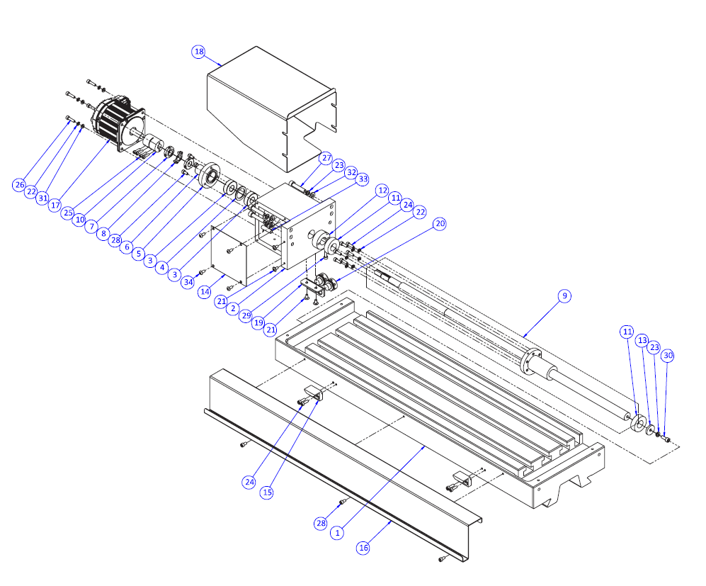

1100MX Knowledge Base
X-Axis Assembly - 1100MX
Descriptions
Alternative Part Numbers
1100 Machine Table (PN 30436)
X-Axis Motor Mount*
Bearing, Angular Contact, 7202B (P6), 15 mm × 35 mm × 11 mm (PN 30373)
X-Y Ball Screw Bearing Spacer (PN 30429)
X-Y Ball Screw Bearing Cover Plate*
X-Y Bearing Nut Sleeve (PN 30444)
Bearing Nut, M14 × 1.5, Tab Lock (PN 30363)
Bearing Nut Lock Washer, M14 (PN 30364)
X-Axis Ball Screw Assembly (PN 30483)
Ball Screw Coupler (PN 30362)
11
X-/Y-Axis Ball Screw End Bumper, 1100 (PN 30400)
12
Ball Screw End Stop Clamp (PN 30433)
13
X-Y End Bumper Washer (PN 30401)
14
1100 X-Axis Motor Mount Cover Plate (PN 37954)
15
X-Axis Limit Switch Flag (PN 31208)
16
Front Drip Guard, 860 mm (PN 50400)
17
X-Axis Servo Motor, 1100 (PN 38404)
18
X-Axis Motor Cover, 1100MX (PN 39276)
19
Flex Conduit Bracket, X-Axis (PN 39712)
20
Flex Conduit Fitting, 13 mm ID × 16 mm OD (PN 30628)
21
McMaster-Carr: 97654A376
22
Washer, Split Lock, M5
23
M6 Lock Washer
McMaster-Carr: 91169A180
24
Screw, Socket Head Cap, M5 × 0.8 - 16
McMaster-Carr: 91290A232
25
Screw, Socket Head Cap, M4 × 0.7 - 16
McMaster-Carr: 91290A154
26
McMaster-Carr: 91290A242
27
Screw, Socket Head Cap, M8 × 1.25 - 40
McMaster-Carr: 91290A442
28
Screw, Socket Head Cap, M5 × 0.8 - 10
McMaster-Carr: 91290A224
29
McMaster-Carr: 91760A248
30
Screw, Socket Head Cap, M6 × 1 - 16
McMaster-Carr: 91290A321
31
Washer, Flat, M5
McMaster-Carr: 93475A240
32
Washer, Flat, M8
McMaster-Carr: 91166A270
33
Taper Pin, 8 mm × 30 mm (PN 30428)
34
Screw, Button Head Cap, M5 × 0.8 - 12, Stainless Steel
McMaster-Carr: 92095A210
