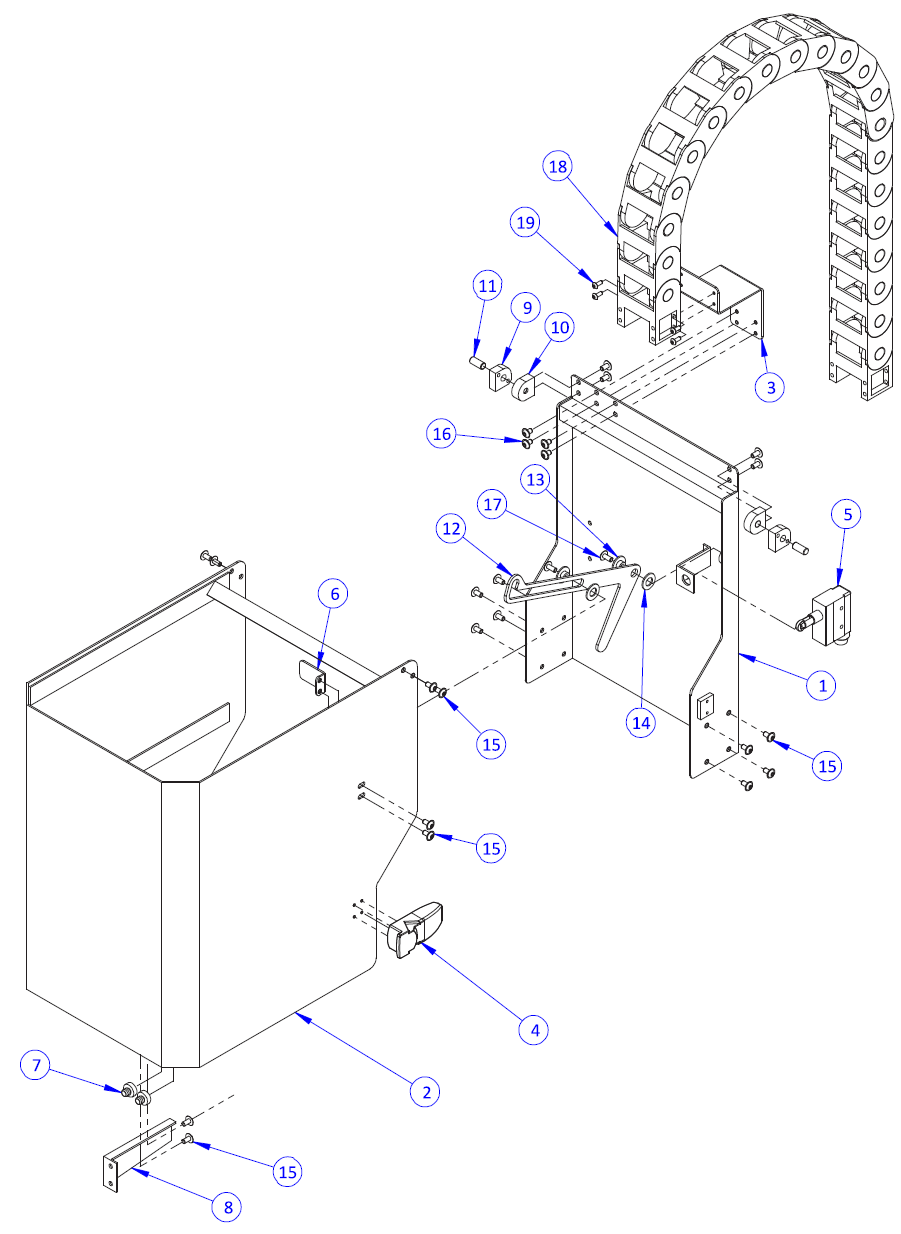

1100MX Knowledge Base
Spindle Motor Cover - 1100MX
Alternative Part Number
1100 Rear Spindle Cover*
1100 Front Spindle Cover (PN 37692)
1100 Upper Drag Chain Mount*
Spindle Motor Cover Latch*
Spindle Door Switch (PN 30461)
Cover Dog*
Bumper, Push-In, 16 mm × 8.5 mm, Rubber*
Spindle Door Latch Guard*
Cover Hinge*
Cover Pivot*
11
Cover Axel*
12
Spindle Motor Cover Lid Support*
13
Lid Support Bushing (PN 38447)
14
Lid Support Washer (PN 38448)
15
McMaster-Carr: 97654A376
20
16
Screw, Button Head Cap (Flanged), M5 × 0.8 - 8
McMaster-Carr: 90909A721
17
Screw, Button Head Cap (Flanged), M5 × 0.8 - 12
McMaster-Carr: 97654A377
18
1100M Drag Chain (PN 38464)
19
Screw, Button Head Cap, M4 × 0.7 - 10 mm
McMaster-Carr: 94500A227
