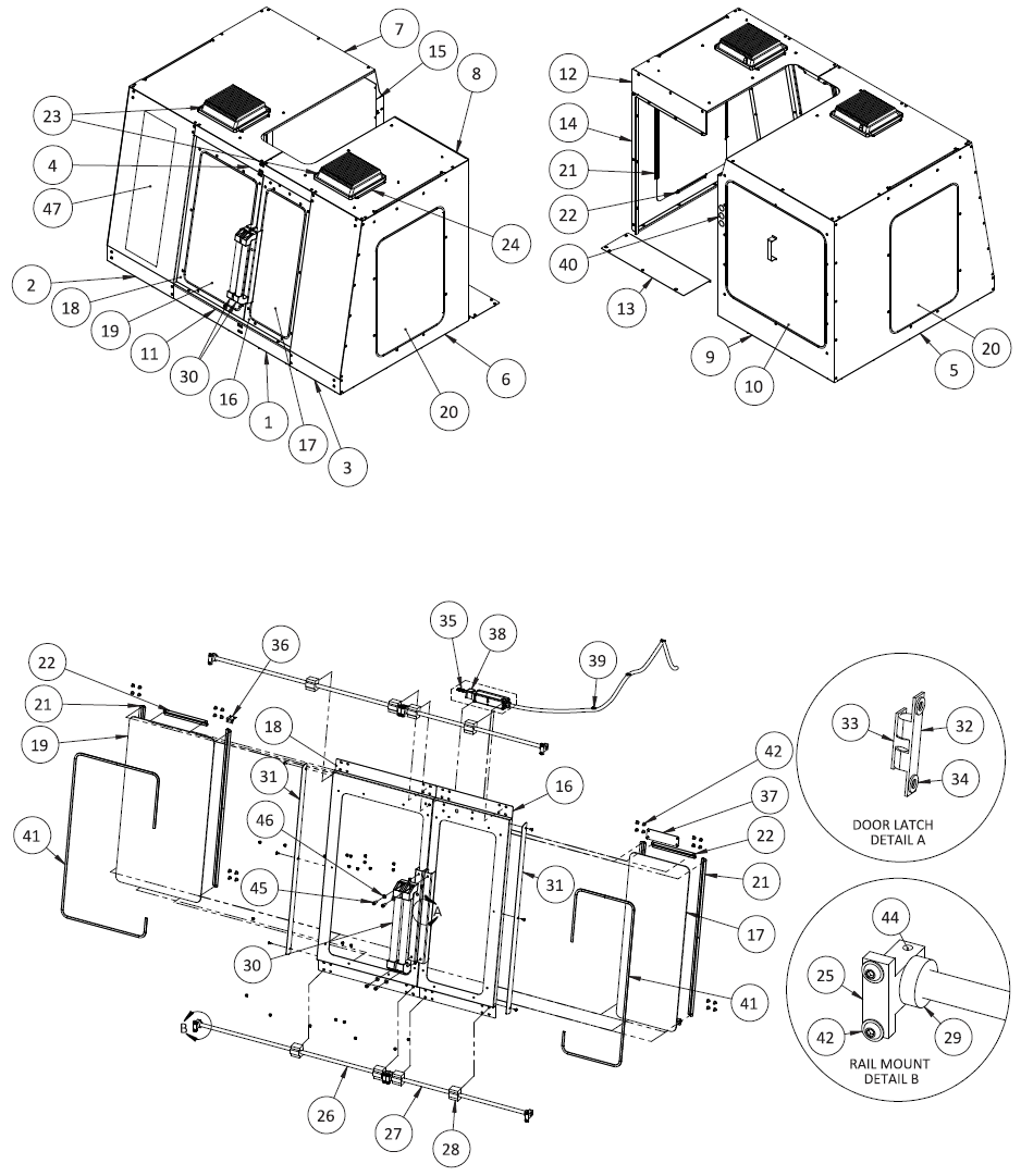

Enclosure - 1100MX
Alternative Part Number
Enclosure Panel, 1100, Lower Front (PN 37630)
Enclosure Panel, 1100MX, Left Front*
Enclosure Panel, 1100MX, Right Front*
Enclosure Panel, 1100, Upper Front*
Enclosure Panel, 1100MX, Left Side (PN 39548)
Enclosure Panel, 1100MX, Right Side (PN 39549)
Enclosure Panel, 1100, Left Top (PN 37636)
Enclosure Panel, 1100, Right Top (PN 37637)
Enclosure Panel, 1100, Left Rear (PN 37638)
Enclosure Panel, 1100, ATC (PN 37645)
11
Chip Tray Rail, 1100 (PN 37657)
12
Enclosure Panel, 1100, Right Rear (PN 37639)
13
Enclosure Panel, 1100, Splash Shield*
14
Enclosure Panel, 1100, Splice Plate (PN 38695)
15
Enclosure Panel, 1100, Column Splice (PN 37663)
16
Enclosure Door, 1100, Right (PN 37640)
17
Window, 1100, Right Door (PN 37650)
18
Enclosure Door, 1100, Left*
19
Window, 1100, Left Door (PN 37649)
20
Window, 1100, Side (PN 37648)
21
Enclosure Window Retainer, 1100, Vertical (PN 37646)
22
Enclosure Window Retainer, 1100, Horizontal*
23
LED Floodlight, 50 W (PN 37341)
24
Flood Light Retainer (PN 38222)
25
Linear Rail Mount (PN 37622)
26
Left Door Rail, 1100 (PN 37642)
27
Right Door Rail, 1100 (PN 37643)
28
Linear Bearing (PN 37610)
29
Door Bumper (PN 38357)
30
Handle, 400 mm (PN 37611)
31
Door Seal*
32
Enclosure Ball Latch, Female (PN 38482)
33
Enclosure Ball Latch, Male (PN 38483)
34
Washer, Flat, M5, Stainless Steel
McMaster-Carr: 93475A240
35
Nut Bar (PN 37585)
36
Switch Key Bracket (PN 37586)
37
Locking Door Switch Installation/Cover Plate (PN 38272)
38
Door Lock Switch Kit (PN 38283)
39
40
Round Plug, 32 mm (PN 37598)
41
Sealing Strip, Rubber (PN 38356)
21
42
McMaster-Carr: 97654A380
76
43
McMaster-Carr: 97654A376
151
44
McMaster-Carr: 91290A242
45
Screw, Socket Head Cap, M8 × 1.25 - 22
McMaster-Carr: 91290A428
46
Washer, Flat, M8
McMaster-Carr: 91166A270
47
Decal, Enclosure, 1100MX, Front Left Panel (PN 39032)
