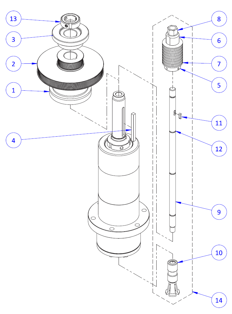

Spindle Cartridge - 1100MX
Magnetic Encoder, Spindle Ring (PN 38298)
Spindle Pulley, 1100MX*
Flange, BT30 Power Drawbar*
Key, Straight, 6 mm × 6 mm - 64 mm*
Disc Spring Guide, MX BT30 Spindle (PN 39597)
Disc Spring Compression Nut, MX BT30 Spindle (PN 39598)
Disc Spring, 40 mm × 20.4 mm × 2.0 mm × 3.10 mm (PN 39689)
16
Nut, Jam, M12 × 1.75 (PN 39602)
Drawbar, BT30 Spindle (PN 39574)
Clamping Unit, BT30 (PN 39690)
11
Key, Straight, 4 mm × 4 mm - 12 mm*
12
O-Ring, 9 mm × 12 mm × 1.5 mm, Buna-N (PN 39584)
13
Nut, Bearing, M25 × 1.5*
14
Drawbar Core Assembly, MX BT30 Spindle (PN 39599)
