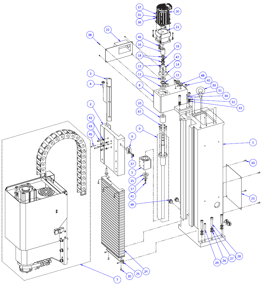

1100MX Knowledge Base
Z-Axis Assembly - 1100MX
Alternative Part Number
1100 Column*
1100 Z-Axis Saddle*
Z-Axis Gib (PN 30384)
Z-Axis Gib Screw (PN 30385)
Z-Axis Ball Nut Carrier (PN 30387)
Z-Axis Limit Switch Flag*
1100MX Spindle Head Assembly*
Z-Axis Motor Mount*
Z-Axis Ball Screw Assembly, 1100 (PN 30382)
Z-axis Ball Screw Upper Bumper, 1100 (PN 30375)
11
Bearing, Angular Contact, 7202B (P6), 15 mm × 35 mm × 11 mm (PN 30373)
12
Bearing Spacer (PN 30374)
13
Bearing Nut Sleeve (PN 30371)
14
Z-Axis Bearing Retainer (PN 30372)
15
Z-Axis Ball Screw Lower Bumper, 1100 (PN 30388)
16
Ball Screw Coupler (PN 30362)
17
Lower Bumper Washer*
18
Bearing Nut, M14 × 1.5, Tab Lock (PN 30363)
19
Bearing Nut Lock Washer, M14 (PN 30364)
20
Z-Axis Servo Motor, 1100 (PN 38405)
21
Brake, NEMA 34 Inline, 24 Vdc (PN 38399)
22
Z-Axis Drag Chain Box*
23
Column Cover Plate*
24
Z-axis Way Cover (PN 30378)
25
Z-Axis Way Cover Bracket*
26
Washer, Flat, M12
McMaster-Carr: 91166A290
27
Washer, Split Lock, M12
McMaster-Carr: 91202A246
28
Screw, Socket Head Cap, M12 × 1.75 - 60
McMaster-Carr: 91290A234
29
Taper Pin, 10 mm - 55 mm (PN 30381)
30
Screw, Button Head Cap, M5 × 0.8 - 12, Stainless Steel
McMaster-Carr: 92095A210
11
31
Taper Pin, 6 - 30*
32
Washer, Split Lock, M10
33
Washer, Flat, M10
McMaster-Carr: 93475A280
34
Screw, Socket Head Cap, M10 × 1.5 - 40
McMaster-Carr: 91290A528
35
Washer, Split Lock, M5
McMaster-Carr: 91111A124
36
Washer, Flat, M5
McMaster-Carr: 93475A240
37
McMaster-Carr: 91290A252
38
Screw, Button Head Cap (Flanged) M3 × 0.5 - 6
McMaster-Carr: 97654A674
39
Eye Bolt, M16 × 2 - 28
40
Screw, Flat Point Set, M16 × 2 - 12
McMaster-Carr: 93245A457
41
Screw, Socket Head Cap, M5 × 0.8 - 10
McMaster-Carr: 91290A224
42
M6 Lock Washer
McMaster-Carr: 91169A180
43
Screw, Socket Head Cap, M6 × 1 - 30
McMaster-Carr: 91290A332
44
Nut, Hex, M5 × 0.8
McMaster-Carr: 90591A260
45
Taper Pin, 6 - 35*
46
Screw, Socket Head Cap, M4 × 0.7 - 16
McMaster-Carr: 91290A154
47
McMaster-Carr: 91290A242
48
Flex Conduit Fitting, 13 mm ID × 16 mm OD (PN 30628)
