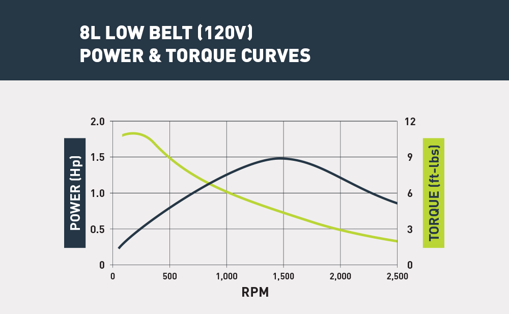

Shown below are the results of motor testing done on the 8L Spindle.
120V High Belt
120V Low Belt
