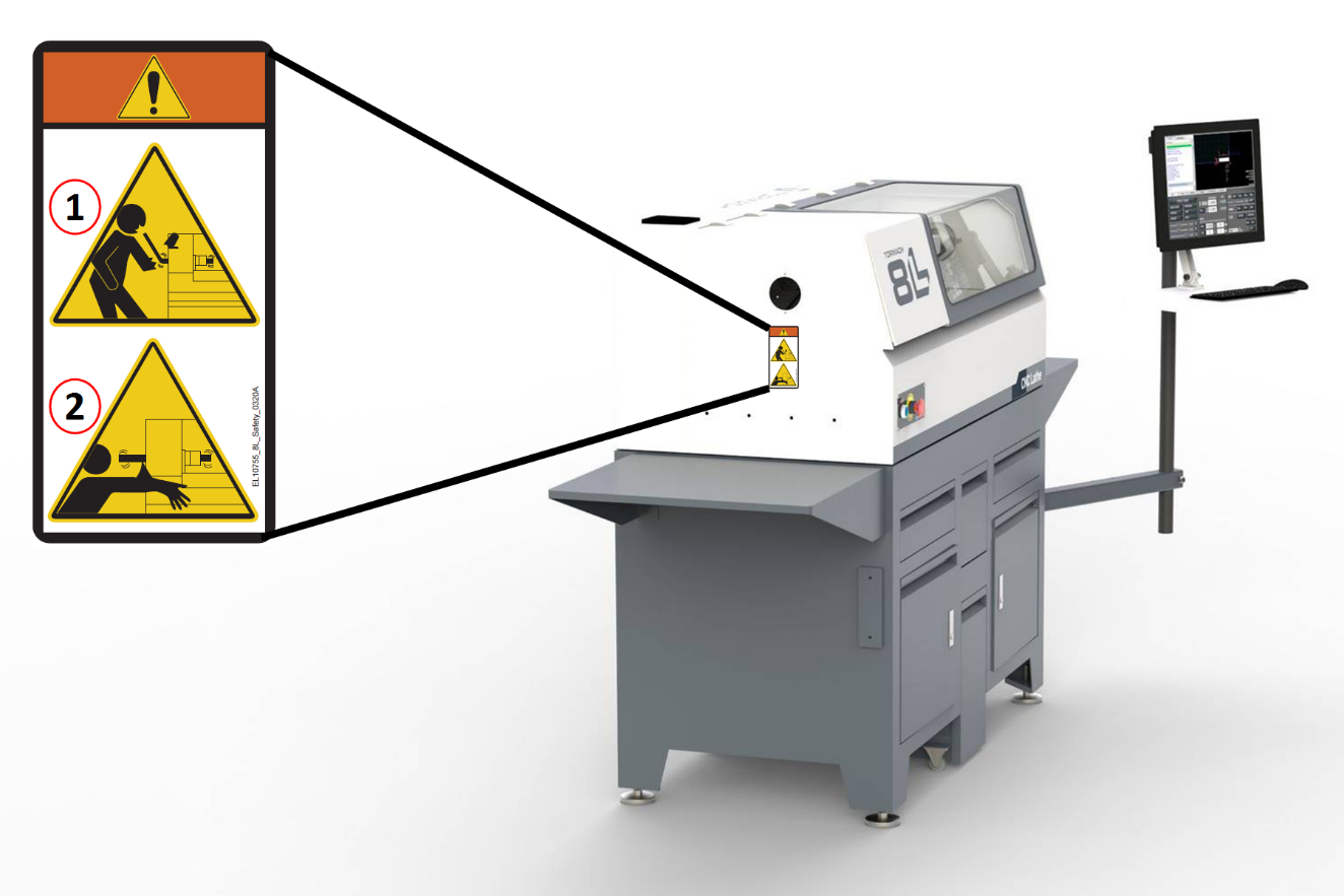

  1. WARNING! Bar Whip Hazard. Unsupported bar stock that extends from the rear of the drawtube can bend during operation, causing it to whip unpredictably. Never extend an unsupported bar stock past the left end of the spindle bore. If you do, there's a risk of serious injury or death.
  2. WARNING! Entanglement / Entrapment Hazard. The machine operates under automatic control — it can start at any time and crush, cut, entangle, or pinch body parts. Always keep clear of positions on the machine where unexpected or unintended machine motion could cause harm. Before operating this machine in any way, you must verify that all operators know the location of the machine's Emergency Stop button.

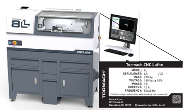

Serial Number Plate
