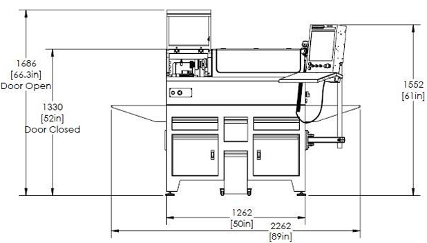

Space Requirements
The area must meet the following space requirements. Allow more space to access the rear of the machine for maintenance and repairs.
  • Machine Size 42" × 36" (1.1 m × 0.9 m)
  • Machine Height 72" (1.8 m)
Figure 1: Dimensions of the machine itself, as viewed from the front.
