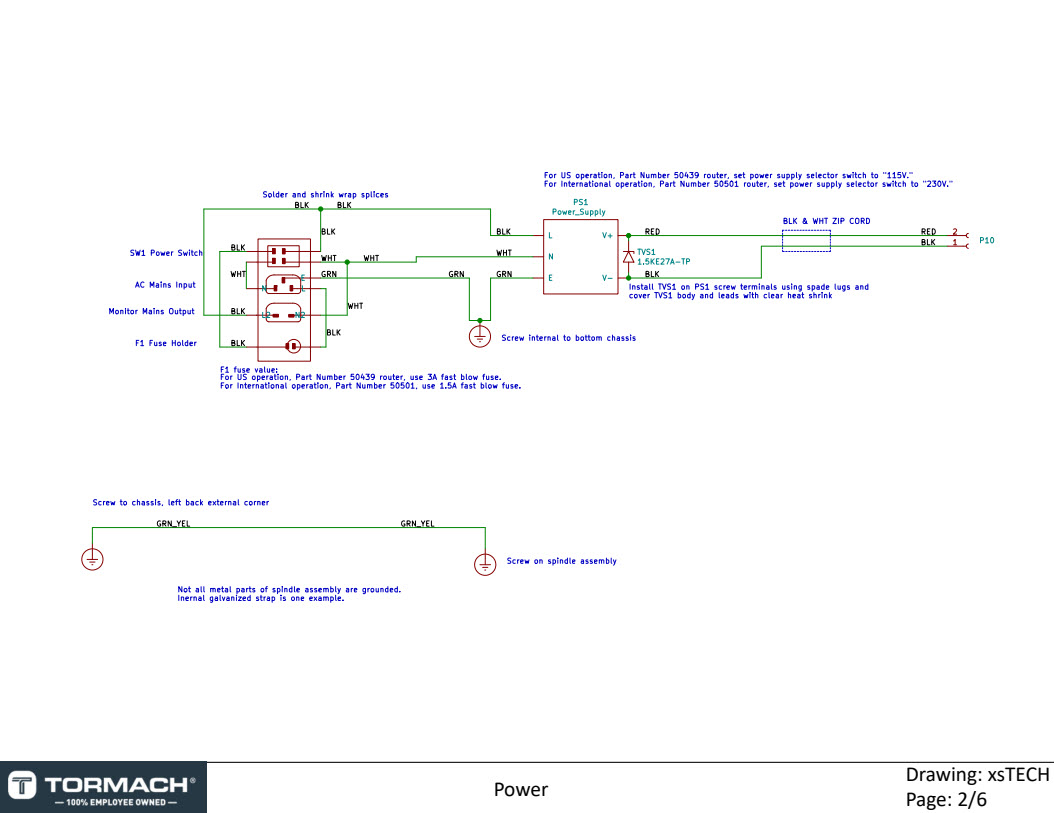

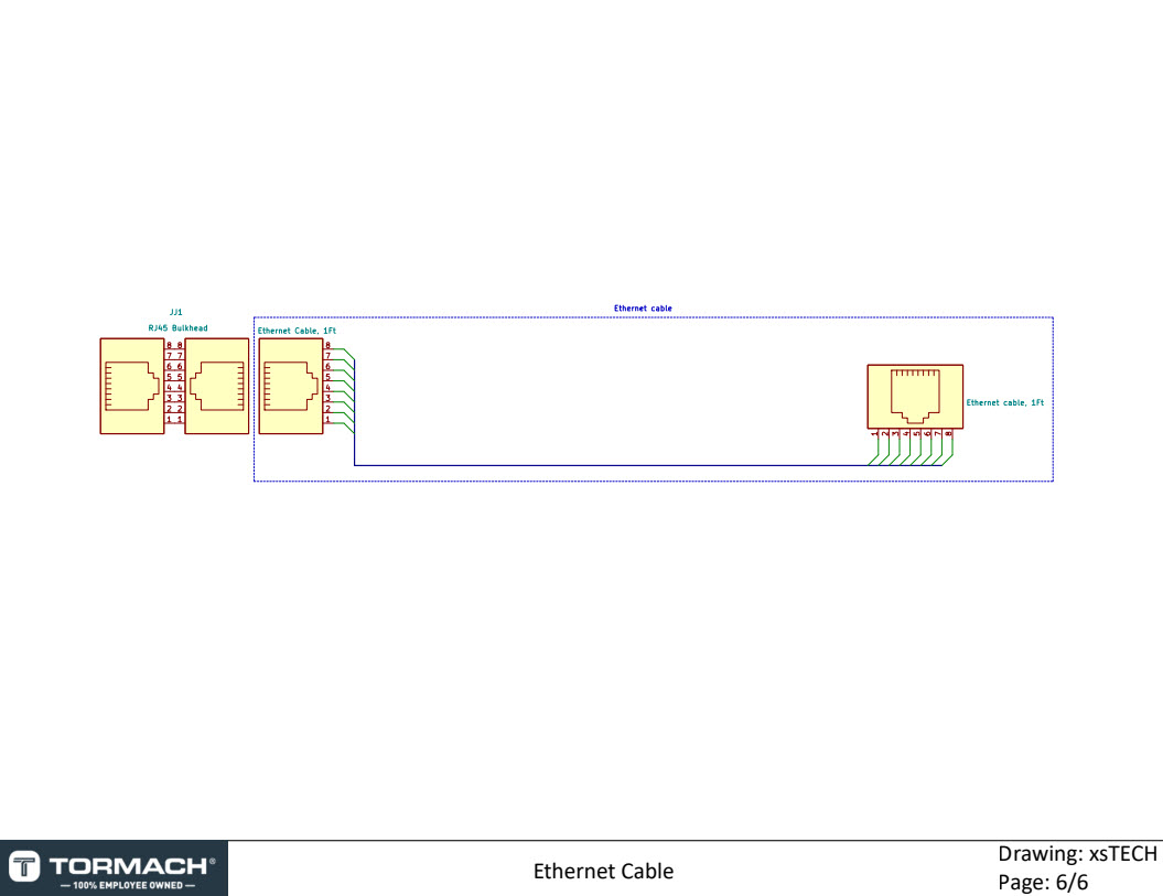

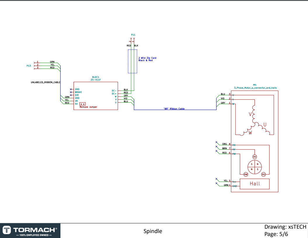

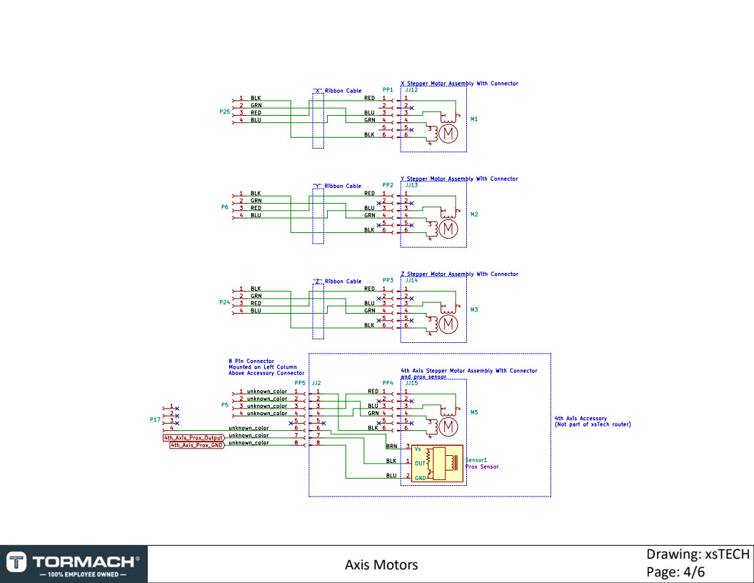

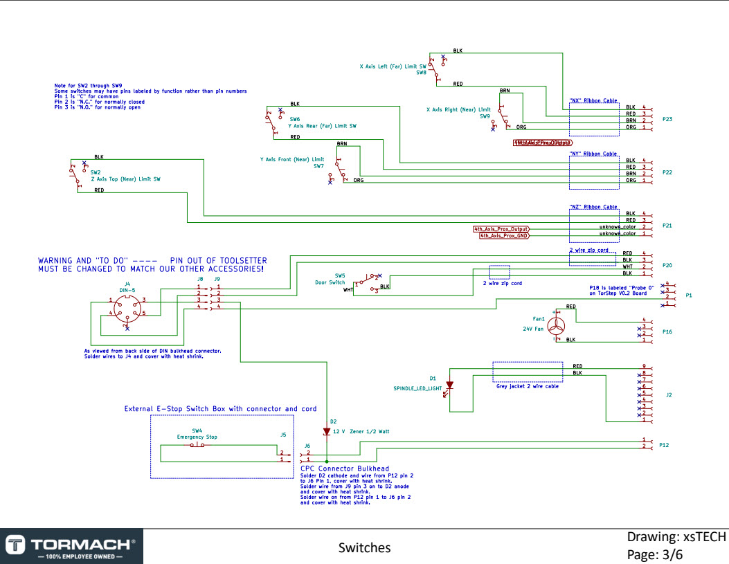

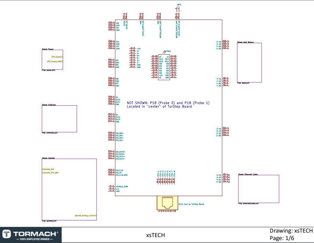

xsTECH Router Wiring Diagram
To View a PDF:
xsTECH Router Wiring Diagram.pdf
